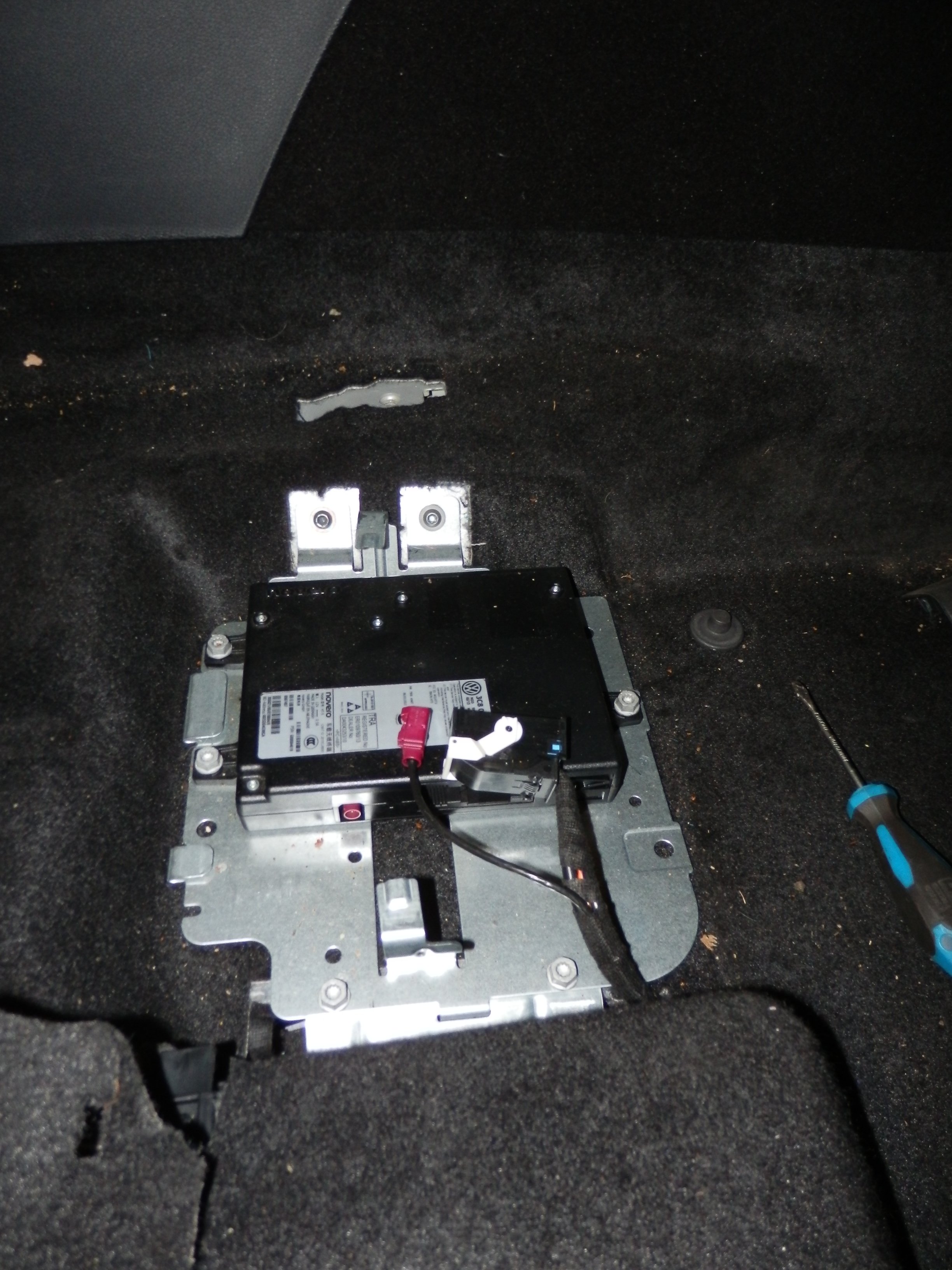

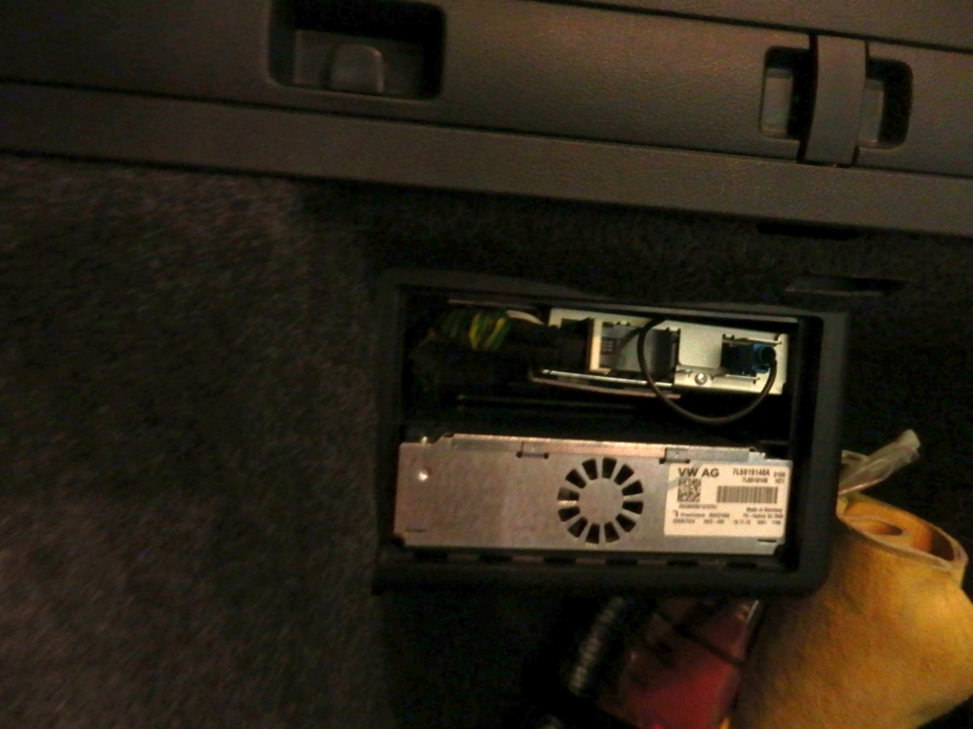

My plan was to get the old TV-Tuner to Columbus cable out of the existing cable loom complete and replace it with the new Columbus to RVC STG high to TV-Tuner cable.

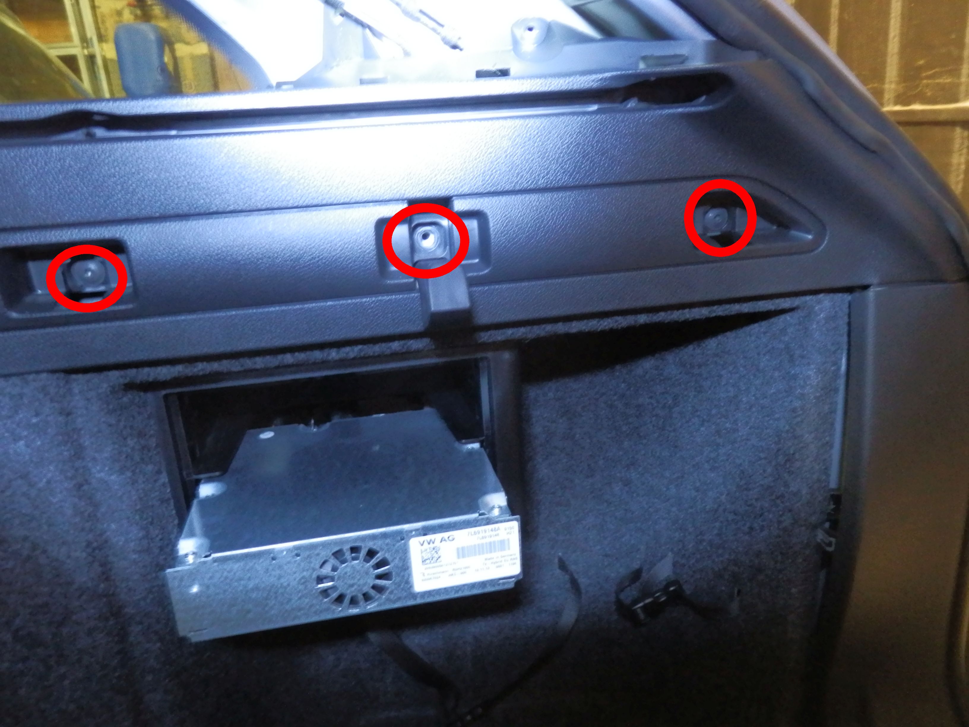

I started by removing the trim in the boot, boot cover, shelf trim, D-pillar trim and rear seat to door trim. Remove the hooks in the boot and the torx screws underneath. Hooks need to be pushed in and lifted up. Remove the trim on the D-pillar - just pull. It is held by 4 clips. Then remove the 2 torx holding the shelf. Then remove the cushion trim between rear seat and door - look in Lutz's video. You need to remove to M10 bolt under the rear seat for this. Then another torx is revealed for the shelf.PC291948.thumb.JPG.92a0ee8f4f584eeeb012bf5b2b72a9ac.JPG
Then you will start to see the existing cable loom to the TV-Tuner. Next you need to lift the plastic trim in the rear door and the trim in the front door up to the foot well and the right hand cover on the dash. For some of this it useful to have special trim removal tools rather than brute screw drivers. I took the driver's seat off because the loom runs right underneath the seat and the high cable loom contains 8 wires and a coax. I did not just want to push them somewhere under the carpet.
More pictures in the next post as I hit the upload limit. You can see that Skoda did actually do a very neat job when they laid the cable. The sockets are for the electric seat. When you rip the plastic trims up just take a minute and check whether all the metal V-shape clips have come up with them. Sometimes they get stuck in their repective holes and need to be peeled out.

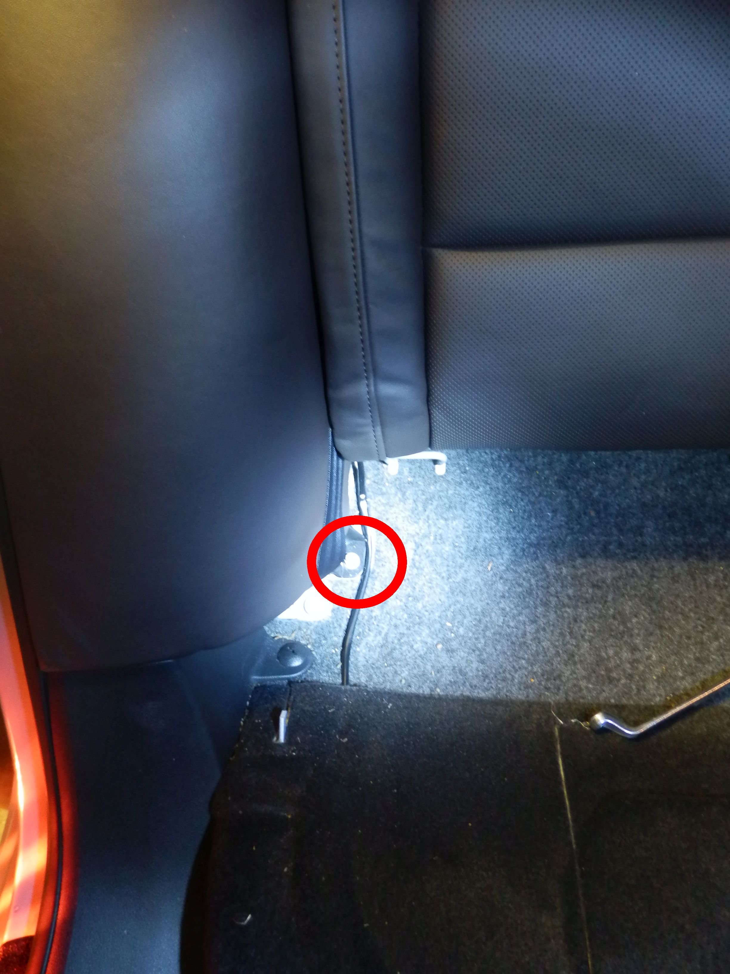

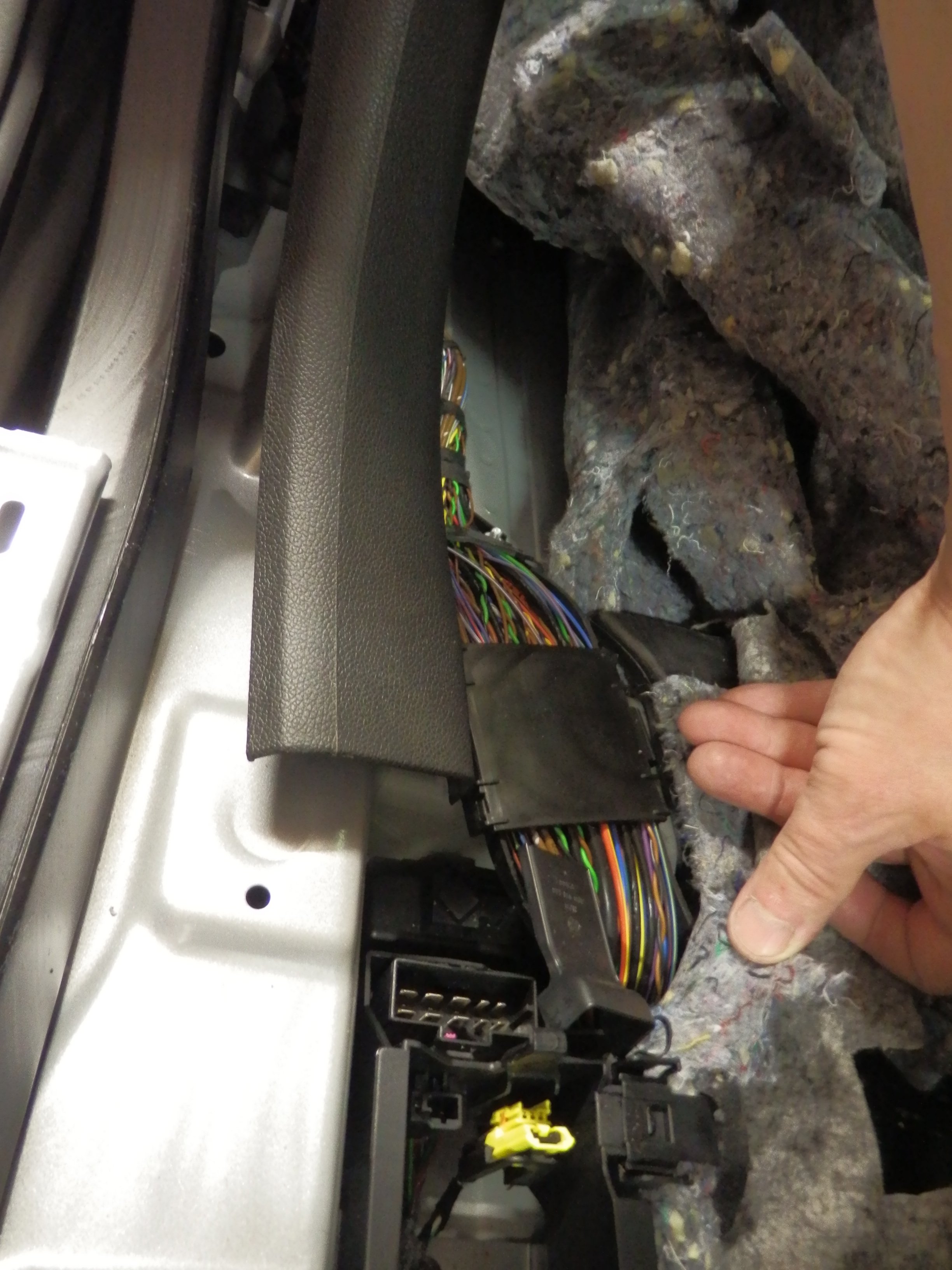

  • I took the driver's seat off to get to the cable loom. The seat is held with 4 large Torx. To get to the loom you have to remove the phone controller and unclip the driver's seat electrics.
  • Calibration done. It had to be done with the calibration grid, otherwise the RVC STG would simply return an error message. I printed the grid as a poster and pieced the sheets together.
  • The handle will fit without the bracket. It has small plastic "hooks". Make sure you rust proof the cutout in the tailgate and then use a thin film of silicone.

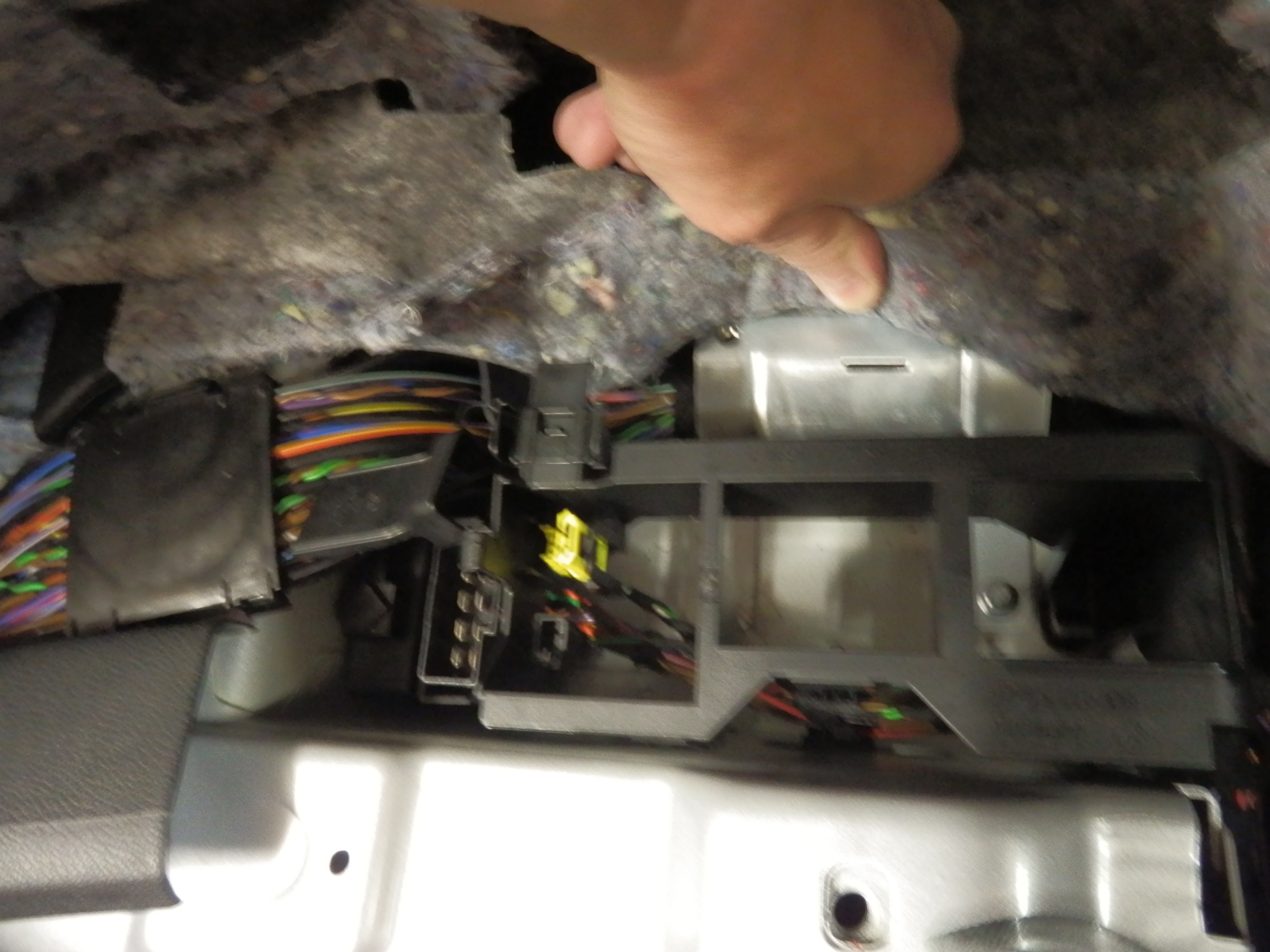

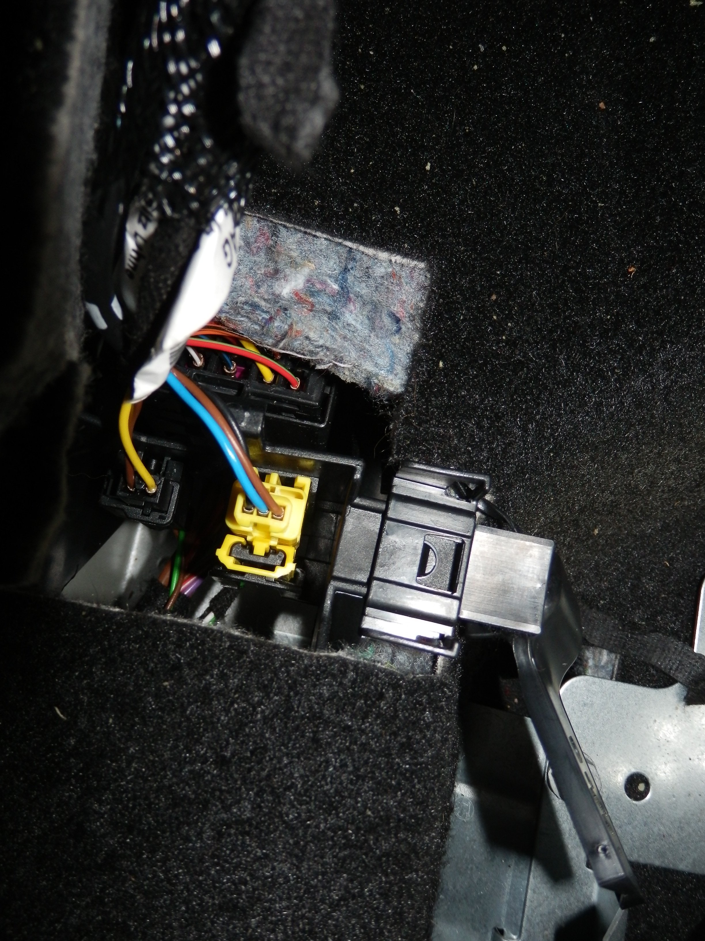

I did not manage to peel the old cable out of the wiring loom completely because the loom disappears behind the dashboard through what looks like a bulkhead trim. So I cut the old cable - 1x coax, Can H, Can L, 12v and earth in the driver's foot well with enough length to rejoin the new one onto it.

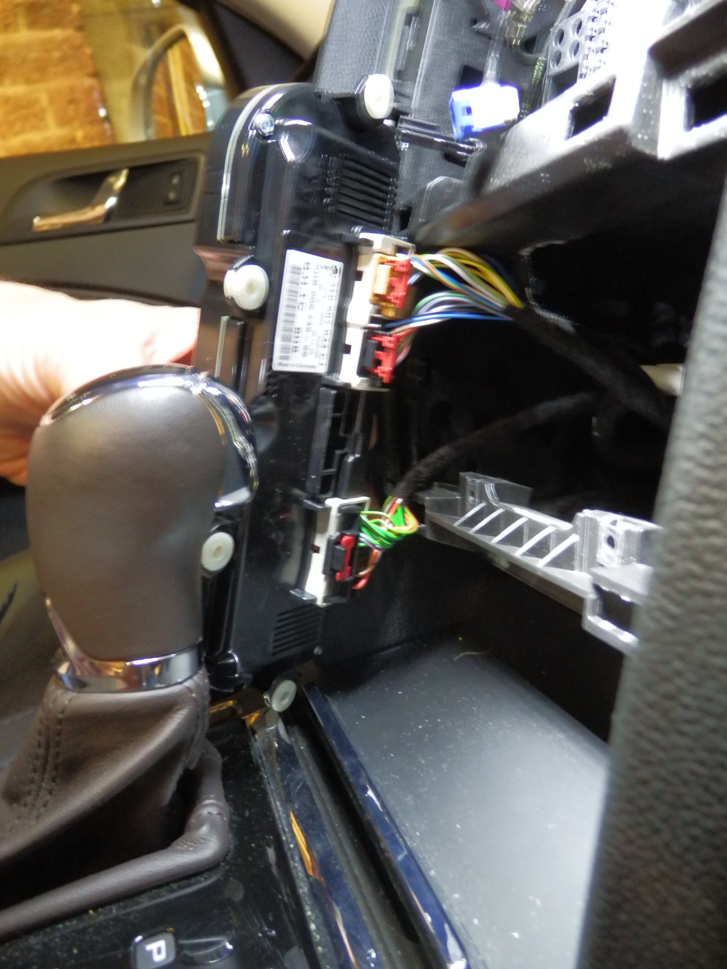

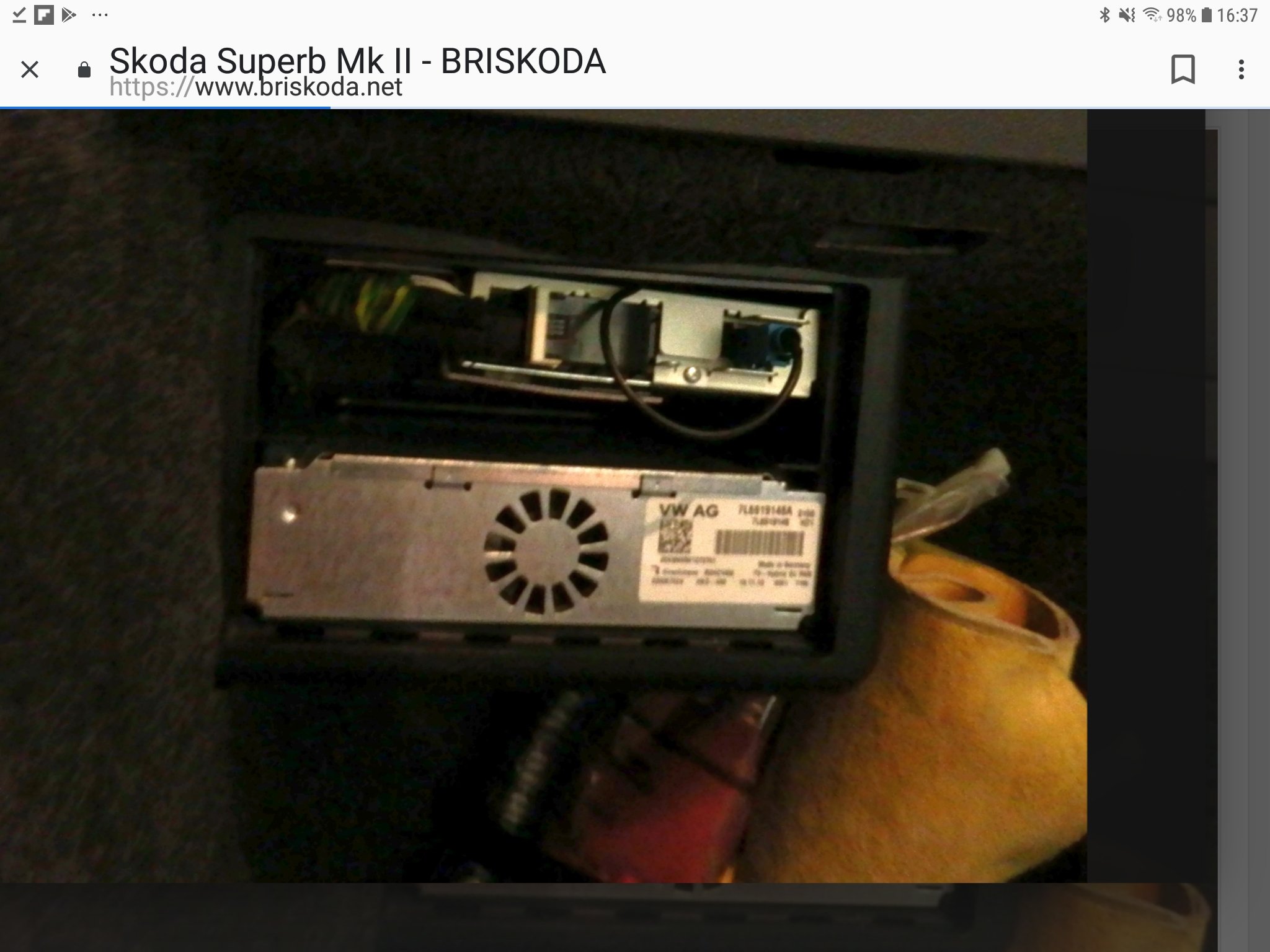

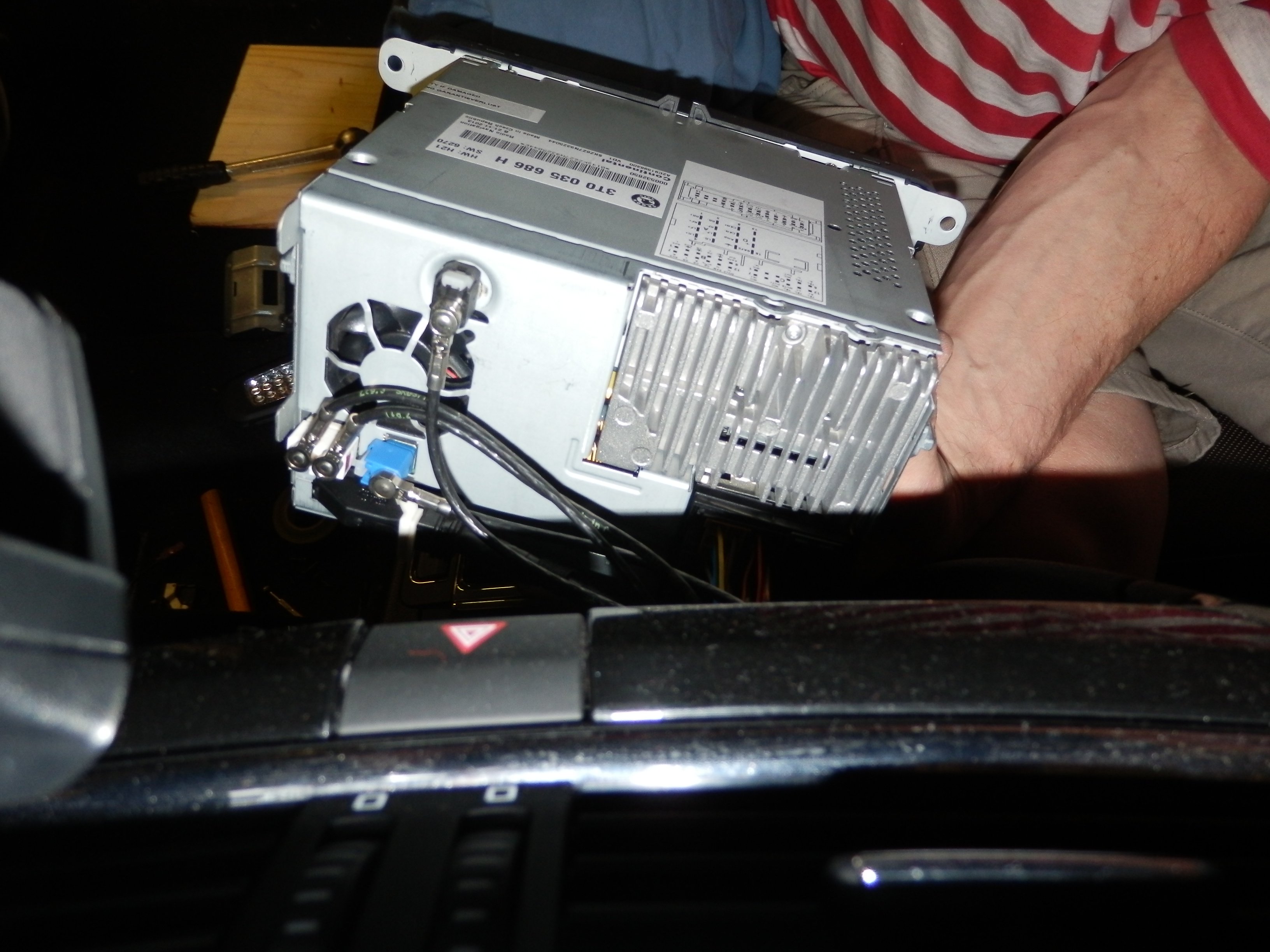

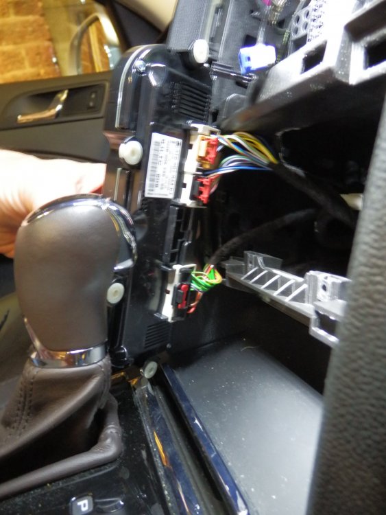

I now went to the Columbus and removed the trim around it, 4 Torx scres holding it and I also took the controls for the air conditioning out to have more room.

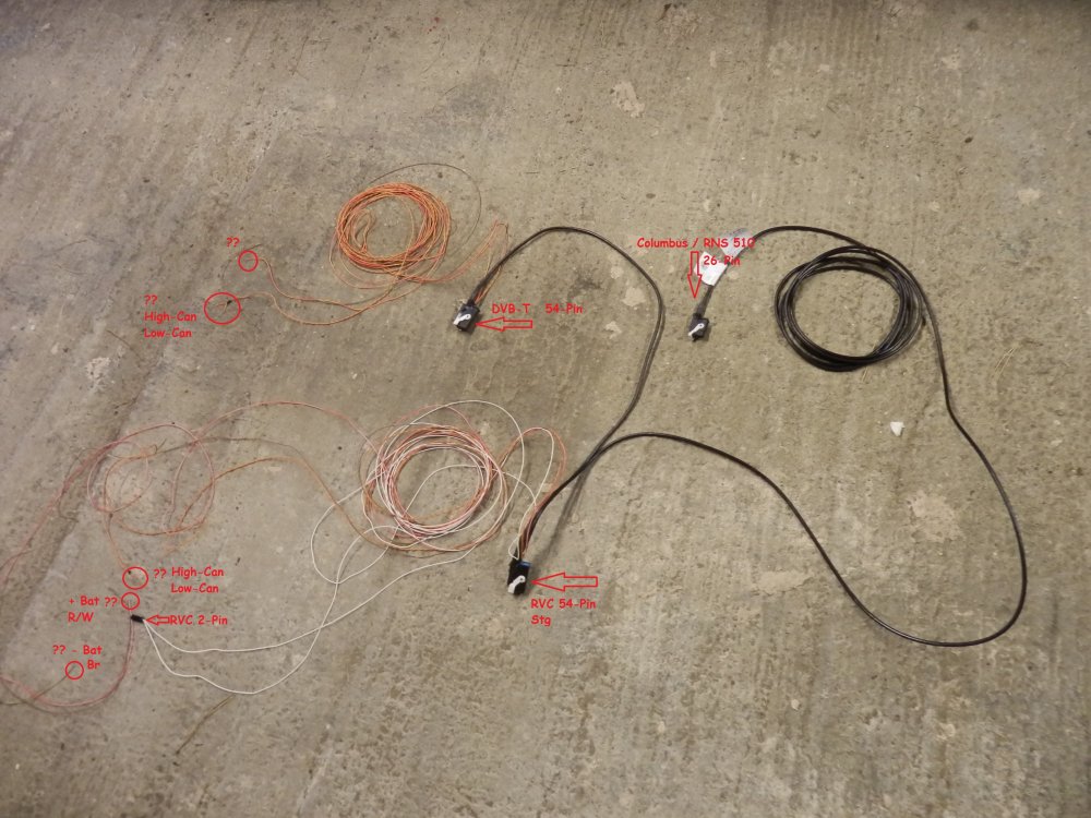

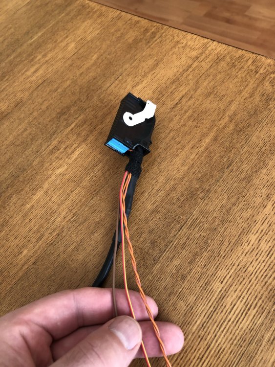

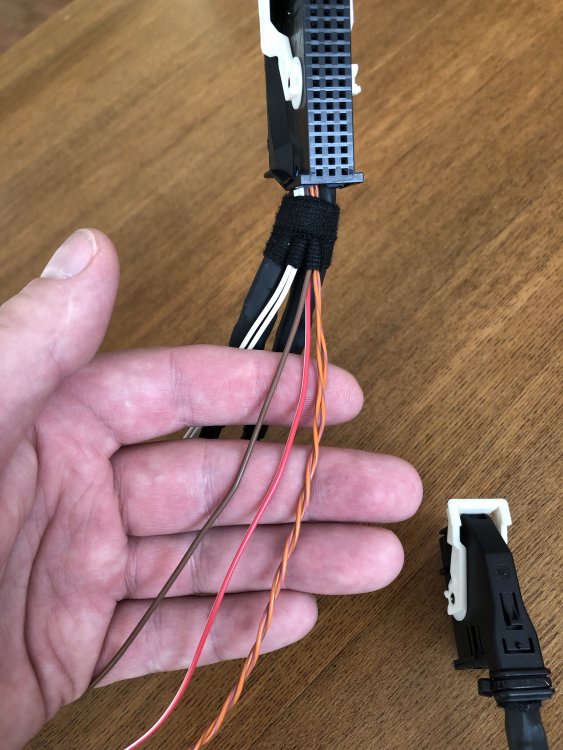

Now I prepared the new loom. I taped the wires to each controller together to have them neat for easy routing. The white 2-core has to go into the tailgate together with the Fakra coax cable.

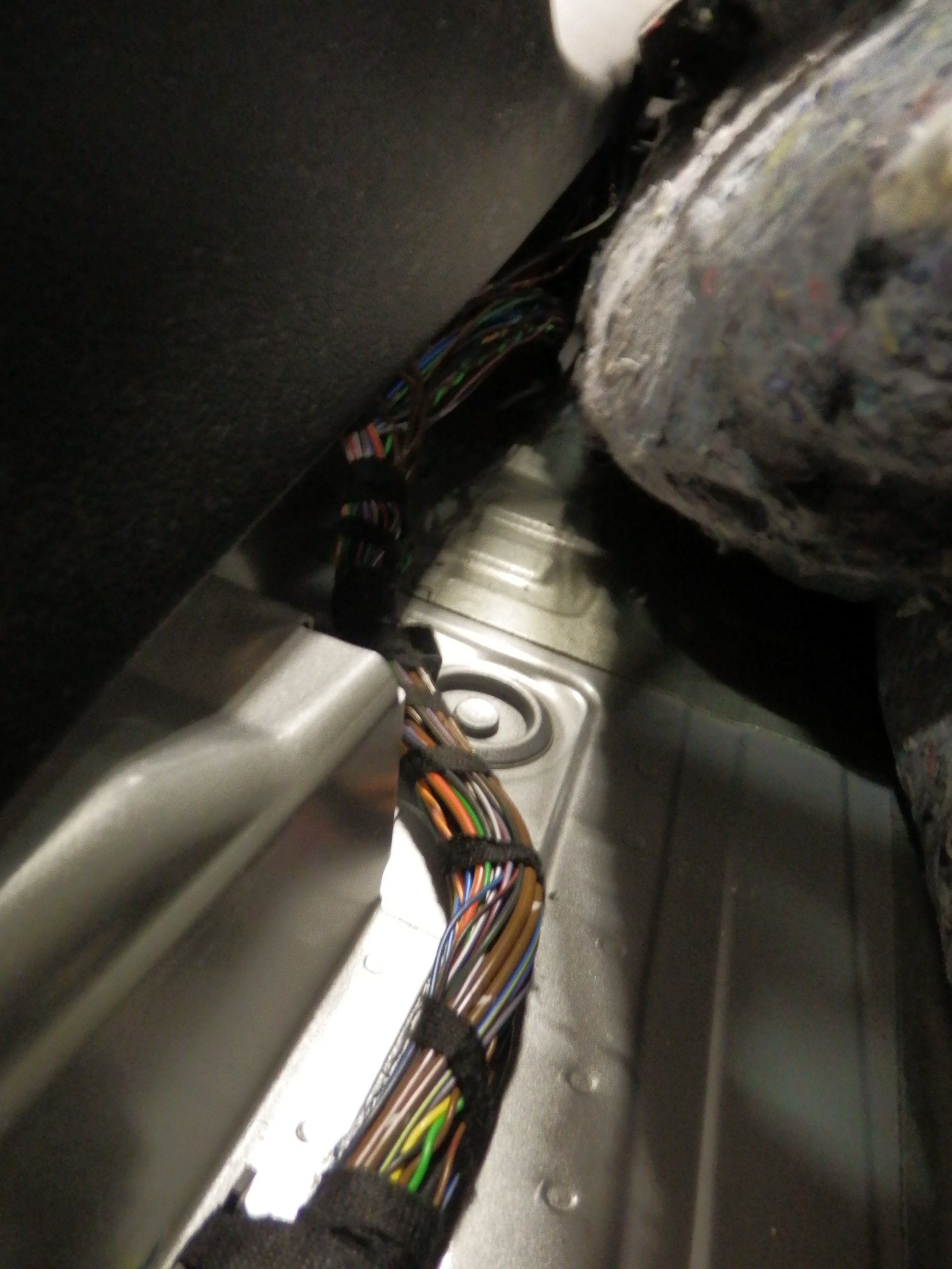

The narrowest / tightest part in the loom is where it slings under the ventilation duct under the driver's seat, so I started to feed the T26 plug with the coax and the 8 fine wires forward under the duct and separated the coax and 8 wires under the dashboard. The T26 goes through the dashboard to the Columbus, the other wires can be joined onto the old Can H, Can L, and 12v / earth just under the dashboard. Can High or/purple, Can Low or/brown, earth brown and 2x permanent 12V (RVC STG red white, TV-Tuner red yellow). You do not have to tap into Can on the Columbus as some instructions tell you.
I routed the 2x T54 plugs for the RVC / Tv-Tuner along the existing wiring loom through the boot trim into the TV-Tuner bracket.

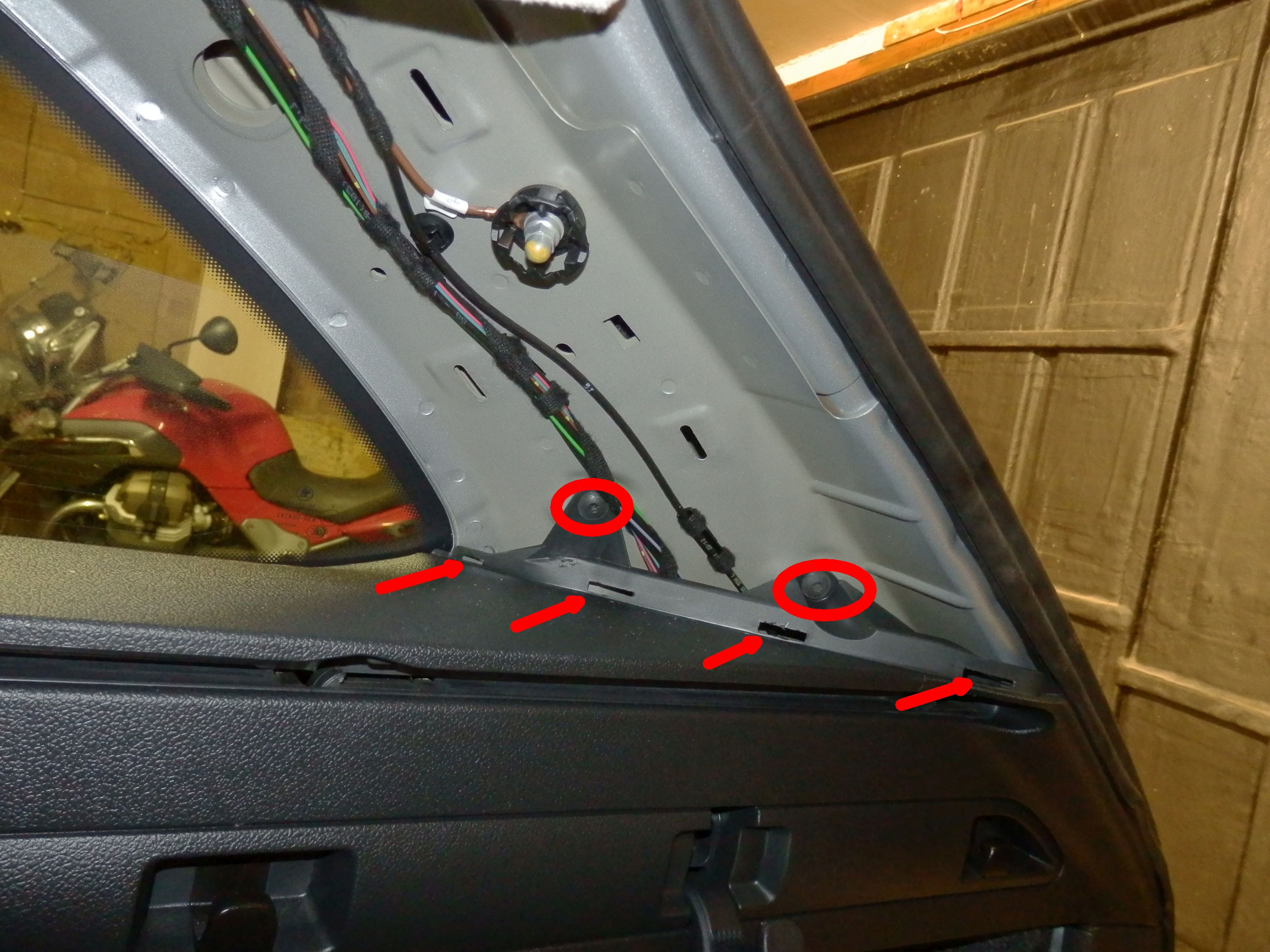

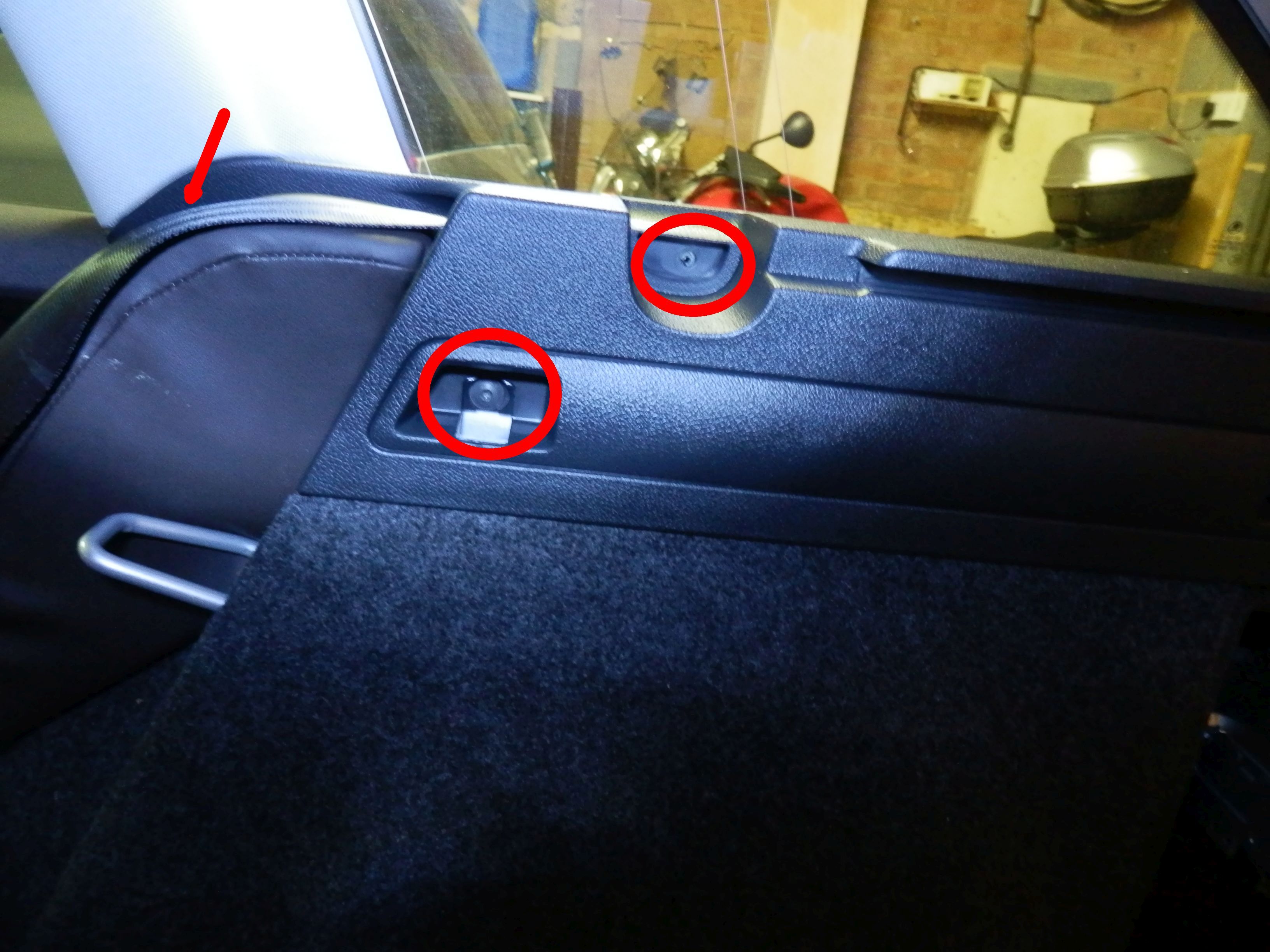

Now I took the tailgate trim off. Remove the torx on the boot close handle and pull the plastic off. Be careful where it attaches onto the upper trim. The upper plastic trim is held with 2 plastic clips where it attaches onto the lower part. Remove them and the gently pull the upper trim off starting at the upper brake light. Make sure all metal clips have come out.
Then slip the rubber boot connecting the tailgate and roof off the plastic holder at both ends and loosen the plastic brackets - see Lutz video. When I fed the Fakra cable through the boot I removed the plastic connector from the cable. This makes it a lot easier to feed it through. Put the plastic connector on again afterwards.
Remove the boot release handle. Mine was just clipped in.
Now you have to start to destroy your car!!!

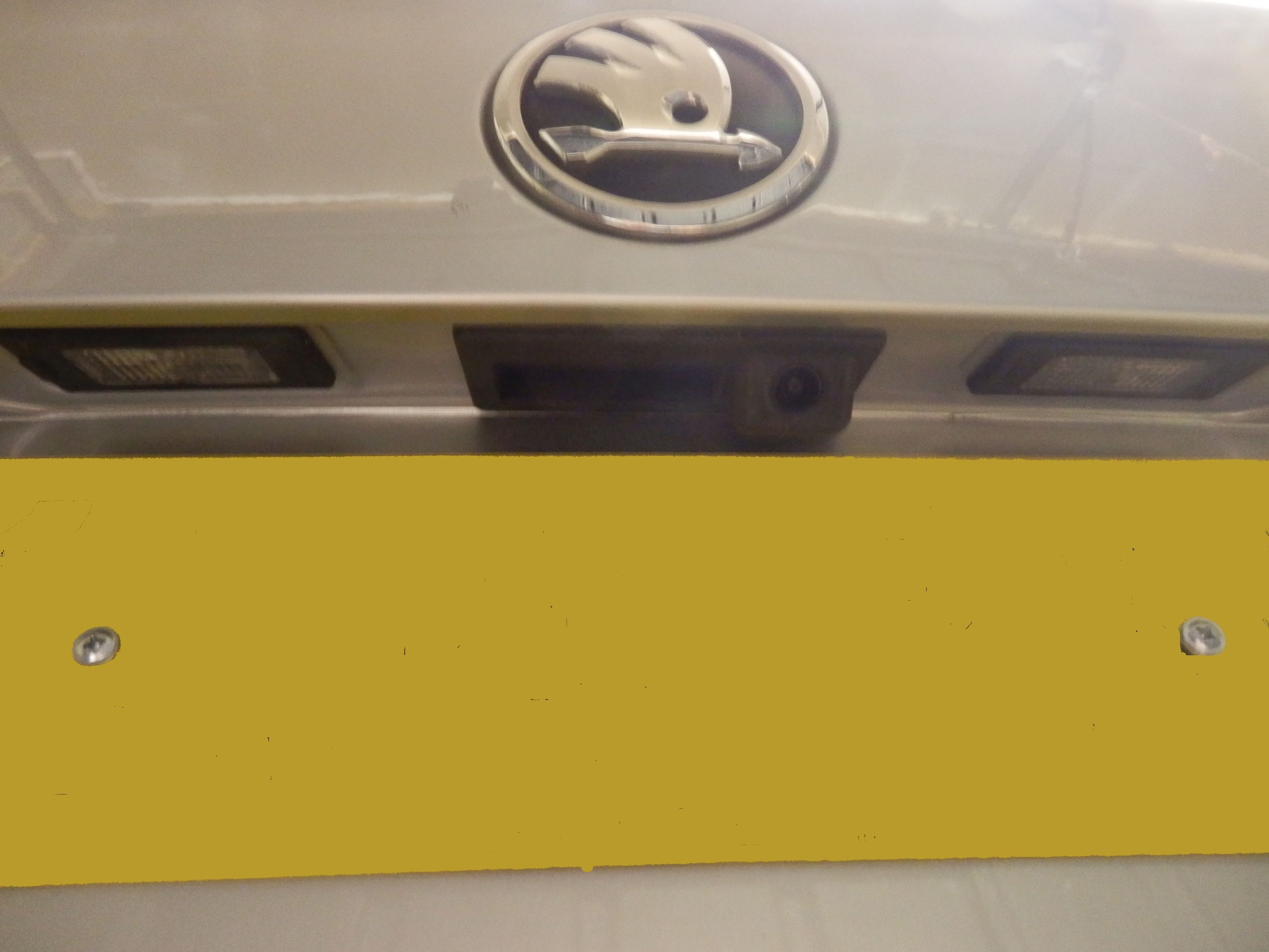

The VW handle is bigger than the Skoda handleif you are going for a RVC high. There are some low ones that have the same size as Skoda's. Measure twice cut once.
Paint rust primer onto the metal. Fit the RVC handle. Connect it - 3 connectors - and route your new wires along existing. Connect the RVC STG, connect the TV-Tuner, Connect the Columbus.

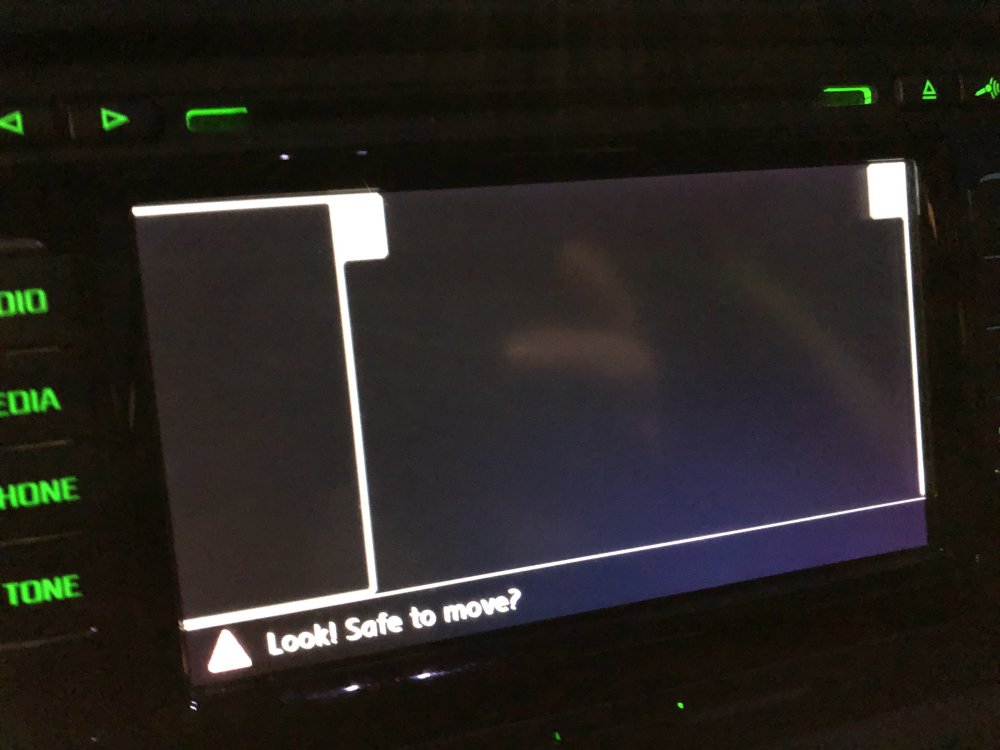

Code the car: STG 10 and STG 19 - see Lutz's video and check that it works. You can calibrate the RVC later.

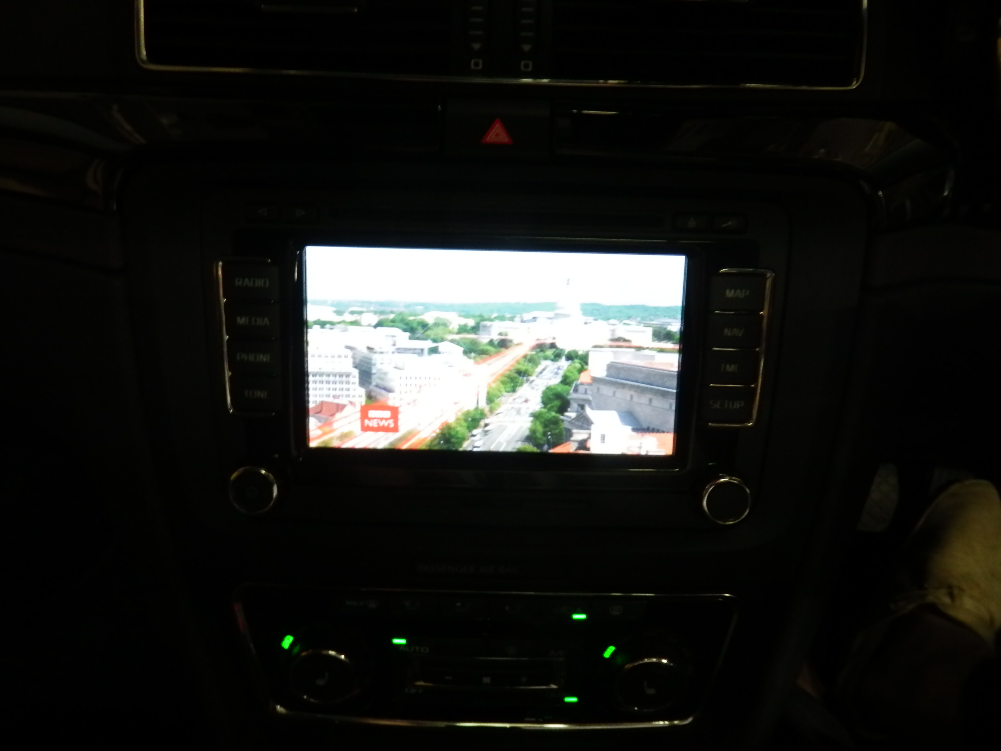

Columbus TV
Columbus RVC

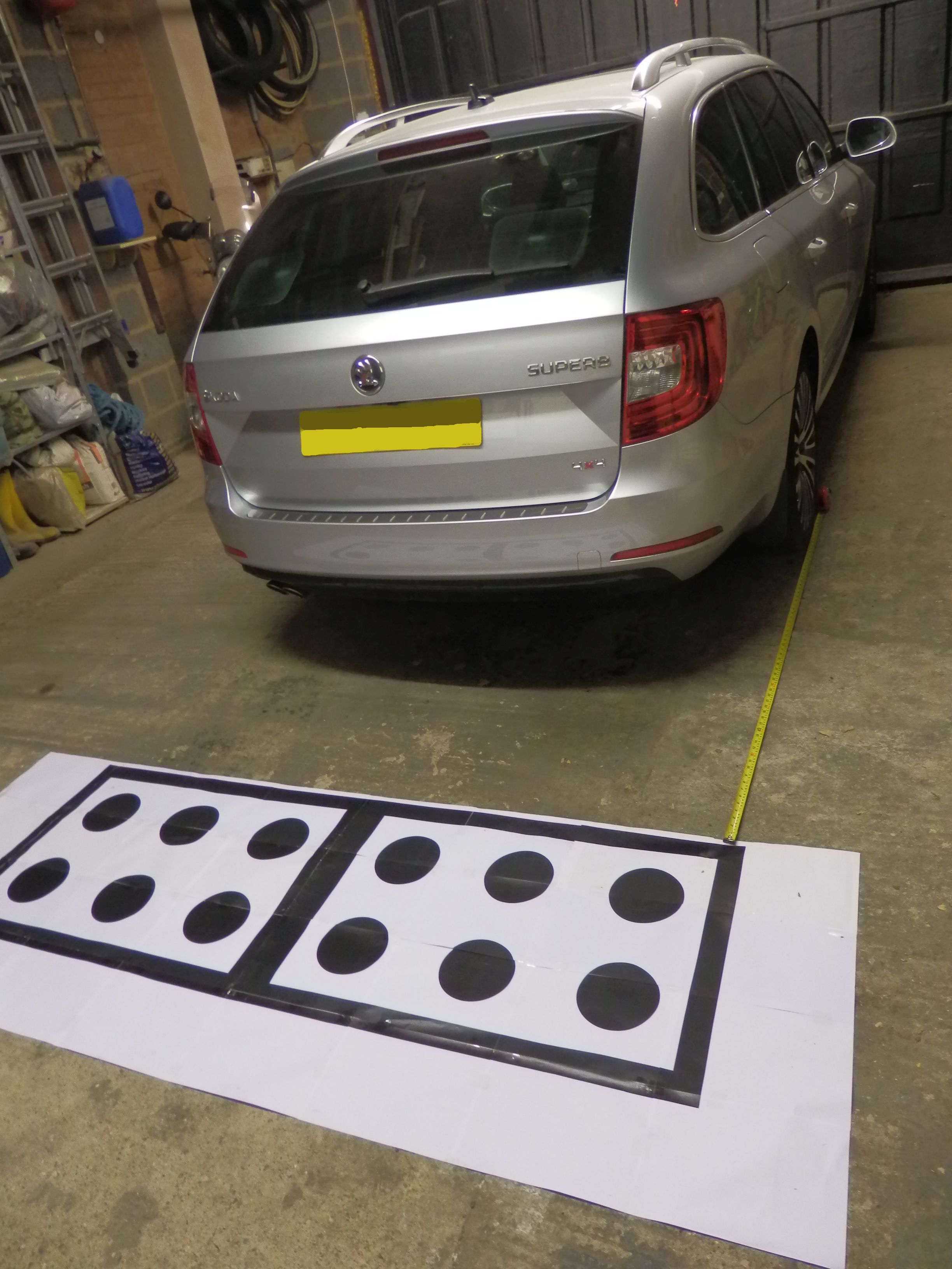

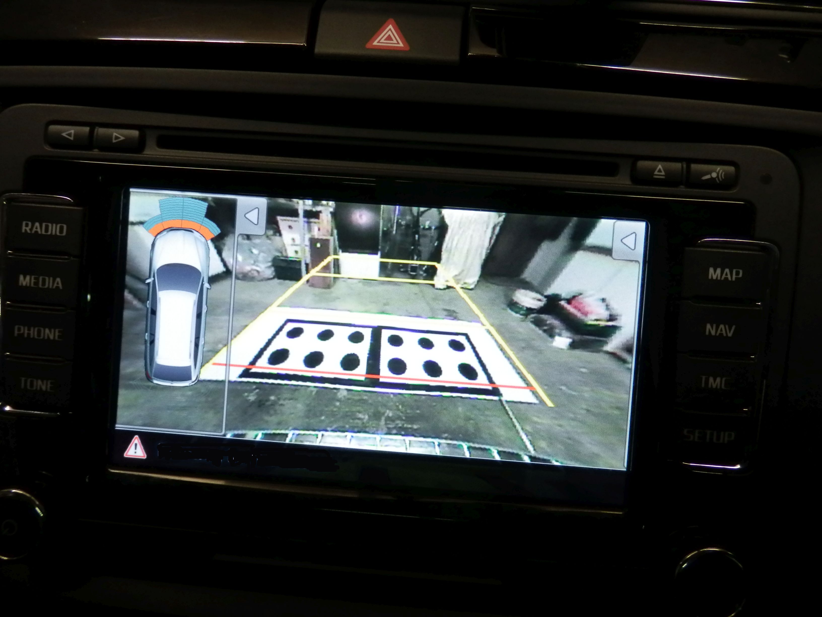

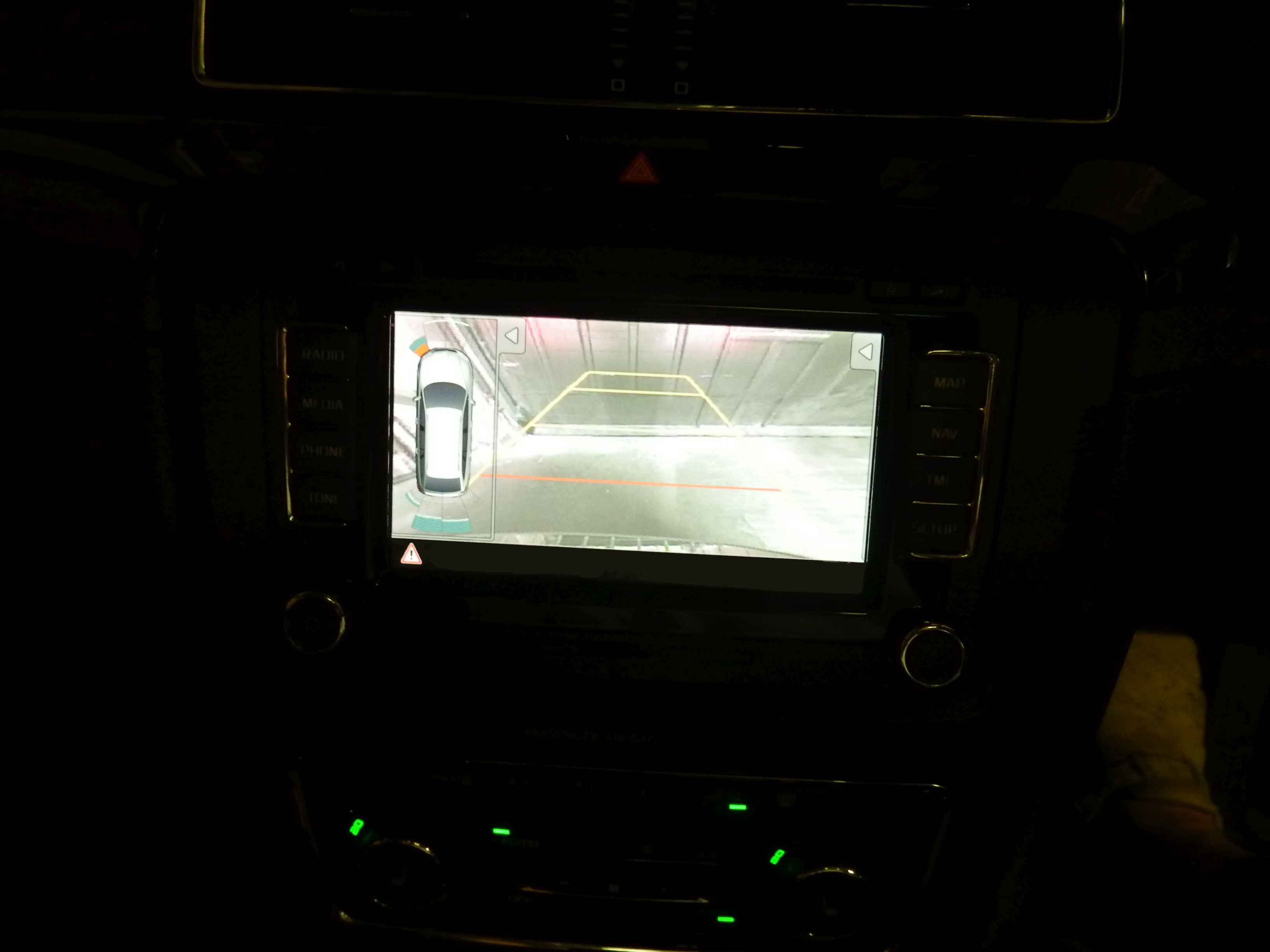

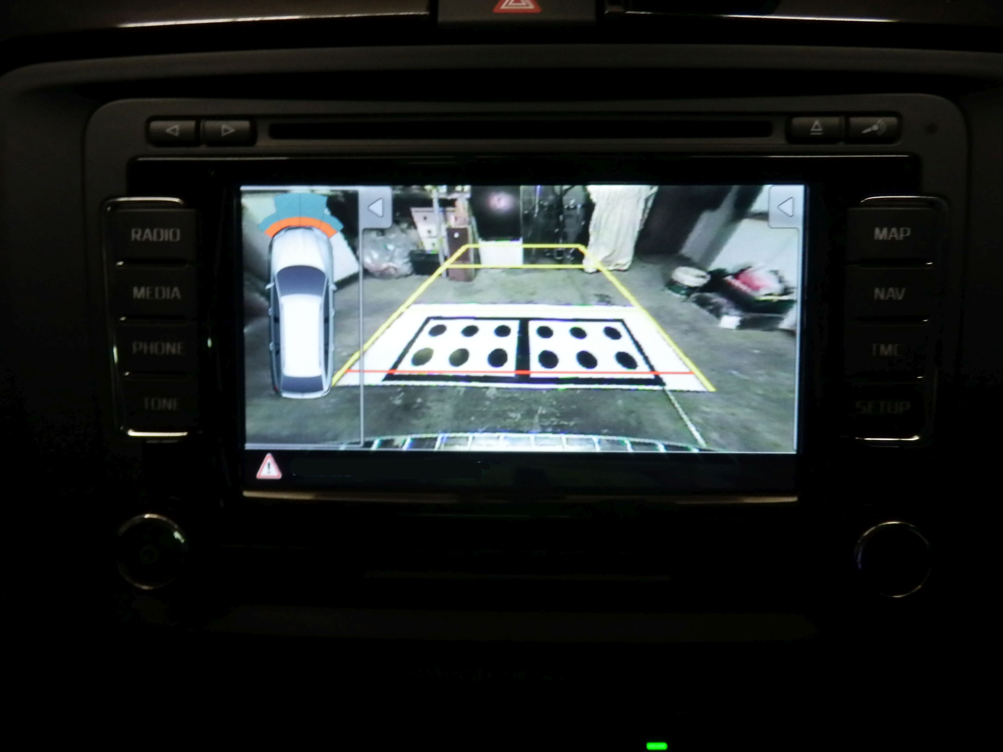

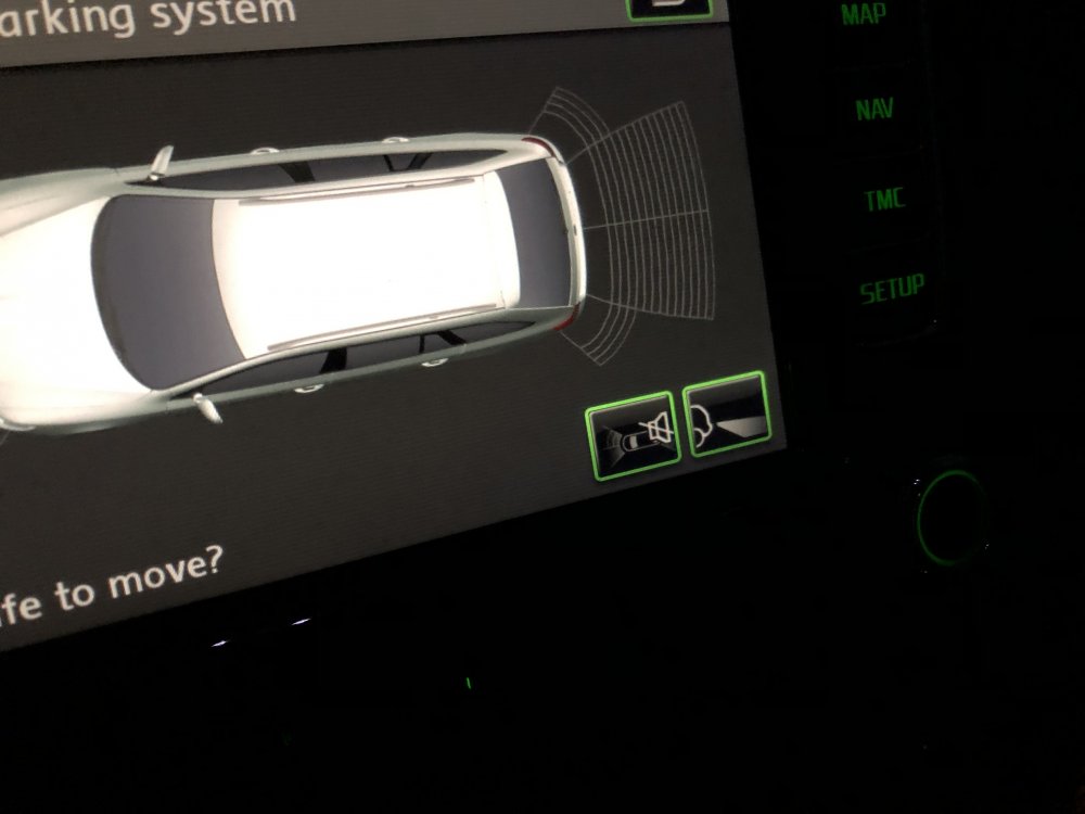

Calibration done.
Put the car into reverse gear with the camera on.
Connect VCDS - easier than VCP, select 6C, select 10, and follow the steps #1 to #3 (confirm).
With VCDS you can then follow the progress of calibration in adv measuring blocks, channel 130, box 3. Mine told me calibration in progress which was nice to read.
The pictures show the grid, the RVC display before and after calibration. The car or camera di not move between the last 2 pictures.

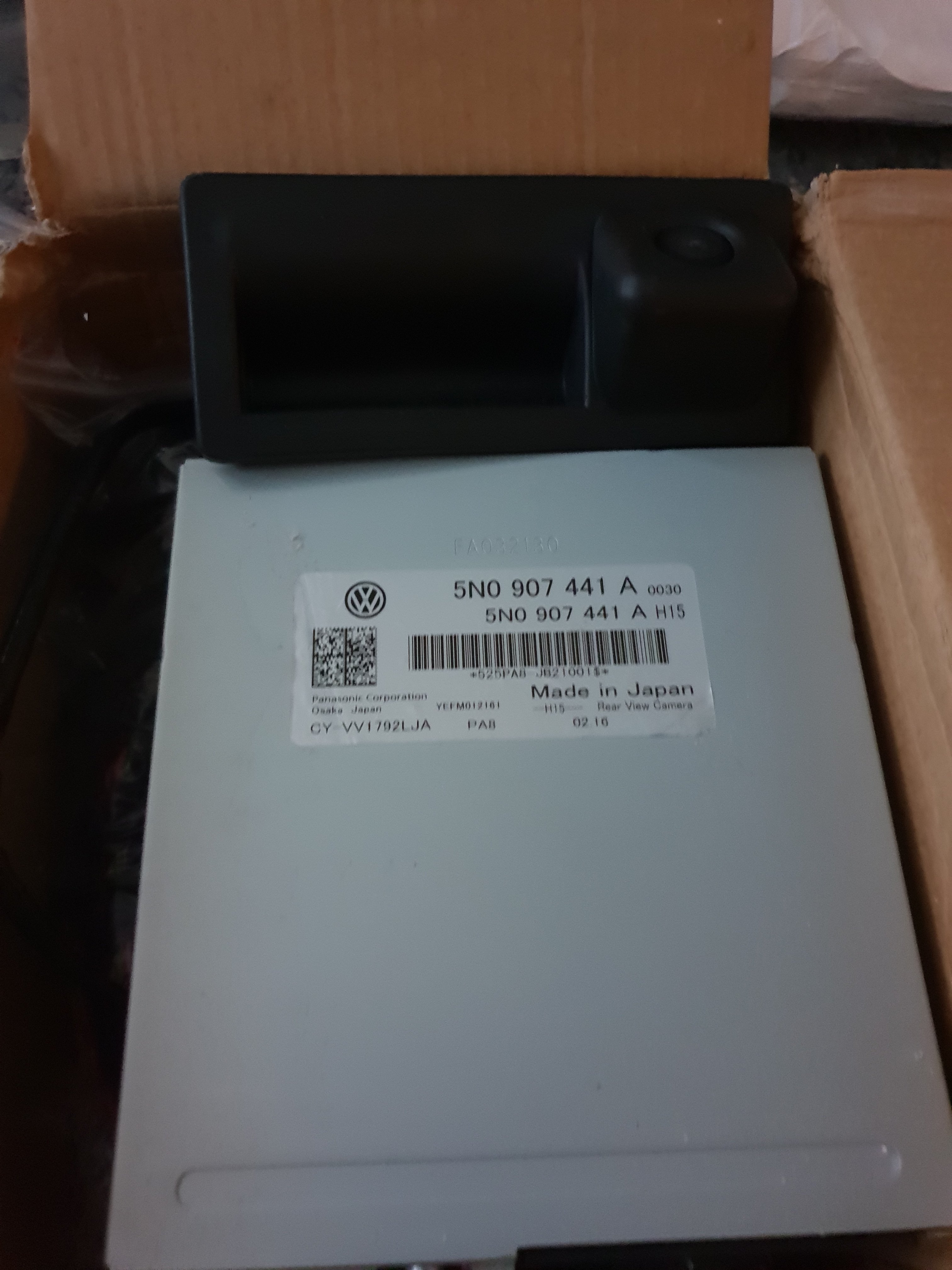

Well it's arrived just need to fit it

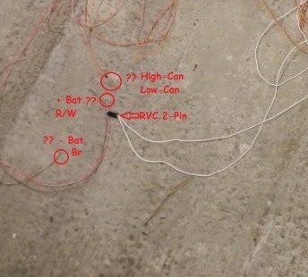

on picture belowe +Bat?? .R/W .is that short for rear washwipe??,
?? Br , what dose that stand for, sorry just oldage setting in,
could you not simply wire batt + to reversing light and batt br to earth. or am i being thick ,
R/W - Red / White.
You want a switched 12V. That is the power supply to the controller. If you only power the controller up when the car is in reverse the gateway will be throwing up errors all the time because it cannot contact the controller. I tapped into it in the A-pillar.
