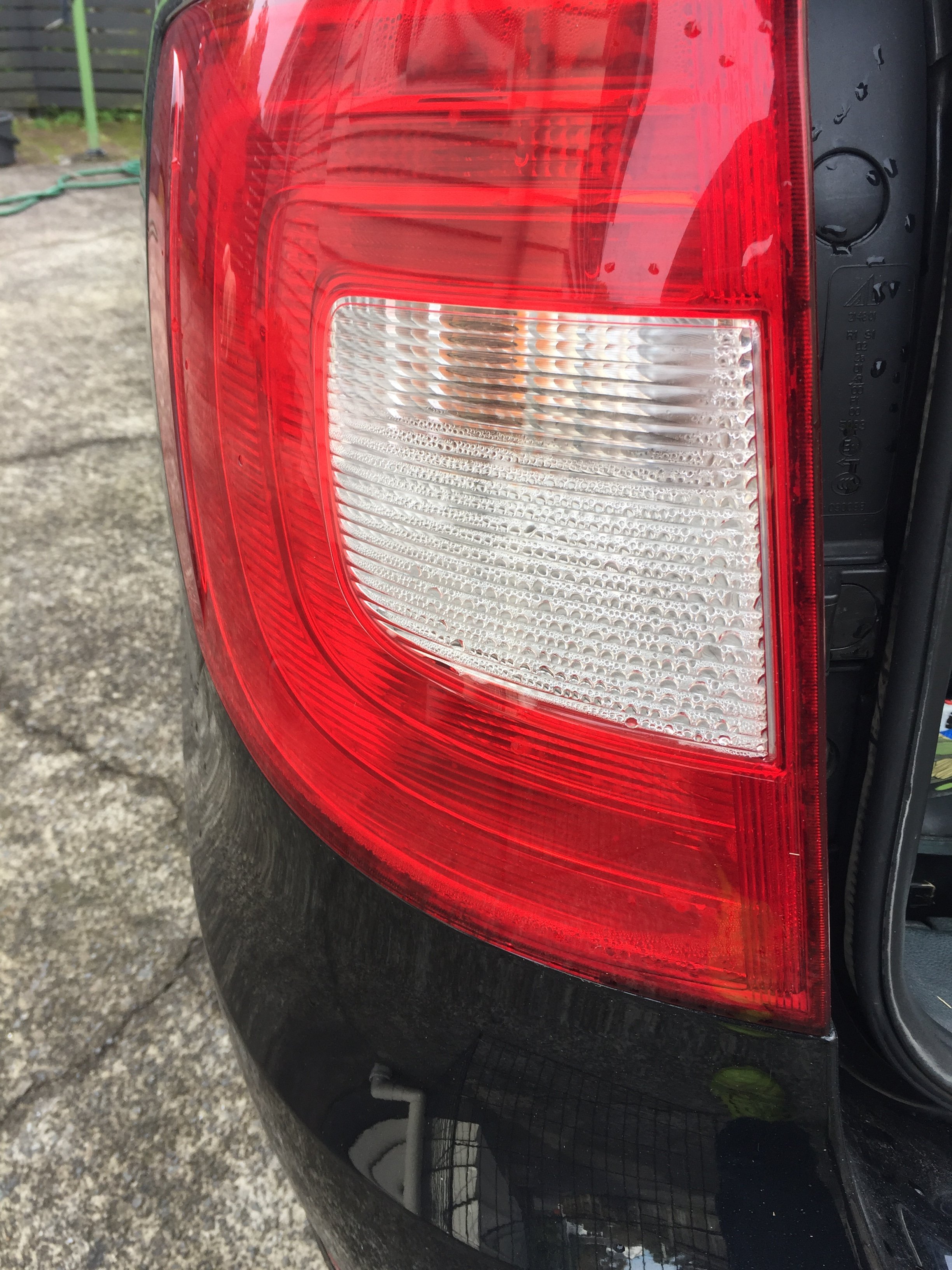

I have water getting into my combi's left rear light. Its only a little bit, not 'aquarium' levels.
So far I have tried cleaning up the seals on the bulb connectors, and drying out (as best as I could) the light using a hairdryer. There are no cracks or obvious breaks in the lights.

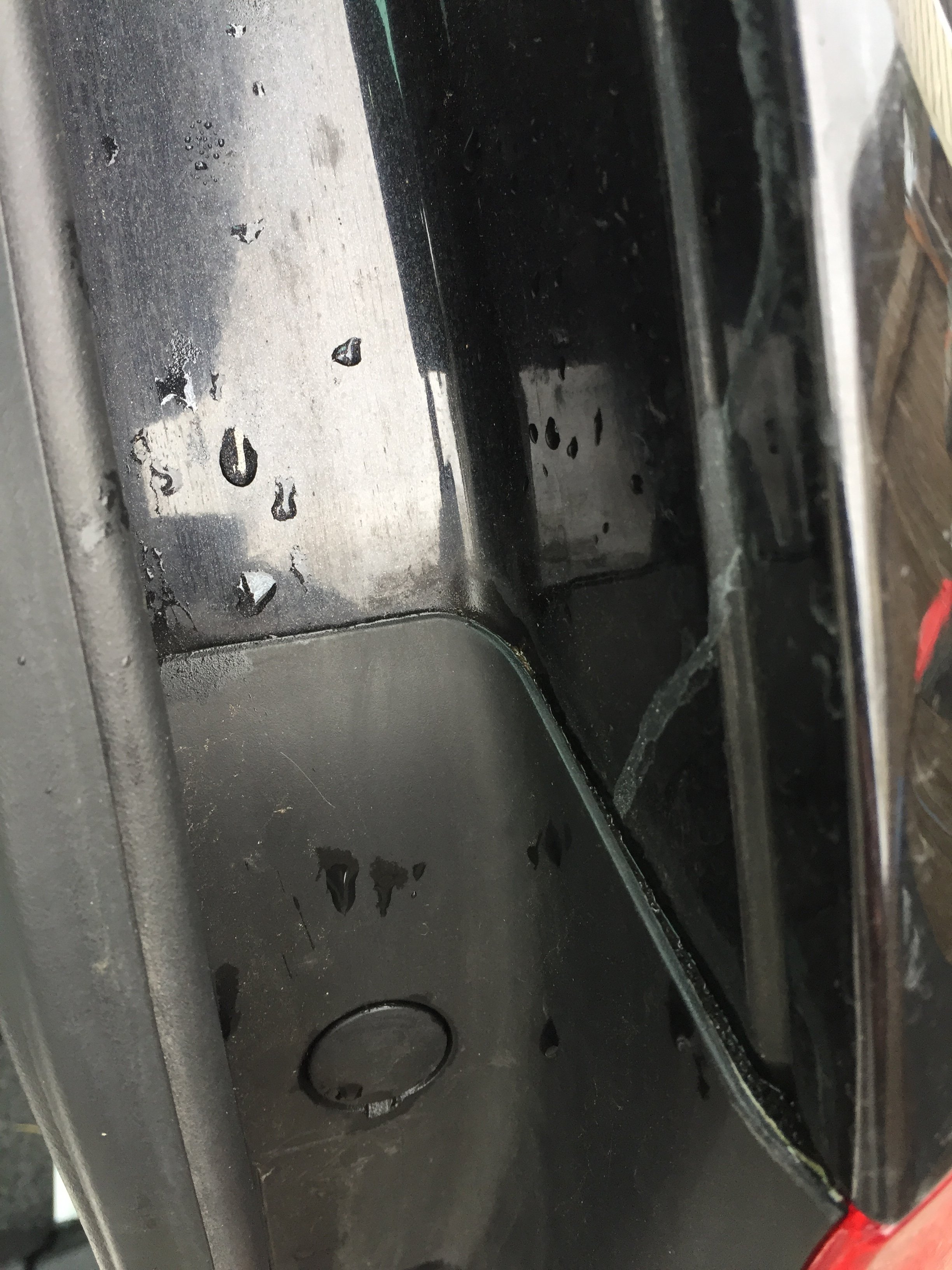

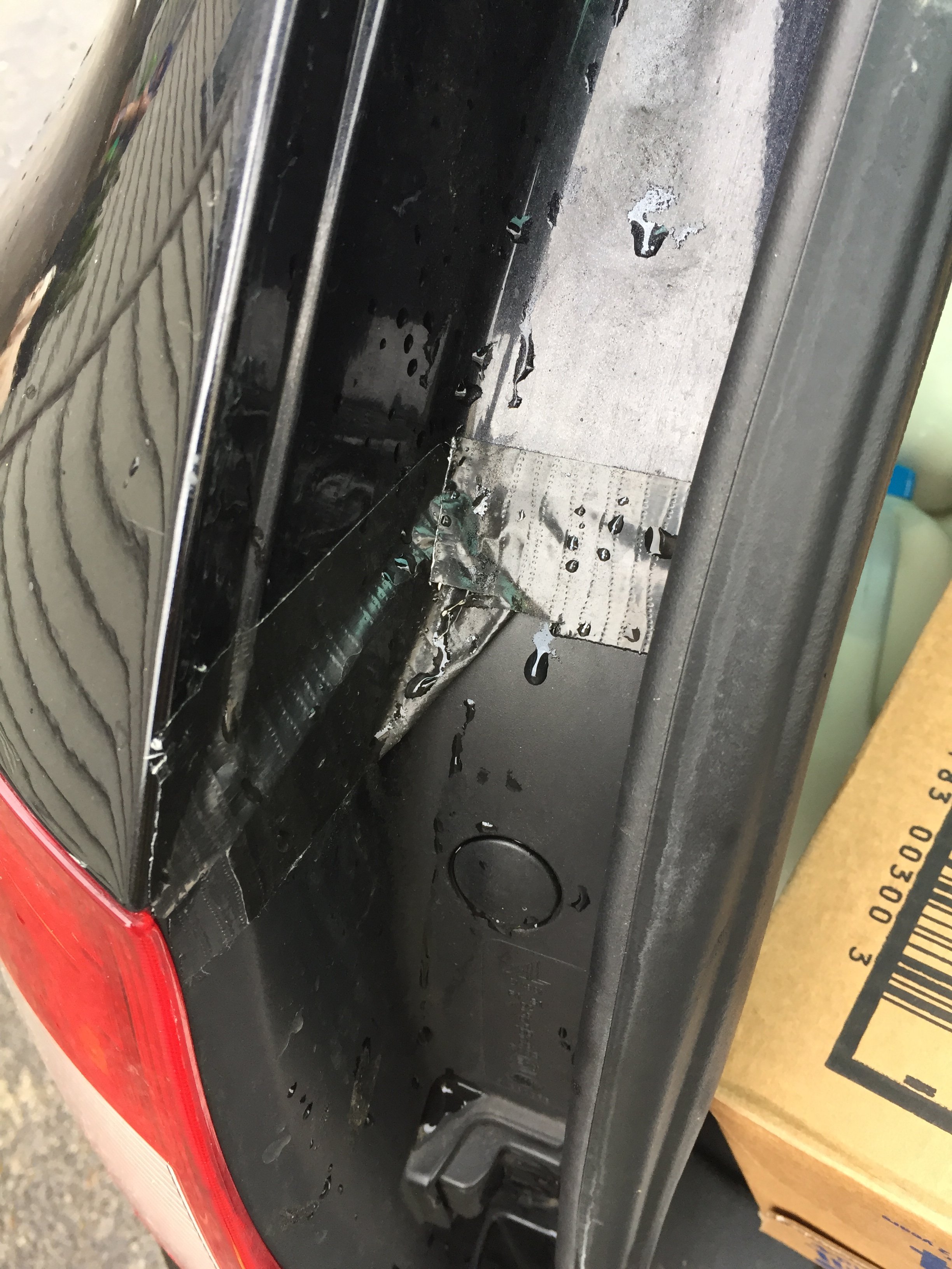

After experimenting with silicone (didn't work for me) I figured the most likely entry for water is between the channels at the sides of the boot and the plastic mounting tab of the lights. There seems to be only a foam insert to stop the water through here.
So, I did a temporary fix by taping over this joint. Within a day the moisture in the light was gone. We had serious downpours over the weekend so it got a good testing!
Next step will be to put some 'nicer' looking tape over this joint.
