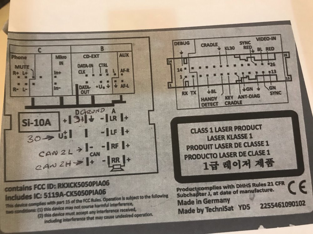

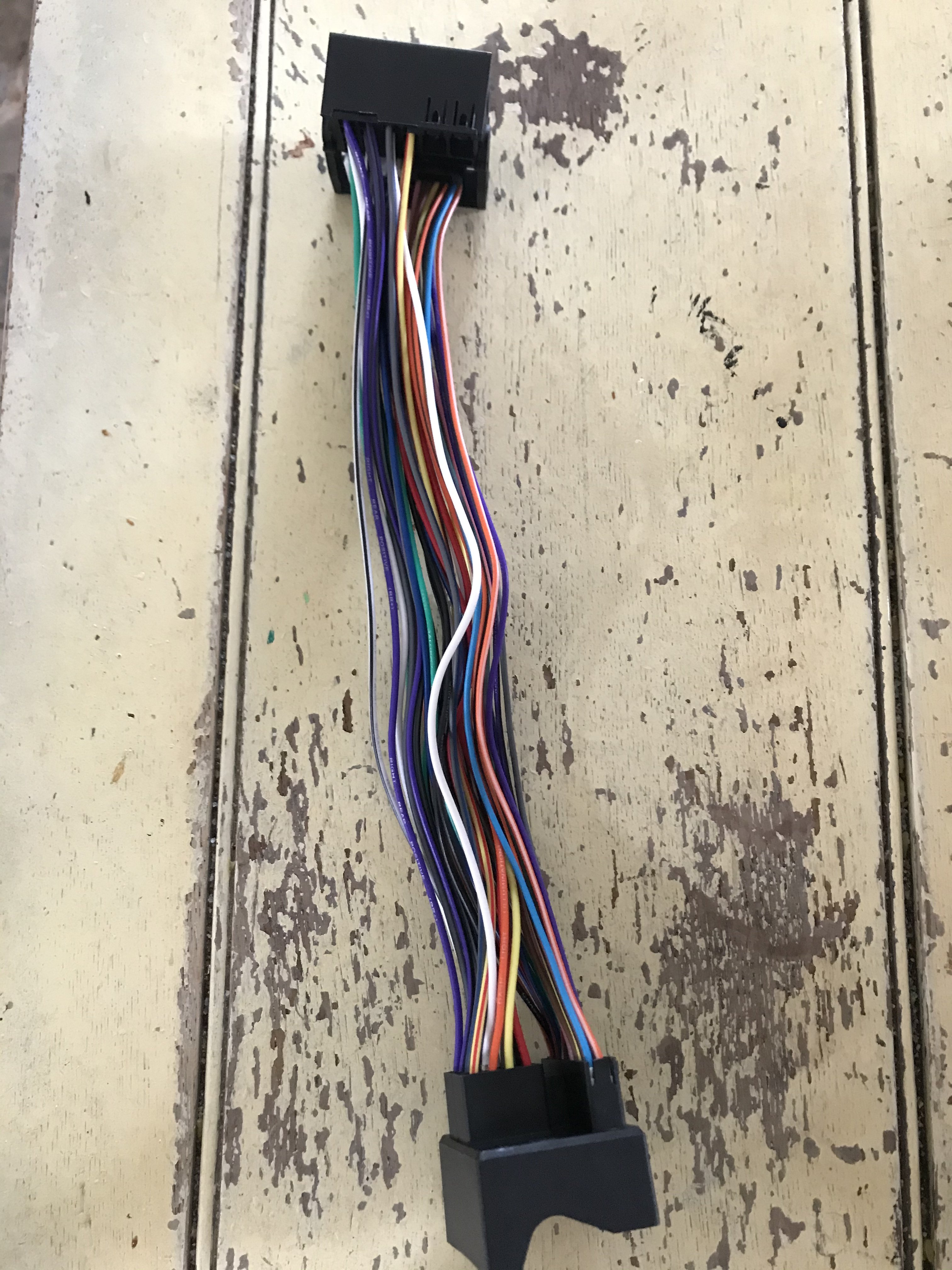

Hi I have the items to do this adaption however the 40- pin version on eBay was no longer available so I purchased another fully wired one off eBay now I’ve come to do the job and noticed my wire colours are different is there any of working off say the socket that will end up in the radio to work out which colours I use I’ll try and add a picture of my unit.
Regards
Simply use the pinout diagram that should be on the radio and trace the wires along. The wire colours are irrelevant.

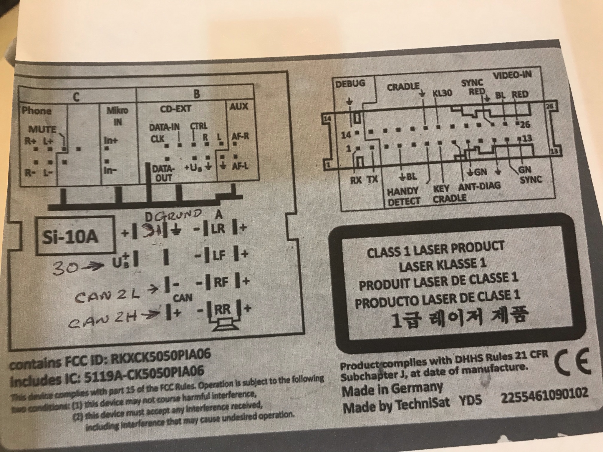

I think I’ve sorted it but just to make sure can you check I’m right in the photo I’ve marked where I think they should go, to the head unit. Regards
Quick glance that looks OK to me!
Hi again it appears to work but is not switching with the ignition so I am assuming I should move 30 up to the next + so it will be opposite the negative ?

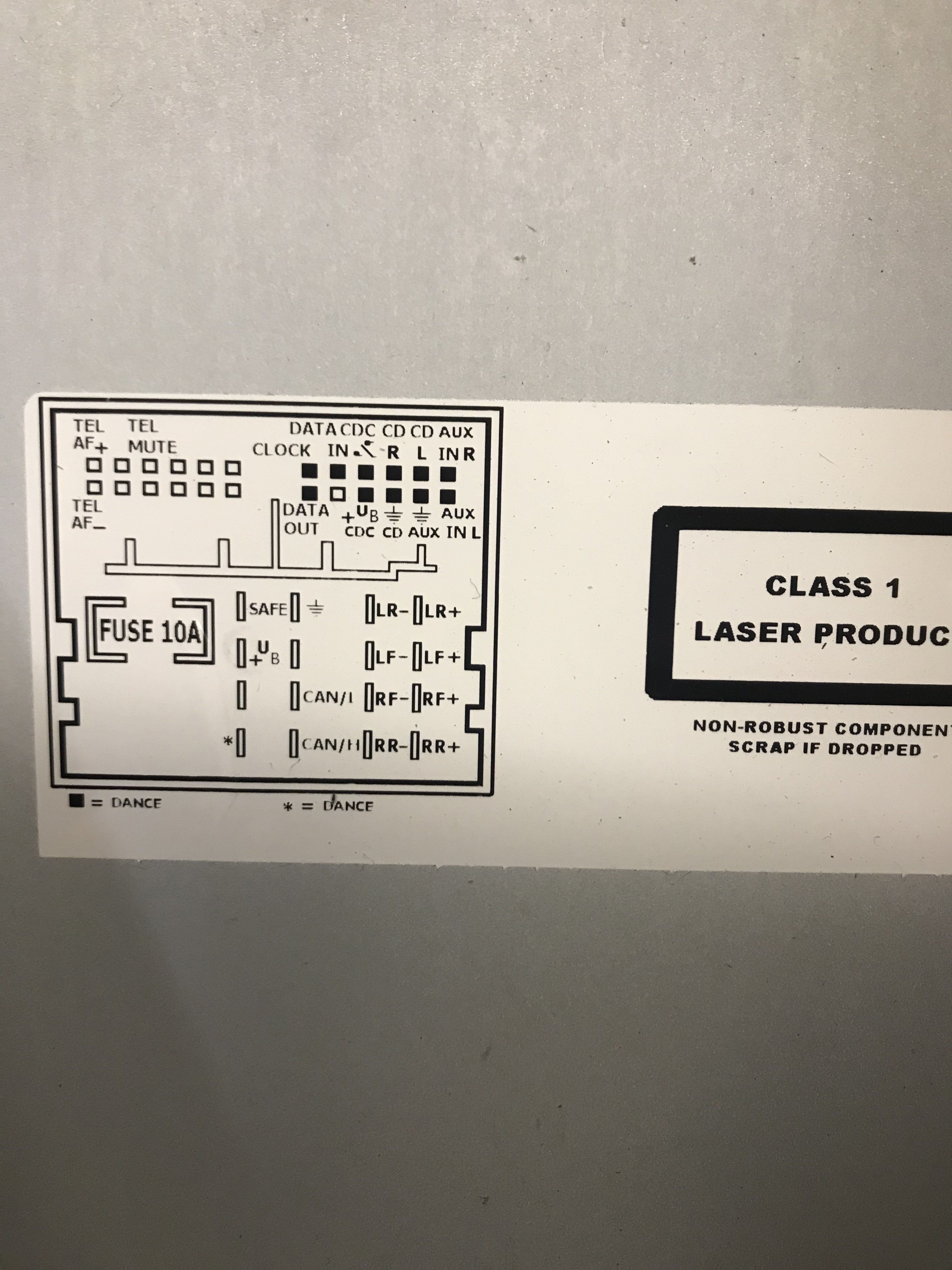

Well I’ve checked my original plug and there is no feed to either of the + listed on my new  head unit so it would make no difference if I did move it, should I put a switched live to the one I have marked as 30. Take it from the fuse board ? This is a picture off my old radio
Sorry for being a pain I’ve just checked over my connections again and one of them was not making a connection rectified it and now it’s switching with the ignition, should the map dim when you put the lights on seems to make sense.

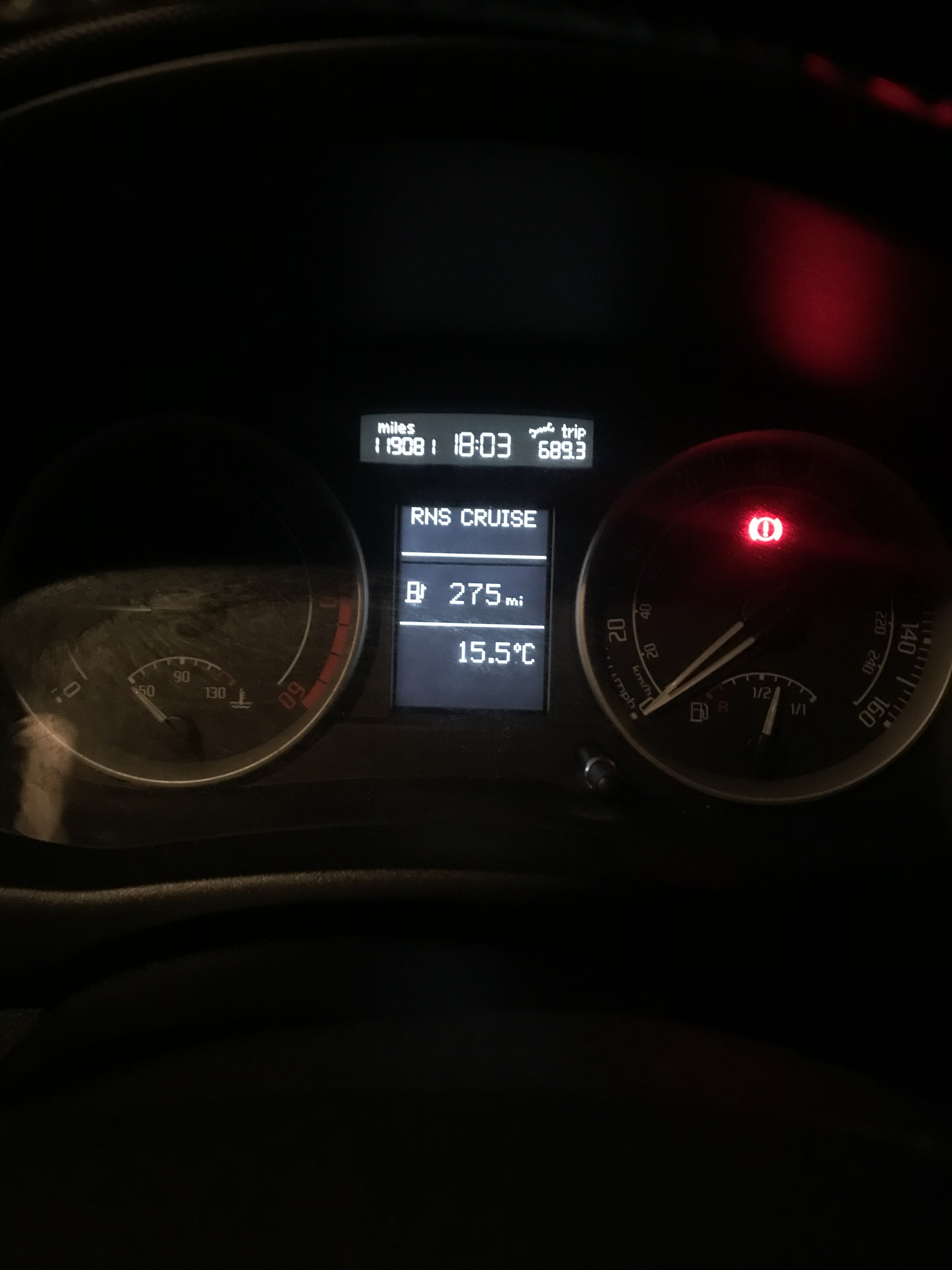

Hi the adaptation seems to be working fine however this message appears on the screen whenever the radio is on RNS CRUISE ?
I thought RNS Cruise was an RNS 300 ?
I thought it was referring to the car being in cruise control, my radio is a Amundson +,
Is it just saying that’s the type of radio ?
This message is from the Relay used, it was designed for the Cruise RNS300 but can be used with the Amundsen RNS310.
I only see that message infrequently. Don't worry about it.
Glad you got it sorted.
