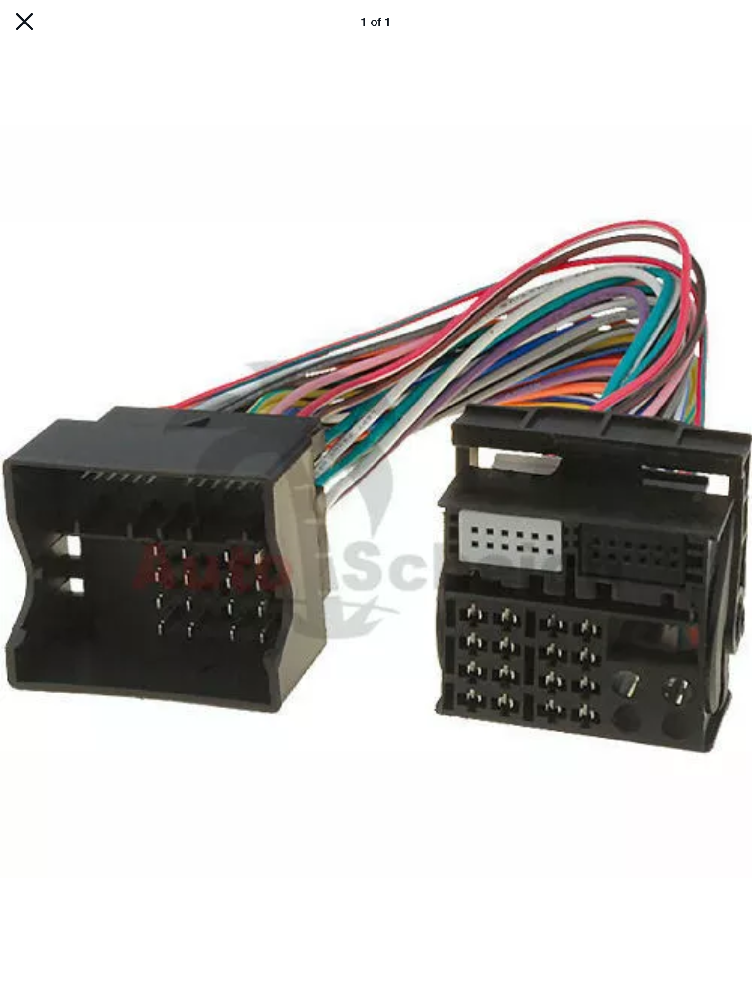

4. Quadlock extension cable (fully wired 40-pin version on eBay)
Quadlock extension cable (40 pin)

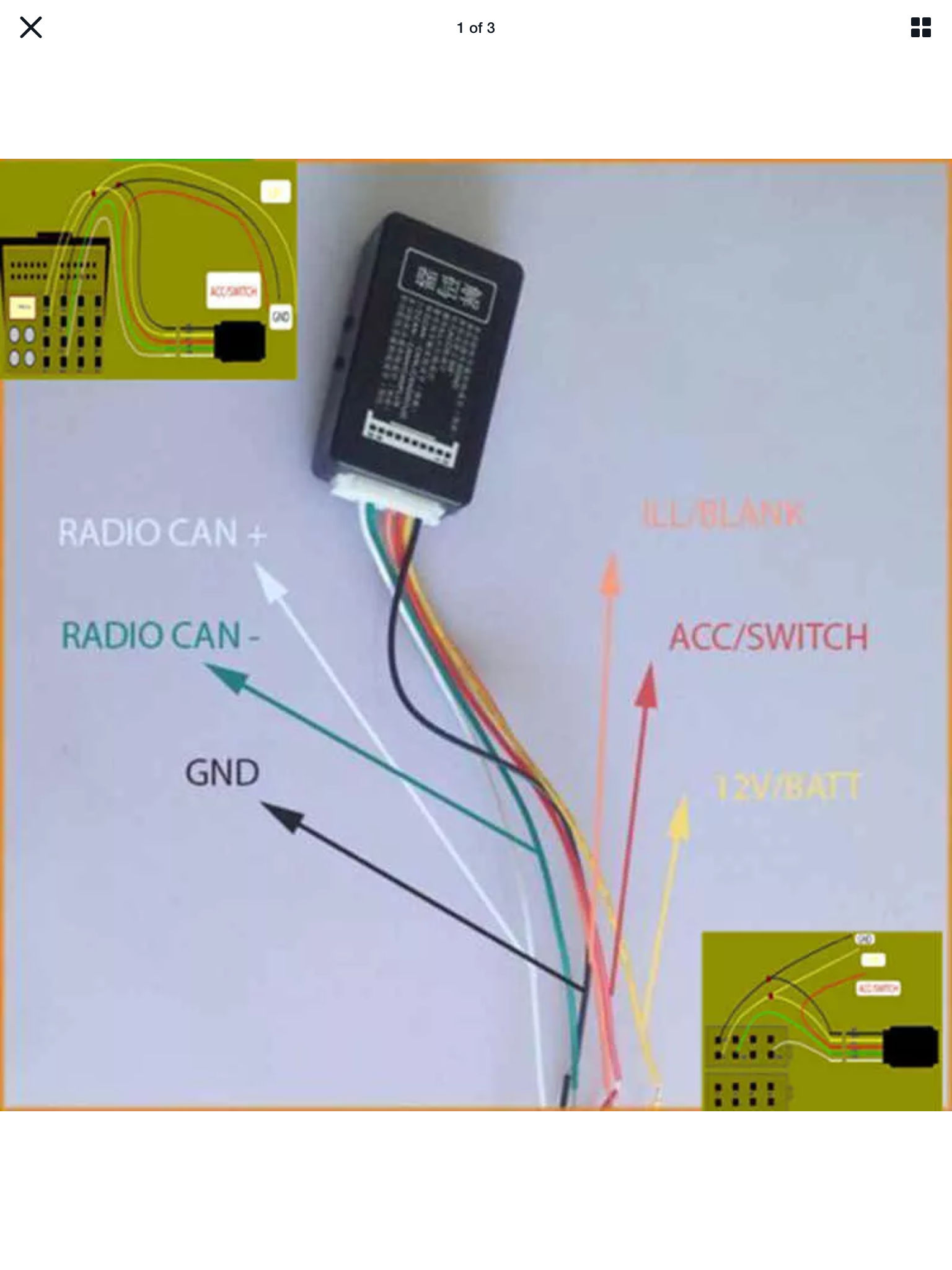

1. make sure your adapter has some wires or a harness of its own attached
2. attach the female tap connectors to the quadlock extension
wiring is as follows:
CAN 2H = CAN 2.0 + (to headunit)
CAN 1H = CAN 1.6 + (to car)
CAN 1L = CAN 1.6 – (to car)
31 = GROUND (12v –/negative)
CAN 2L = CAN 2.0 – (to headunit)
30 = BATTERY (12v +/positive)
3. IMPORTANT: You need to cut the CAN High/Low wires between the tap connectors for the adapter (red marks on below photo, which was taken before I cut the wires).
The relay converts from the older car signal to the newer radio signal. Imagine it as a language translator.
The wires are cut so the older car signals don't get to the radio.
One half of a cut wire with the car signal goes into the relay and the other half of that wire with the converted signal comes out of the relay ready for the radio.
If the wires aren't cut then the relay can't work correctly and the old signal is still getting to the radio.
In short, if you don't cut the wires it will not work :blush

That looks just the job but can’t find the relay any ware and I cannot read the link I’m not allowed help !
Hi as I can’t find the relay do you think these items will suffice.
Regards Danny

What I don’t understand about this is a relay is a set of either N/O or N/C contacts and a control relay, so my question is why does it cost so much for this item 83.53 euros.
Has anyone check one to see what the setup is ?
