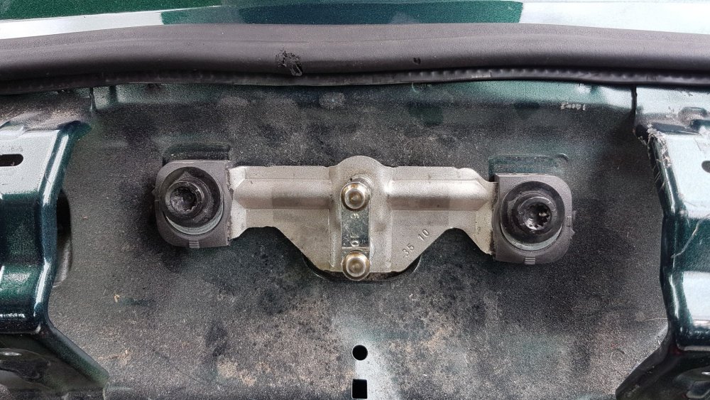

Took apart the lock mechanism, could see that it clicks in twice and it's the second click that properly engages the lock and the micro switch. One can manually do this as there is the emergency escape lever to release it.
I then plugged it back in and hey presto the boot open warning on the maxidot goes out and the wipers and wash work. So...
Thinking about how it all fits together, I took a look at the hook mounting and noticed it's adjustable. Seems that many years of use has pushed the hook too far down. I moved it up about four mil and tightened it down. Then bolted the lock back on, crossed fingers and closed the tailgate.
It worked perfectly:biggrin:

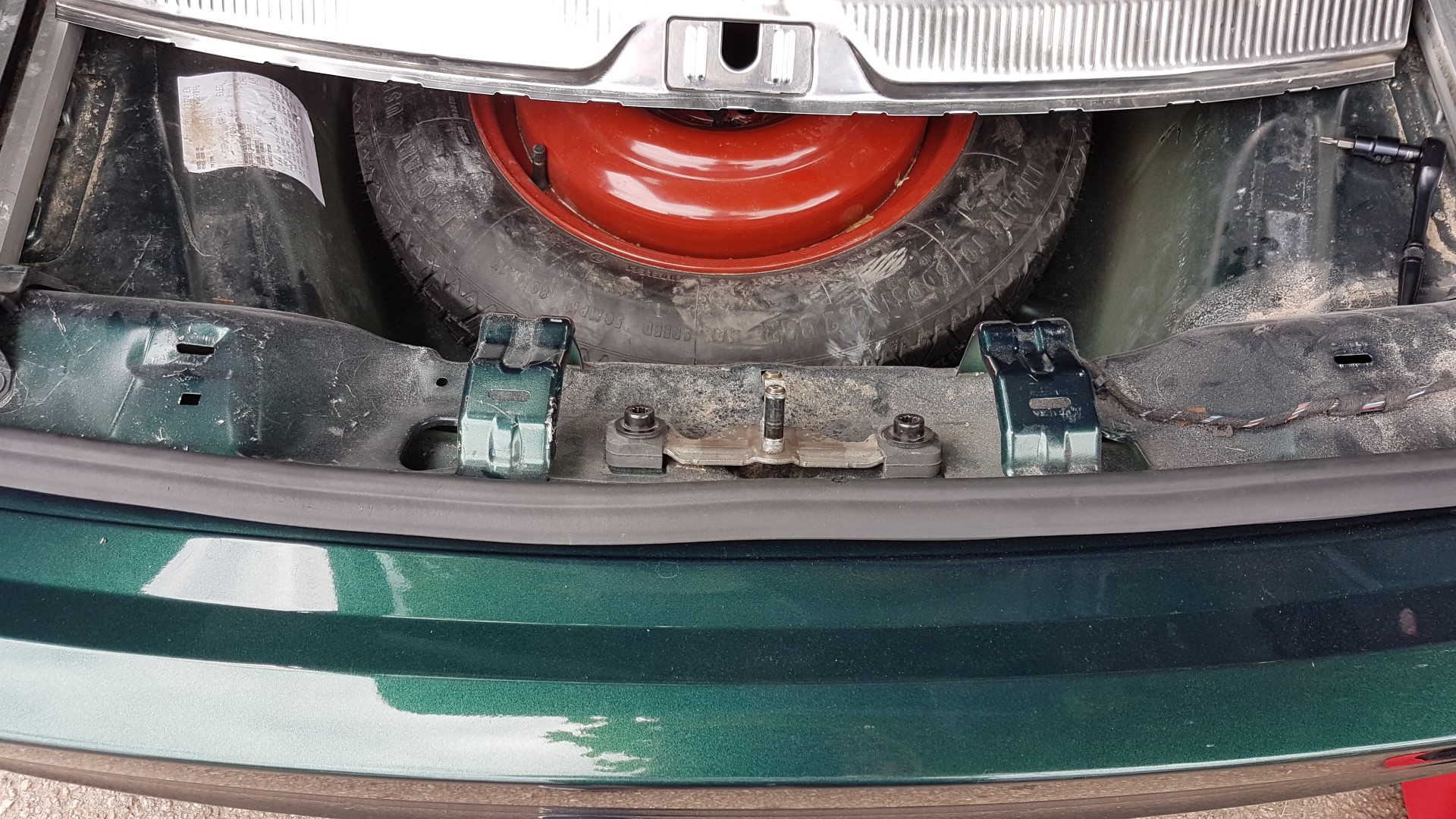

Three screws hold the plastic and metal trim on, remove those and get it out the way. Pics below show next steps. Thanks for the replies earlier, gave me the confidence too have a go.

Has your spare wheel well been full of water in the past? Looks a little dusty.
Also, is that the OEM spare? I've never seen a skinny space saver in a Skoda before.
Unsure, it is very dusty, looks like sand/cement has gone all over the place. Didn't consider water... I'll have a proper look.
As for the space saver, no idea. I suspect it's not original. It came with it, no tools or jack, or bolt hold in down though. Another post on here seeking info on that...

Andacami - thanks for this.  My Superb 11 Combi is fixed too by moving the lock striker plate upwards.  There was no indication the door wasn't closing properly from the Maxidot or from boot lights staying on (at least as far I am aware on the latter).
Some tips for those doing this job.  You will need a Torx T50 and T20 bit.  The first for the striker plate bolts, the second for the 3 screws which hold on the plastic cover.
First, prop up or remove the spare wheel cover and lift out of the way the foam surround of the wheel well.  This will expose the 3 screws which hold on the plastic cover for the striker plate.  Undo these and prise up starting one end the cover releasing the clips which hold it into the horizontal surface.  Loosen the bolts holding the striker plate and move it upwards about 3-4mm.  Tighten it and close the boot.  If you have left the car locked it should beep at you (if confirmation is on).  Now switch on the wipers including the rear and (hopefully it now works.  My washer worked straightaway but the wiper didn't - ok, I live in a hot country so I went around and freed the blade from the glass.  Presto, working now!
BTW, if you wish to remove the chrome plate from the plastic piece which covers the striker plate, you will see that you need to remove the plastic piece to get at the clips which hold the chrome plate on.
