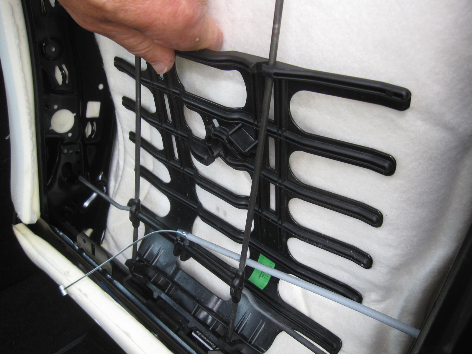

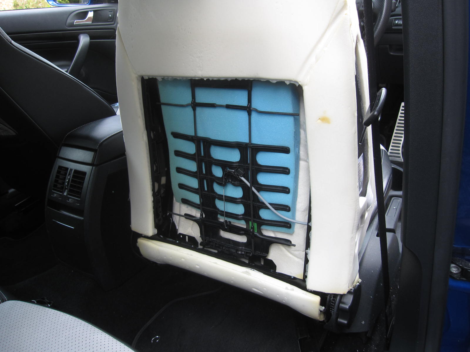

I've been driving 2012  MK11 TDI VRS for three years  and been unhappy with the saggy back seats, so today I stripped off the seat cover and inserted a 11" square piece of 1" thick foam into the seat back which seems to have provided more mid back support.  Tomorrow I will be driving 200+ miles so will report back with more data.
I must say, considering the complexity of a seat the actual seat back structure is pathetically feeble and nonsupporting and lumbar support too low, like most cars I've owned. Will write more later.

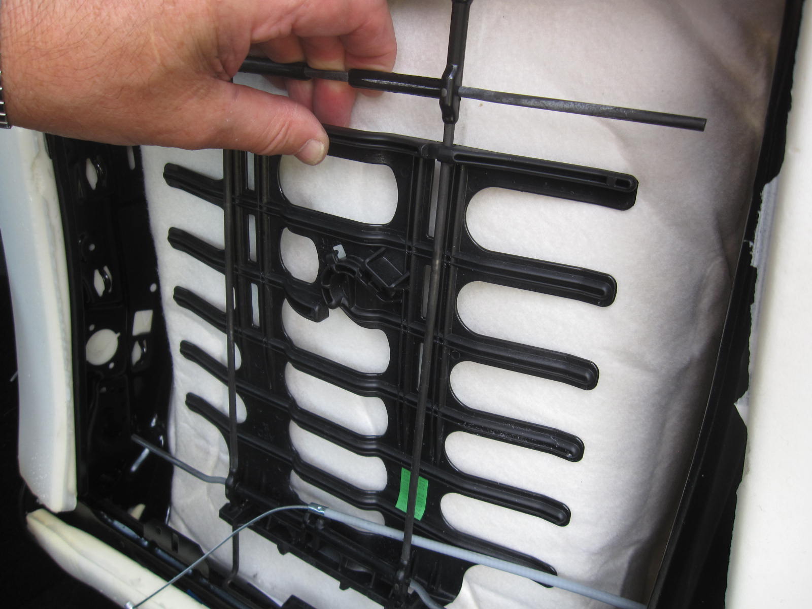

more data
Now I've seen the insides of the seats and the reason for my displeasure of the saggy backs I will put this on the list of negatives aspects of the VRS, along with pathetic halogen dip lights (now Xenons so ok), over servoed brakes, rubbish suspension, lead weight wheels, needless to say I won't be rushing to buy another any time soon.
I can see too why the drivers RH seat bolster collapses, its because every time you enter or exit the bolster is crushed onto the plastic surrounding the seat,  seems like a design fault. This may also be the reason why the bolster causes pain in the right posterior thigh. I cured my pain by sitting on folded up towel which raised me up about an inch and hence relieved pressure on the leg.

In the first pic I pushed down the plastic grid which simulates turning lumbar knob clockwise and second pic its straight.
Further to my ramblings re lumbar support, its recommended when sitting to get your bottom back into your seat/chair which increases lordosis of the lumbar spine. Now when you're in the car and adjust the lumbar to get more support it's actually too low down the spine and tries to push the pelvis forward, or anteriorly in chiropractic speak, I think you're better off winding the lumbar support fully anticlock and this may allow bum to tuck back into the seat a little more. In my humble opinion the vrs seats can't achieve what the human body requires, we would be better off with a solid back approximating to the curves of our spines.

I have noticed the poor seat back design allows me to slump in the seat but my shoulders are supported which aggravates the posture.
You could also try some foam to see if this helps and go from there.

225 miles and 5 hrs of driving M25 and M27 yesterday!! The 1" foam has provided a firmer support but i needed to raise seat height which, as I'm sure you all know, tilts seat forward and hence reduces the pressure under thighs, also needed to apply a little lumbar adjustment which complemented the overall feel,  so I think it's an improvement. Do the seats in the mkIII have separate tilt and height adjustment?
Hope this may be some help although it was a sledgehammer to crack a nut.
