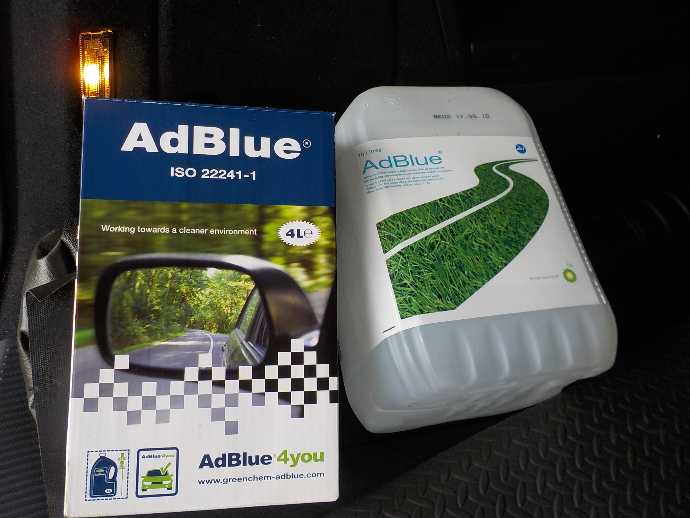

Well i can assure you that my 2.0TDI SCR TDI did pretty well this winter.

They say -12*oc for adblue to crystallize but i never noticed any issue, and no diesel waxing either.
