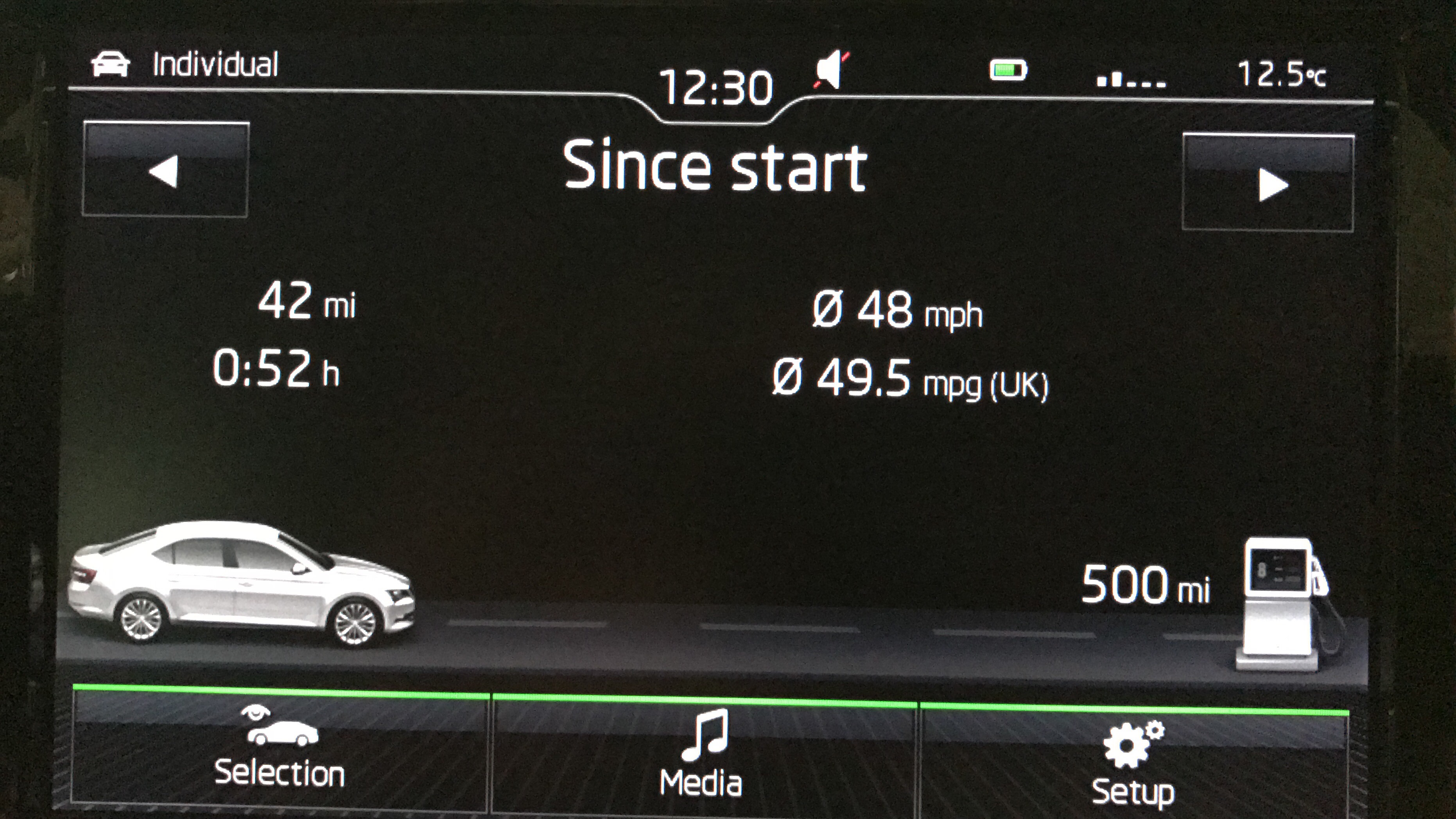

Not bad for a 220ps 2.0 turbo petrol. ;)  On the way back I managed to make a bit more 'progress' due to a lack of closed lanes etc, but still returned 44mpg all in. I've had similar and less in 2.0 TDIs over the last 10 years, so that's really quite some feat of engineering if you ask me. While you're right that petrols can be more sensitive to speed, hard driving and congestion, overall the gap has closed significantly. For example once the oil is warm it's pretty hard to get the MPG numbers down in my little TSI, and even if you full on boot it to the red line through a few gears the numbers are back up again within a mile. One thing is definitely is more sensitive to, however, is weight. I get a few more MPG when I'm out alone versus loaded with a family of 5 and stuff in the boot. Diesels don't tend to show that quite as much (though it's still a factor).
For me, OP, if the 2.0 can return numbers like this I'd have no hesitation in choosing a 1.4 over the TDI, and enjoy driving it a damn site more than its alternative.

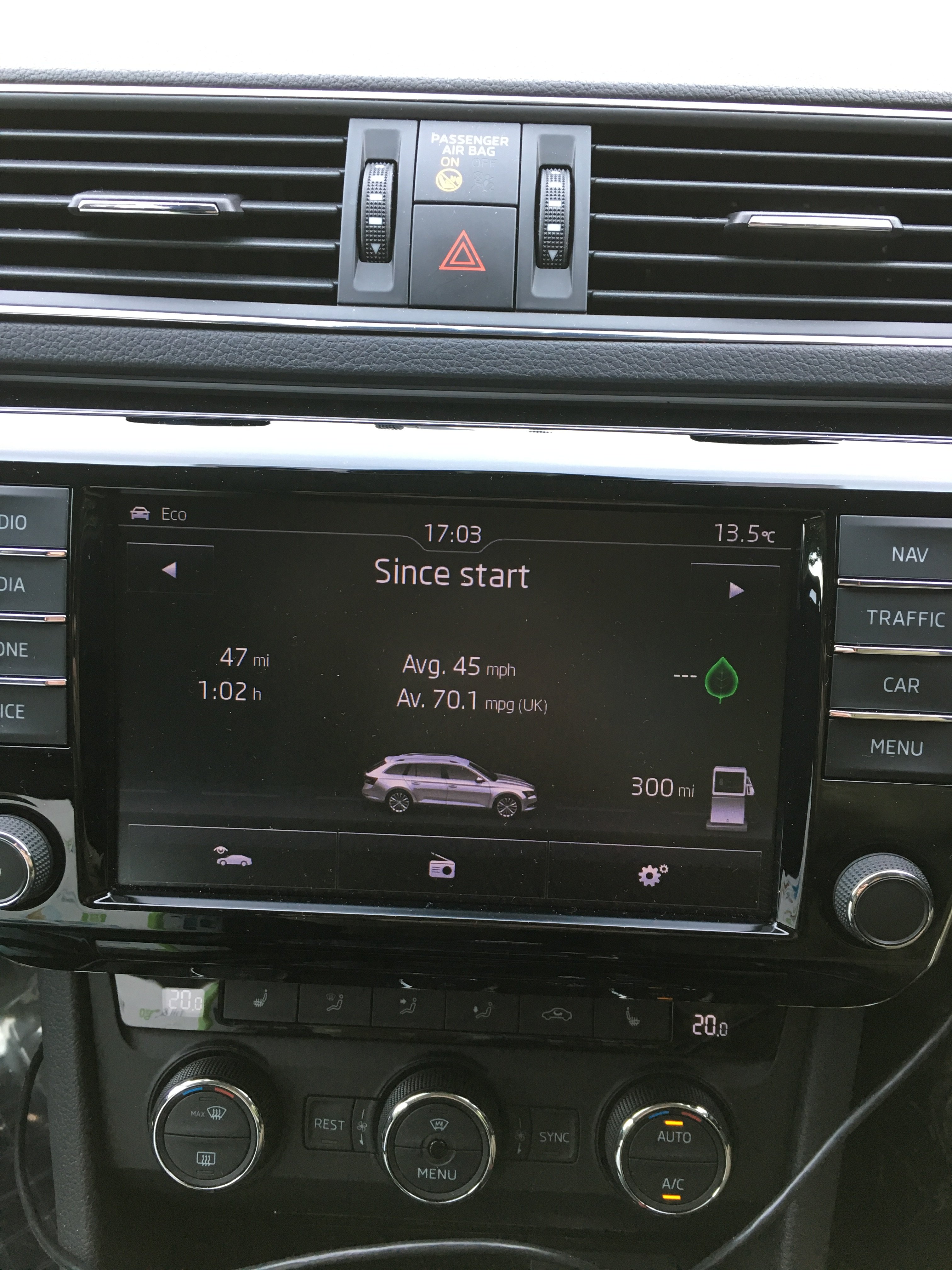

In the spirit of comparison this was from my 190 TDI
That's very impressive LP!
