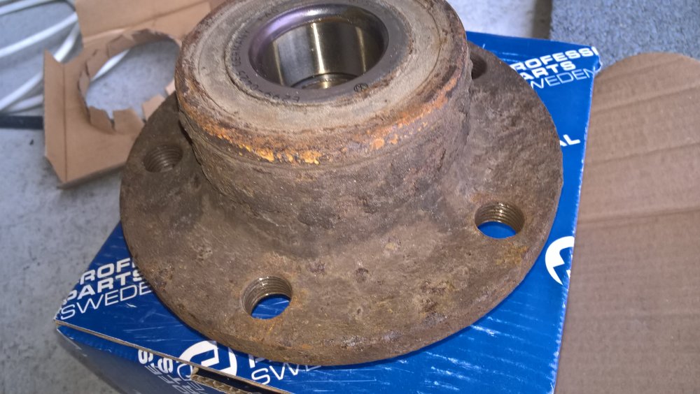

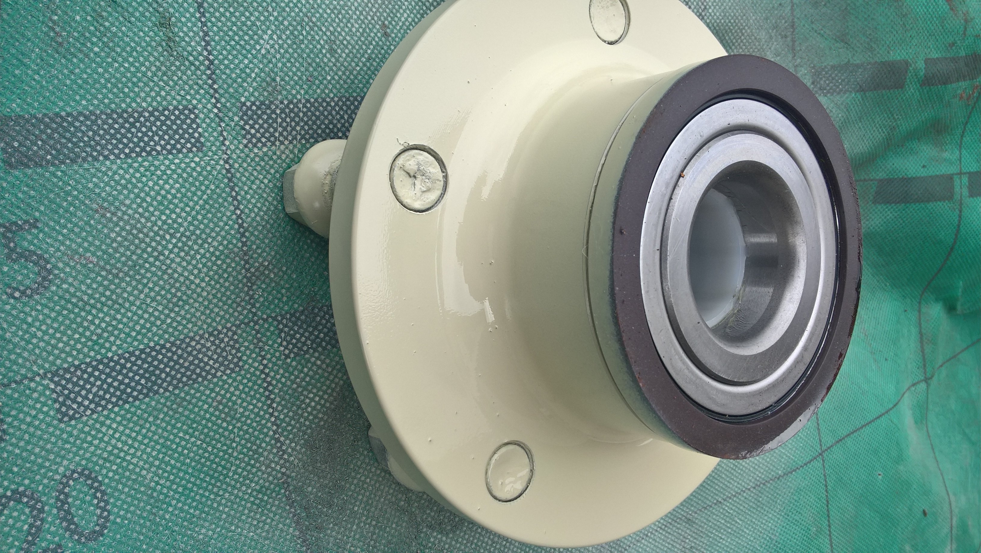

Before I mounted the new RH rear wheel bearing, I took the effort of priming and painted the external surfaces. As one can see from the old bearing image, the ABS ring is missing, Onby part of it were still on when I removed the brake disk. Part of the ABS ring had damaged the tip of the ABS sensor. The new bearing have a different type of ABS magnetic ring.(not perforated). No more amber lights!

Maybe abit late now but the abs rings are usually available on there own and just push onto the hub.
I did not relaize that ABS rings were available s separte parts. However, the bearing itself was worn as wll, and needed replacement. This is the third worn bearing I have changed on my Yeti.  One wheel to go. It has 170000 km (106000 miles) ( on the odometer.  I mostly drive on pawed roads.
