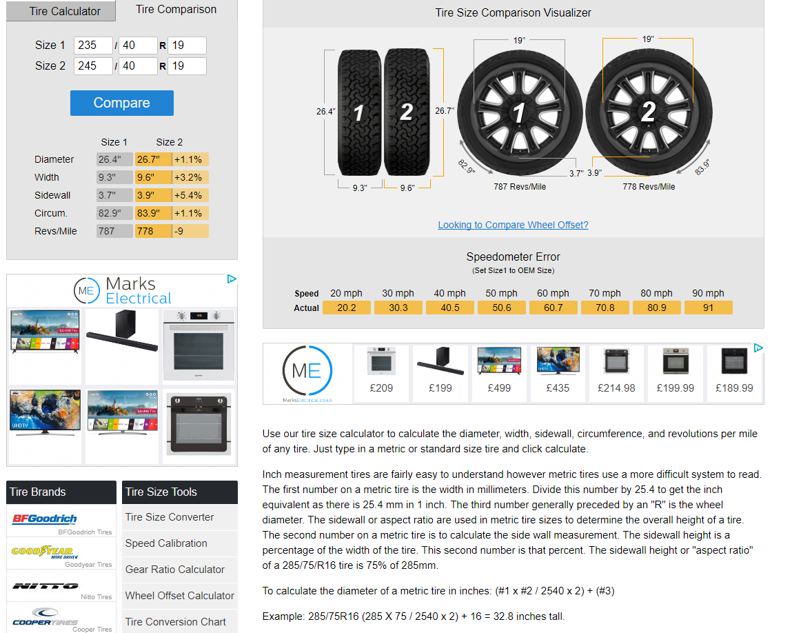

Using the link provided by MartiniB I have entered the tyre sizes, the comparison shows that your Speedometer will under read i.e when it shows 80kph (50 mph) you will actually be doing 50.6 mph.
exactly the opposite,
with bigger tires car's speedometer shows now closer to reality -
+2km(90km/h)
with stock were +~5km, when compared to GPS
+2km(90km/h)
?? The speedo reading doesn't change.:thinking:
Car speedo tells you X miles an hour (whether that is exact is by the by, comparison with GPS is another discussion entirely, not least that it's an average and not real time).
Where do you get +2 KMH @90, the change for the example above is +1.1%?
Change for a bigger tyre and the car will still tell you X miles an hour but with the rolling circumference having increased 1.1% increase will be X+0.6 @50 mph and x+1 @90 mph, the speedo will therefore under read.
It might have been reading on the nail or close, i.e. X=50 mph, before but will not accurately reflect the changed distance per wheel rotation.

@cyberkank The extra 10mm tyre tread width will probably make little difference to handling, you may notice fractionally stiffer steering and increased tyre wear. It certainly won't improve nor diminish braking efficiency.
The reduced circumference of the tyre will indeed cause issues with the speedometer (as already mentioned), odometer, and possibly the ABS based tyre pressure monitor.
The speedometer will read less than actual speed, by about 1 mph at 70 mph.
The odometer will record a greater distance travelled and that difference will only increase over time and distance.
