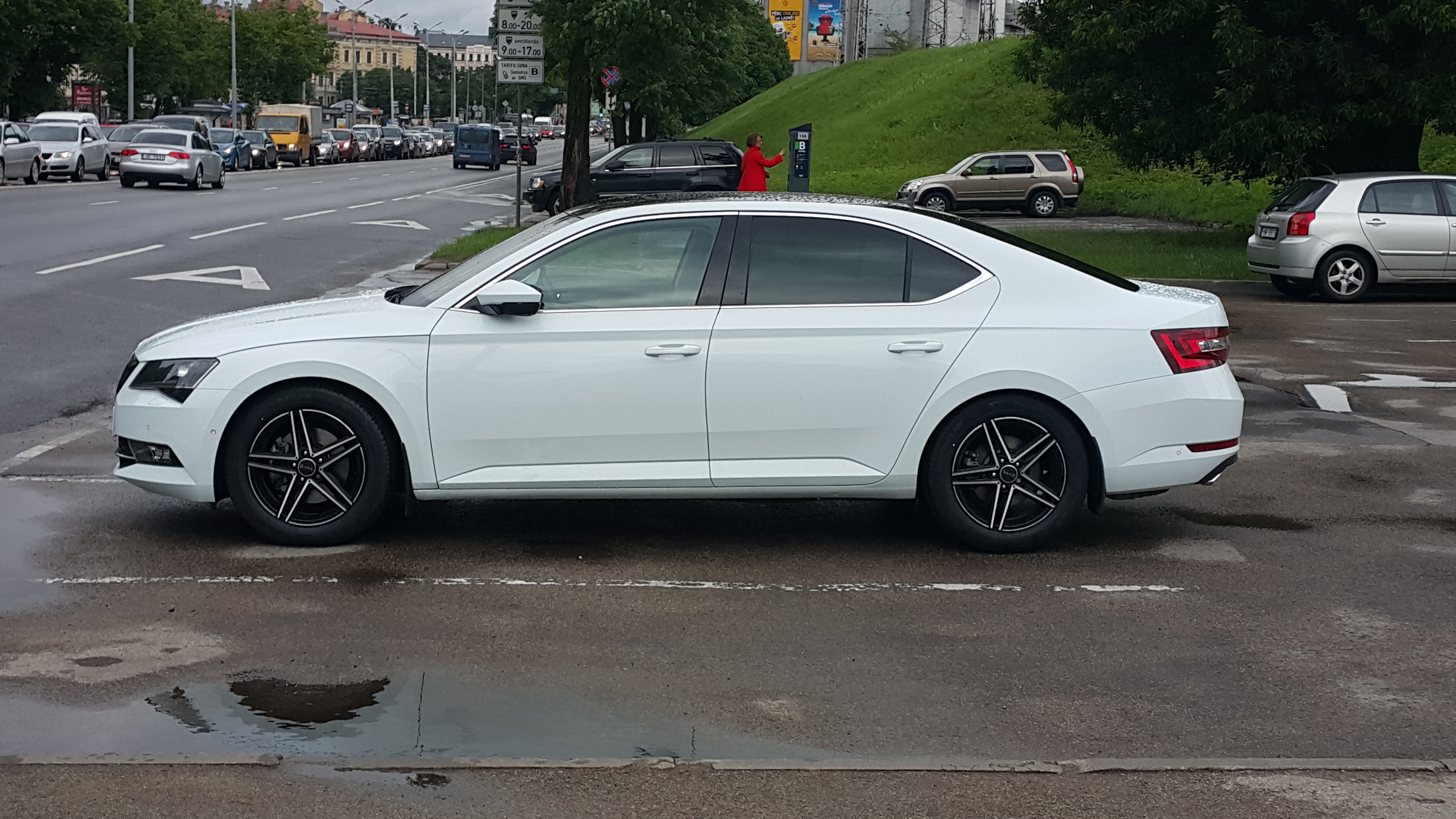

Low frequency boom partly solved by swap tires
from stock
215/55r17 Pirelli Cinturato P7 94W
to
225/55r17 Michelin Primacy 3 97Y
change weren't planed on ~17000km, but one(thank God rear) blew up ..
https://www.briskoda.net/forums/topic/434028-tire-pressure-monitoring-system/
rattles from suspension still not solved, will continue here
https://www.briskoda.net/forums/topic/414829-suspension-rattle-dull-thud-over-uneven-surfaces/

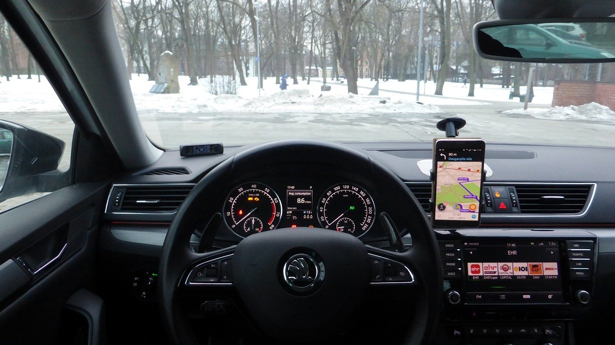

The Columbus entertainment system drove me mad. It randomly dropped the Android Auto connection meaning that I had to abandon Waze and rely on the car’s own satnav. Some of the routes that it took were questionable at best and crazy at worst.
Columbus screen position is far from optimal, i prefer separate phone's 5.7" screen for navigation,
Waze, Google Maps and sometimes both at same time
