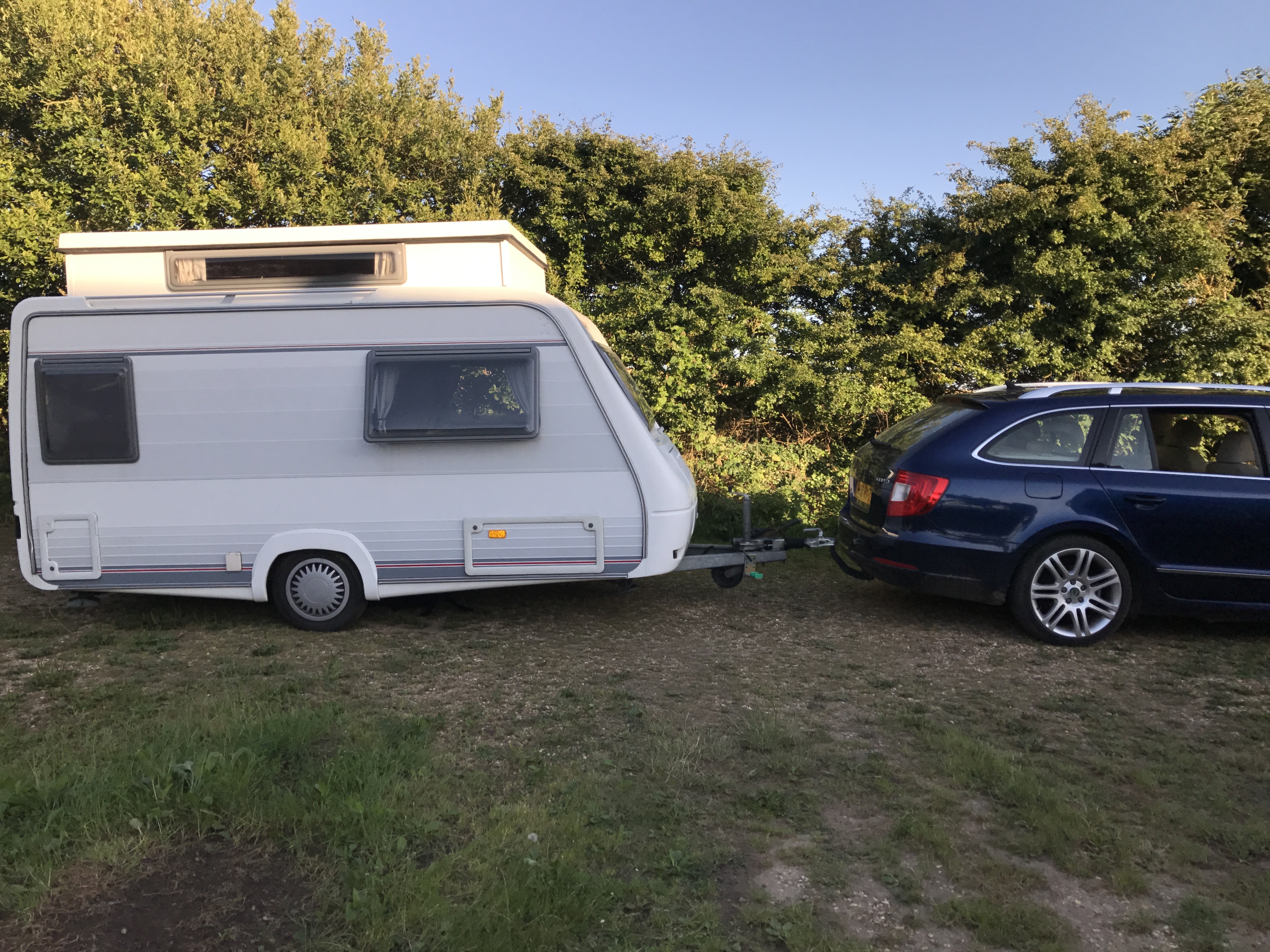

I attach the van and it tilts nose-up.
Does anyone know if it is the van or the car that is the problem?
I have not tried loading the car yet, but that will only make the van level and car nose up?

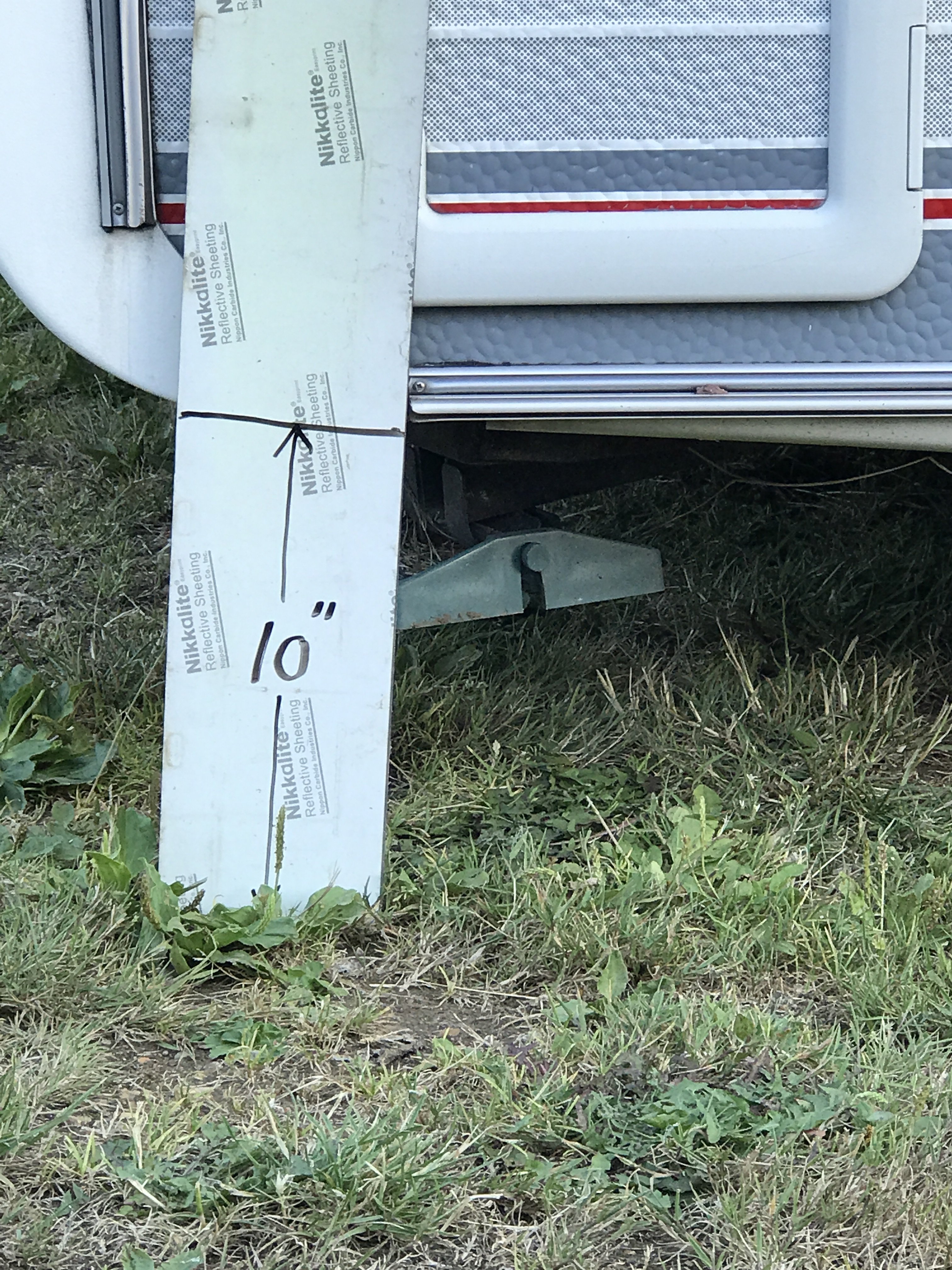

Thank you for your help. I will use this as a guide, but have a look at these photos with neither laden with anything. I have a 4" difference between front and back.  10" at the back corner from the floor - but much less from the corner steadies.  14" on the front corner. It appears I would have to load my car to have the back of it down to pull the caravan down.  I'm thinking I need to change the swan neck set up and put a straight forward normal tow bar and bracket then I could use a drop plate.
Things are different here in 'Straya, but that caravan looks really low to me.  Has the suspension collapsed or sunk?  That wouldn't get into and out of service stations here in AU without scraping.
Hope some of the continental types can give you some advice.
Same thoughts from New Zealand (must be the time zone eh?). The caravan looks low. Your tow bar ball height looks fine to the untrained eye.
My GP tells me that a gradual lowering of ball height can be expected at my age, and I fear your caravan springs are suffering the same 'age related' sagging. I am not an expert though.
Luckily, your springs can be reset to the original height.

It is a few years since I towed a caravan but again my first impression was : -
The caravan looks low. You can't see the top of the wheel by some margin and the jockey wheel is not far from the ground either.
If your van is not "loaded" (weight) then at 19 years old the suspension has had it.
Edited by Danny 57
Our van is slightly nose down if anything with a Westfalia swan neck. I think the 'van ride height is low.
Caravan does look low and suspension needs checking almost certainly.
You can get that jockey wheel higher than that can you not?

Looking at the many photos on the net of this van, they all seem to be very low with the nose high when mounted on the car. Perhaps it is a feature of this van?
I agree with Pesmog. Looking at this video your wheel height seems normal and seems to show the nose up a bit, certainly the horizontal stripes seem a little off with the scenery horizontals.

nb - Ref the picture of your setup, could it be the van tilting up slightly is exaggerated by the car tilting slightly downwards - or is that a lens aberration?

I had exactly the same issue with my 2007 Octy2 Scout with a dealer-fitted Westfalia towbar that has a bolted-on swan-neck ball. Towball height 510mm. Van hitch height 360mm. Caravan is a very similar Trigano Silver 380 poptop. The ride height of the van looks just as low but it has new suspension so that's just how it is. Before mods it towed very nose high and was quite unstable even with a supplementary stabiliser bar fitted.
Have fitted hitch spacers - 160mm long 4"x2" box steel tube with anticrush tubes and new hi-tensile M12 studding and locknuts. Just like adding two 2" Towsure spacers on each side between the hitch and the drawbar frame. Those don't appear to have crush spacers though, and the bolt holes were the wrong spacing for my Alko hitch. Before and After pics to follow if requested and I can figure out how to attach them!
It has made such a difference to towing stability that it's like a different van now its nose is 4" lower. There are no issues with jockey wheel ground clearance but that may be the Scout's higher ride height.
