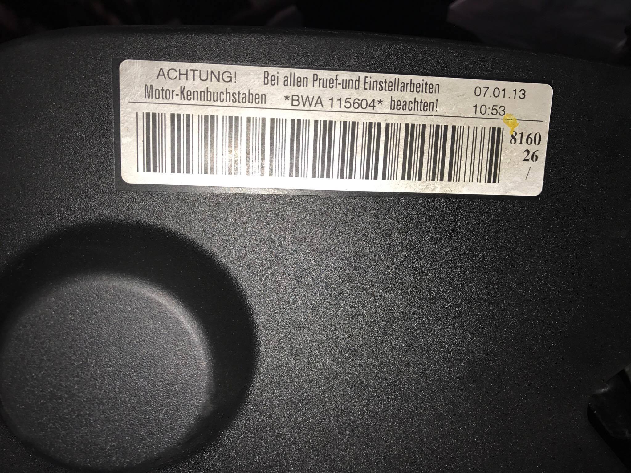

So! The label says this (on new engine):
20472360_10211880125095346_1258513380_o.thumb.jpg.f24c3111661244f595030403bfae053e.jpg
Same issue? :)
Possibly, no one knows, how it looks inside ... TPI is clear, they could be 100% sure with piston rings from BWA 219 337, little less then already from BWA 202 030 as of 12.11.2007.
Edited by rayx
