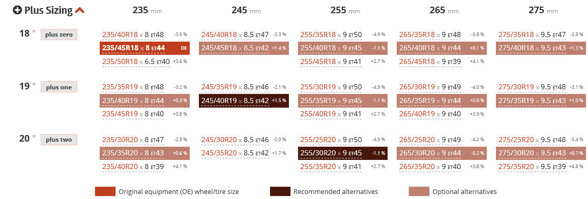

officially the superb can handle 20" rims.
more details here.
235/45ZR18 94W     8Jx18     ET44 5x112
235/40ZR19 96W     8Jx19     ET44 5x112
245/35ZR20 93Y     8.5Jx20  ET40    5x112
Not sure what to say, what makes it official? And why put 255/30ZR20 for the 280 and only 245/35ZR20 for the 220?
Btw, their calculator even suggests a 275mm tire :)
I am referring to the fact that 20 inch wheels are heavier than 19/18/17, and (you can) feel it in the way that the car is accelerating.
If you want to squeeze every bit of your car, you can consider this. For everyday use... i think its not the case.
