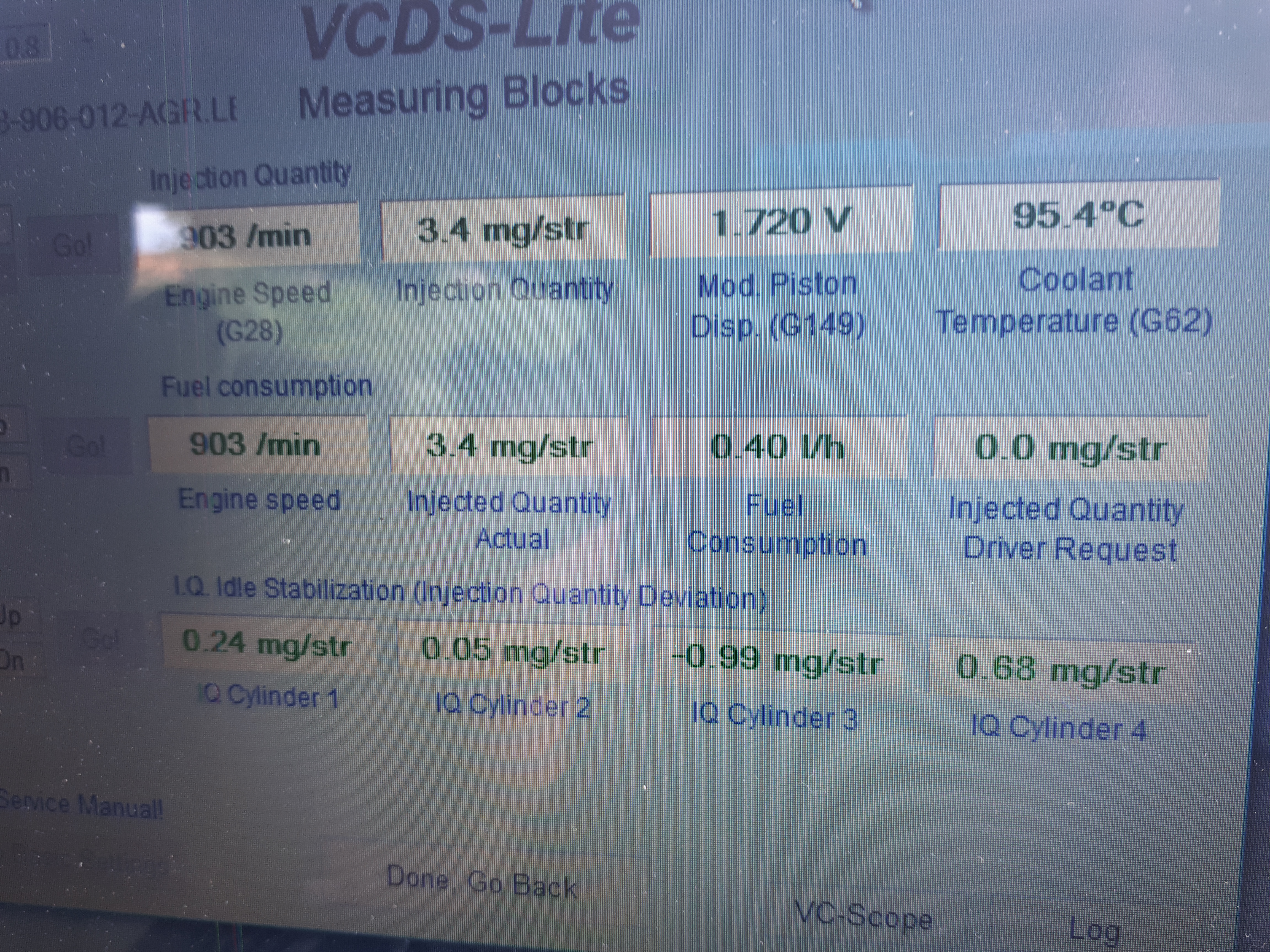

I have also noticed it sometimes has loads of power but other times none as if in limp mode but no fault on the vcds I can turn ignition off then back on but it makes no difference, So today I had a play on the vcds measuring blocks and found injector quantity deviation the pic is the results      Cyl 1 = -0.05
Cyl 2 = -0.05
Cyl 3 = -0.47
Cyl 4 = -0.42    engine speed 903/min
Does this mean that two of my injectors at way too far out (broken) or is this normal any help would be great thanks

Oh and IMO those deviations look ok, looking from the coolant temp the engine was not at operating temperature either and in my experience that can make a difference to these values

Hi this is the vcds blocks when at norm temp
