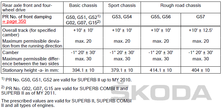

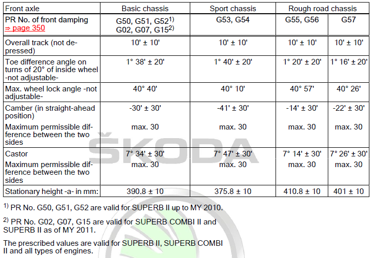

This is the geometry information from Skoda's service manual:
front_suspension_settings.png.801d6eed915bee33422c1c3ed0024f35.pngrear_suspension_settings.png.5570f51965fbf40b4ea023aae7b38d8e.png
The stationary height is the ride height and is measured from the centre of the wheel to the top of the wheelarch. You will need to know what the PR code for your suspension is, but this should be printed on the build label inside the spare wheel well, and/or the service book.
The following note is mentioned regarding loading: "Technical data apply for the unladen weight of the vehicle ready for driving (full fuel tank and water reservoir for the windscreen wiper washer system, spare wheel and jack (if the vehicle was fitted at the factory with them), tool kit and without driver). The spare wheel, tool kit and jack must be located in the position prescribed by the vehicle manufacturer."
As far as I can tell, the manual does not give any guidance on when replacement is required. The specifications above allow tolerance of +/- 10 mm - one could conclude from that that any sag beyond 10 mm would be an indication that replacement of dampers and/or springs is required.

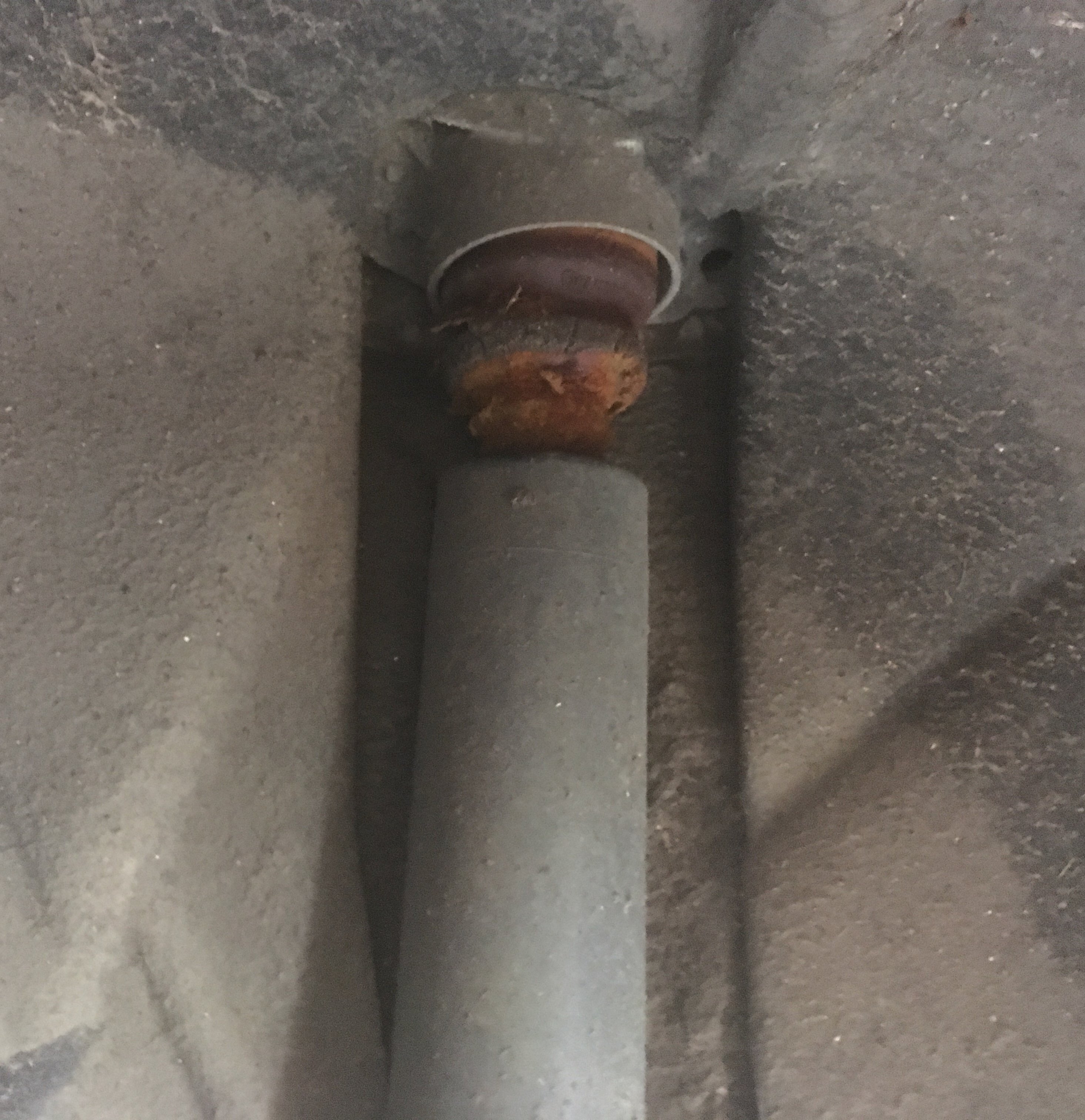

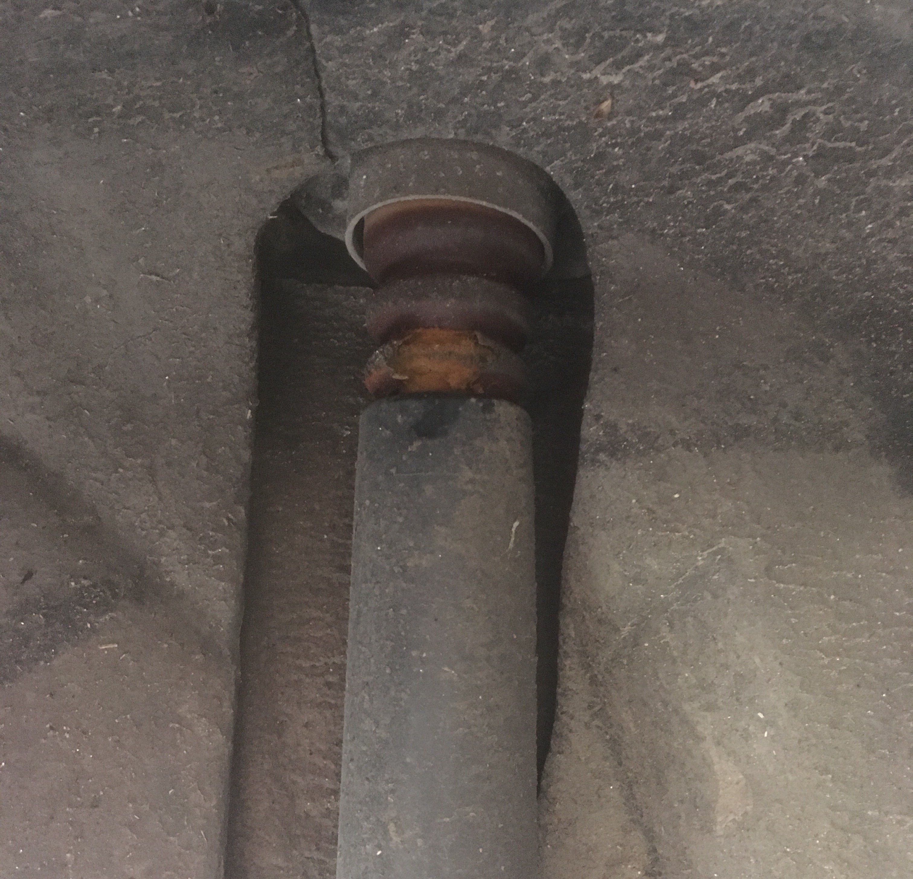

Hi guys, I refurbished my wheels the other day and noticed my rear shocks rubber has perished. My car does ride lower at the rear but seems to handle fine. Any ideas? Should I replace the shocks? It has not long passed its MOT and they didn’t mention it...
That’s just the bump stop, a separate part and cheap.
Cheers Tech1e, can I fit new bump stops without having to remove the shocks do you know?
If you can get the damper rod down far enough once the top nut has been undone you may be able to slide it off, never tried as replaced my Fabia shocks so had to remove them anyway and fitted new ones prior to refitting. Mine were gas filled and you will struggle so easy enough to just remove the shock. You won’t notice any difference with a new one though, it’s for damping the pothole impact, not functional otherwise.
It won’t do anything to your ride height.
It won’t change how bouncy the back is.
I would leave it until changing the shocks.
One thing to bear in mind is that all the bolts on the suspension setup are single use so you will need to have replacements on hand when you are doing the job.
Thanks for that, sounds like those bump stops aren’t that important so might just wait till the shocks need replacing and do it properly
