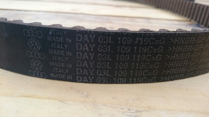

Just had my timing belt, aux belt, water pump and all the tensioners and pulleys changed on my 2011 1.6tdi octavia...  Approaching 70k miles.
They are all like brand new for info, not so much as a crack on either belt or weep on the pump, or wiggle on the tensioners.
I know it's always the worry and what if scenario if you shoot past the service schedule date which is 5 years... I'd already gone over on time and mileage by a bit, but I was confident that that was okay as I'd inspect the belts regularly to see if anything dodgy.
Just a quick post to let you know that 6 years and 70k miles doesn't take as much toll as you'd think on your belts etc, which for info are made by Dayco and branded as both dayco and VW /AUDI.
I also realise no two cars are the same!
15012279115310.jpg.e8ceaa95271318a3593924e2d688212d.jpg15012279116381.jpg.4fc91c3cece863dc57abbb90d290b548.jpg
