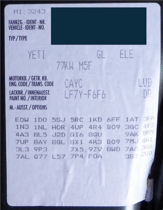

Any Skoda dealer should be able to tell you if they were part of the original build of the car, I cannot see a Skoda dealer retrofitting one.
See if that build option code is on the build paper sticker under the carpet in the boot on the nearside.
