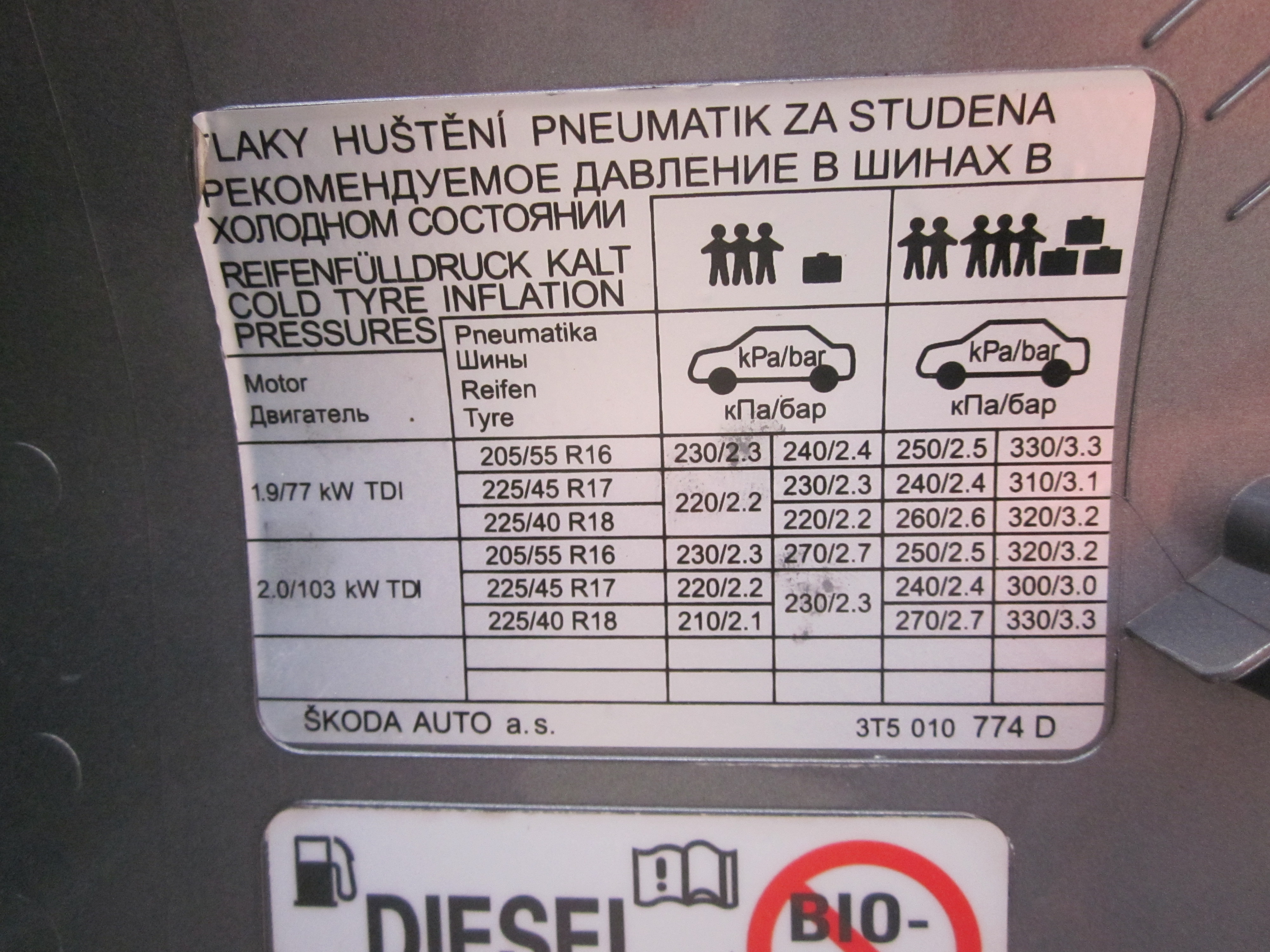

Go for 17's with 50 profile tyre.
A good balance between comfort, pothole resistance and filling the arches...
Available options...

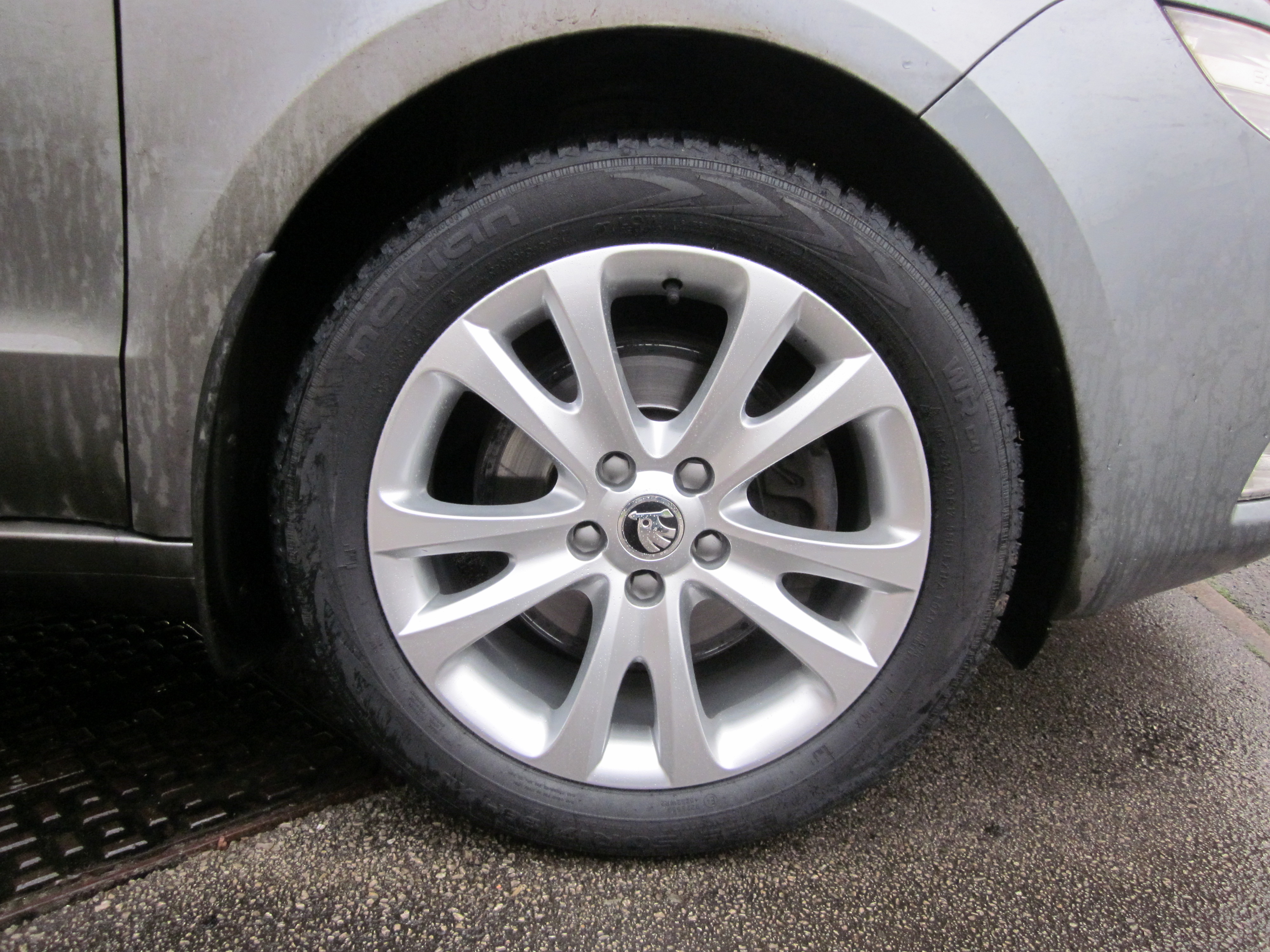

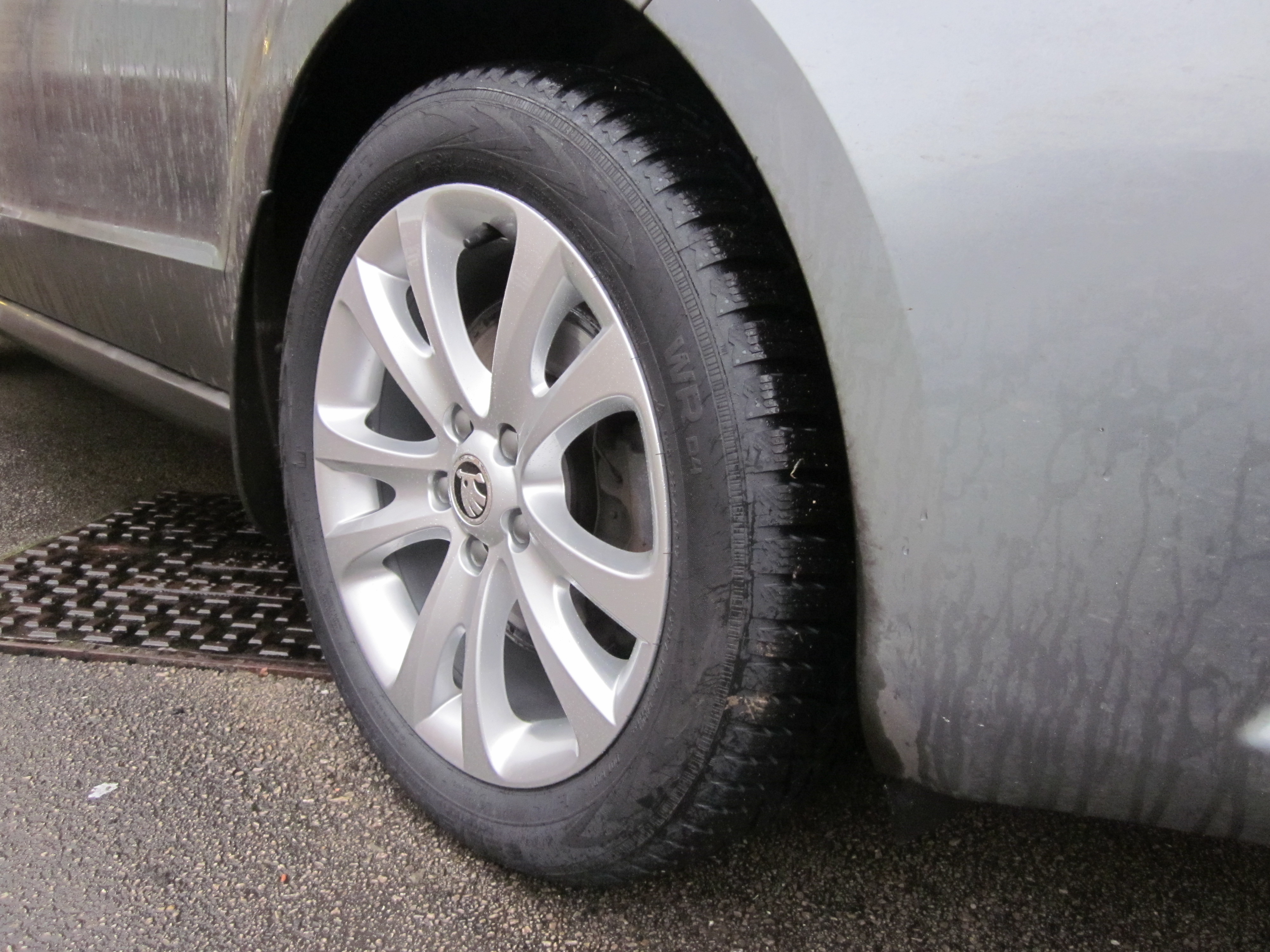

  • On my previous Superb I loved the ride and struggled with the MKII on some test drives but found the ride OK on the  1.4tsi S which has 205/55 R16s (although the light 1.4 may have helped!). My commute involves some rather bumpy roads though - I prefer to take my replacement car test drives over part of this route.
  • Long tyre life seems to be a feature of this size/profile - got 32k miles out of a set of Michelins on the Superb I and 35k out of a set of Continentals on the Superb II.

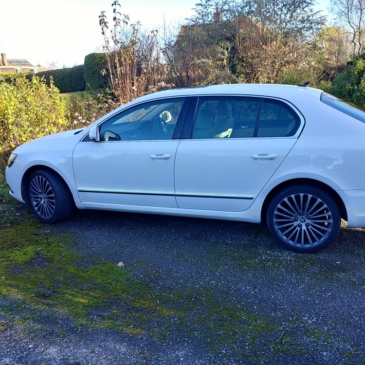

The L&K 18" wheels are beautiful... but ..
I have already replaced two due to pot hole damage and also one tyre that was a month old.
wheel refurb centres want £130 for repairing them and then they are just going to spray them silver and grey which defeats some of the point of having diamond cut alloys.
This size of wheel/tyre is wholly unsuitable for the roads where I am and probably most of the country where chicanes, humps and road narrowing are done in priority to road condition.
The ride is not awful with them on but is nicer with 16" wheels.

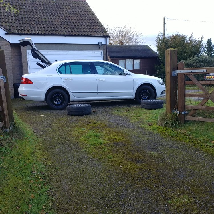

I purchased a set of 16" steel rims for winter use and have them on for six months of the year.
They look horrible in comparison so if you can afford to spend £175 on new rims as needed then stick with the 18's

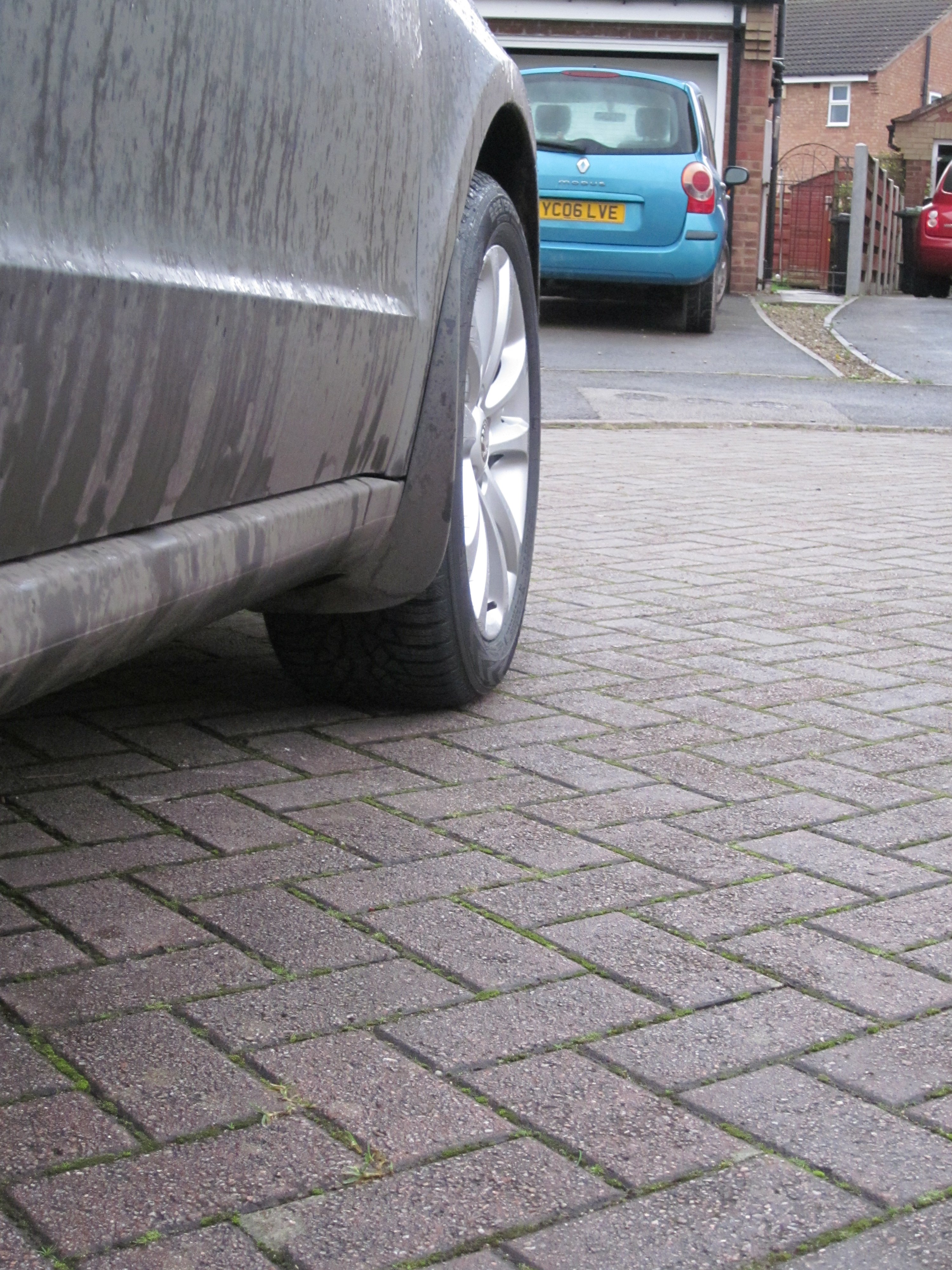

Very much agree with Silver1011's comments above re the 17" wheels.  I think they are the optimum size for the MKII Superb.  I had 17" on an Elegance and 18" on an L&K and the 17s were that bit smoother.  Having said that, an L&K without 18" wheels just won't look right.  As a compromise, I did put on higher sidewall tyres with a 45 profile when I had the 18s (when it came to replacing the first set) and it brought the ride back to the same comfort level as the 17s.
I had considered the 45 profile but the 16" is a factory option (as is 17") but 45 profiles are not.
Thanks - great info

I had reservations on the 18"s when I first bought ours. Two years on I concur the ride is good, tyre prices OK, and no further damage (one wheel was slightly out of round when we bought it, from hitting a pothole). If I had the choice I'd go for 17"s though, mainly for cheaper tyre options and less risk of damage. 16"s migh be OK if you lived on winter tyres, or if there was no tarmac in your neighbourhood.
I've had 16", 17" & 18" on my Octy and if I had the choice, I'd go back to 17" with a slightly higher sidewall.  16" are my 2nd choice but they need to be 7.5-8" width
