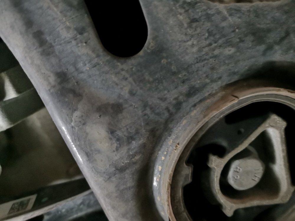

Now I need to get under there and work out what one I have now so I can get the right bit.

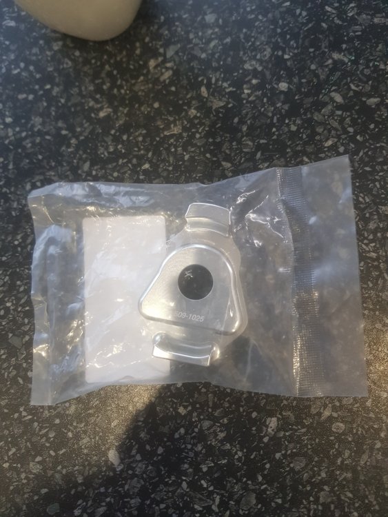

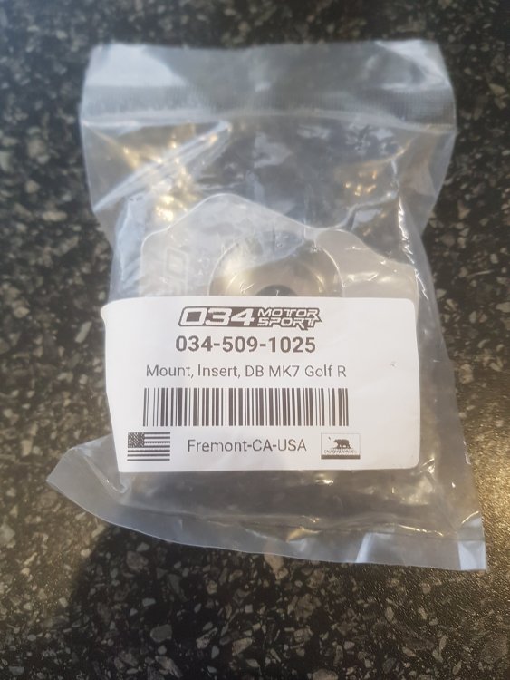

I bought the 034motorsport one and i'll report back on the fitment and if theres any rattle, i expect more rattle as its a diesel but its noisy enough with the crappy tyres i have. I would love to fit the replacement dogbone arm and mount but was advise against if its diesel as it makes it way too noisy at idle.

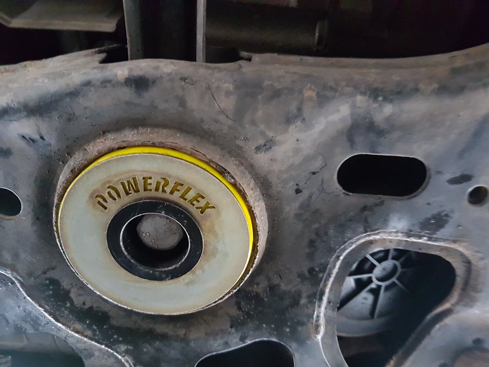

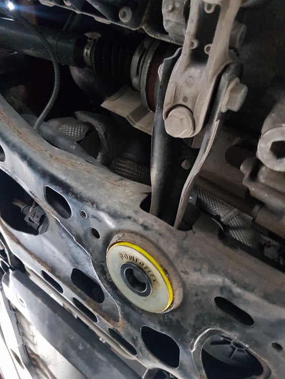

Ok just fitted the powerflex yellow add in torque mount this morning.
Goes in fairly easy but a bit stiff for the last 20mm.
I ended up easing it in with the aid of the car jack and a block of wood. Its a 21mm socket not 22 as some guides have said. Had to pack out the socket with paper so I could push the bolt up and then get a turn on it to get it started. the insert was just holding everything apart.
First impressions are it's a bit throbby at idle, a deep rumbley throbby note that is very pronounced  at idle and in reverse. I am hoping it calms down a bit as it wears in after a bit of use.
I went for the yellow one but there is a red one that's supposed to be a bit softer. I suppose I can always change it if it doesn't calm down soon.
Performance wise  I haven't  had much of a chance to fully test it. But so far no irritating axle tramp bangs as yet. So it's got a thumbs up from me and it does feel more sporty and powerful, the engine sounds a bit louder because of it.
