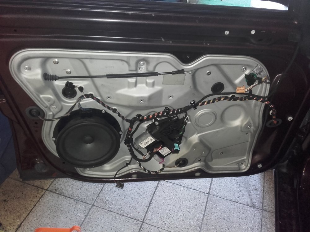

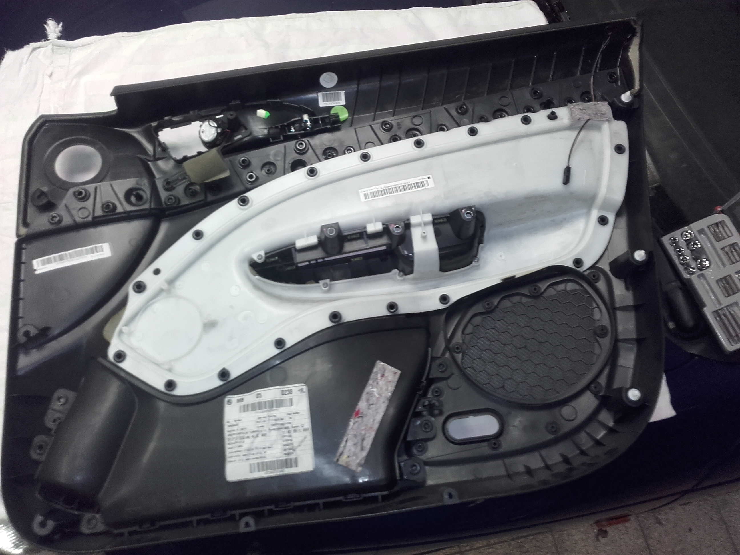

I had to remove my (A5 FL) LHD car's front left door trim due to some annoying noise.

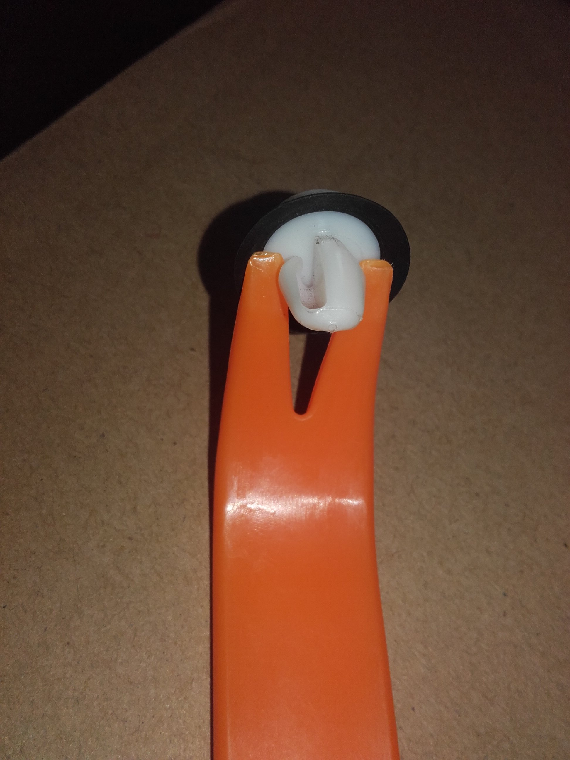

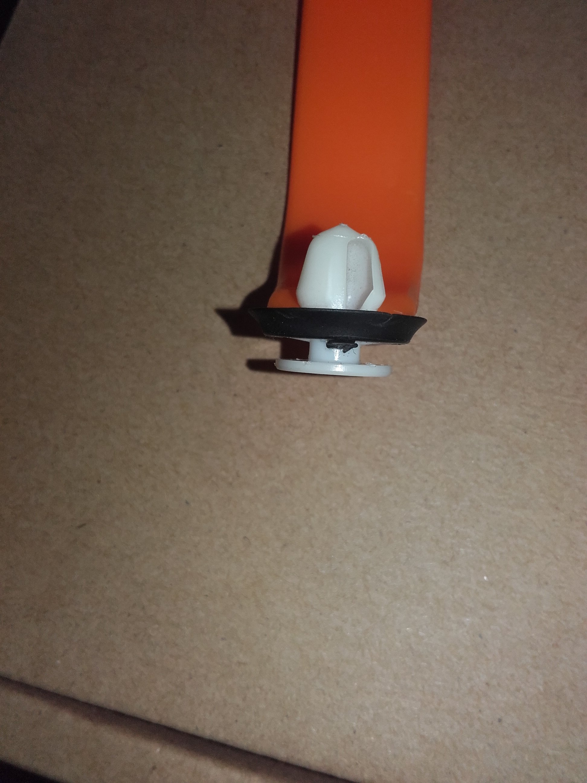

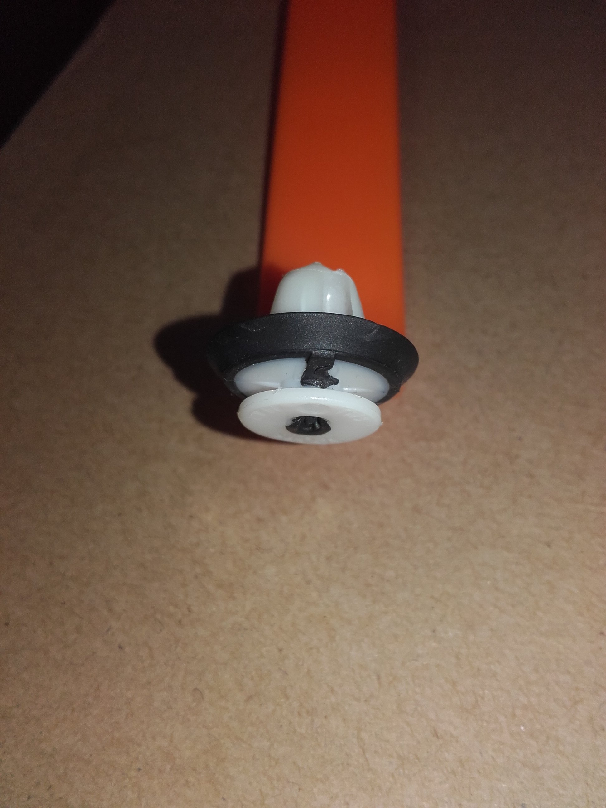

The wire to the door led took loose, after I fixed it with duct tape, the noise was gone. I also repaired one broken plastic clip on the inside of the door trim with hot glue. Here are some pictures I took as reminder, hopefully someone else can also use them.
You can also see how to orientate the removal tool for the tiny plastic trim holders (to not to break them).
