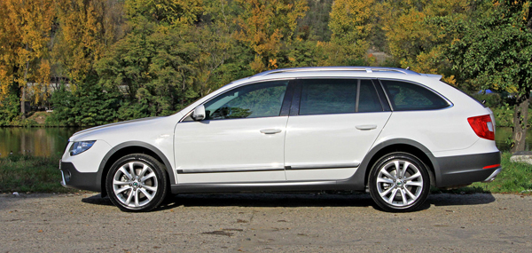

Your best bet would most likely be springs and shocks from the elusive Superb Outdoor (Superb equivalent of the Octavia Scout/Passat Alltrack)
