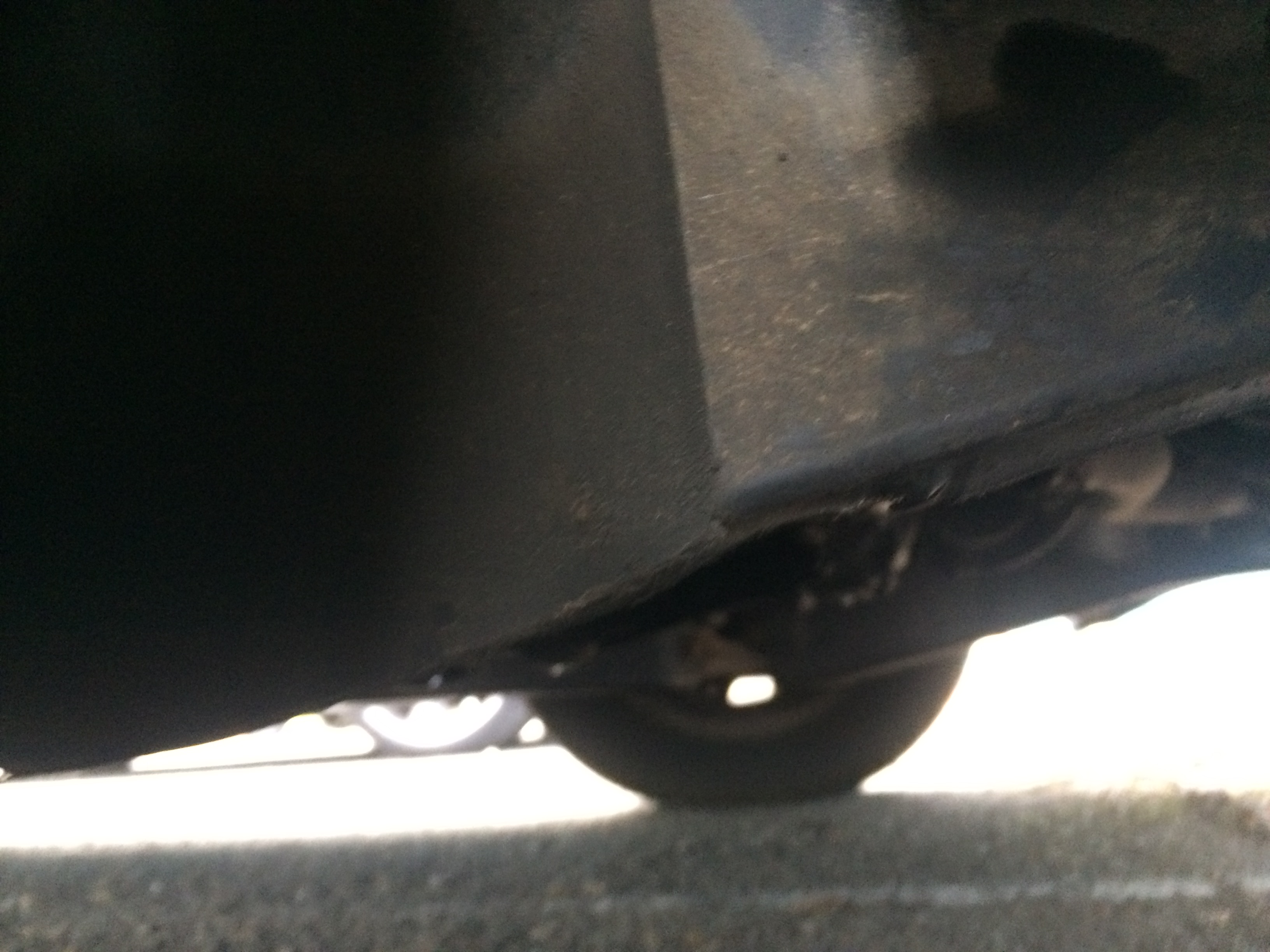

Took this rubbish photo this evening of the part of the bottom of the buggered plastic bit, think you are right that it's the arch liner
NO Pic.
MY phone, like my car, is broken

It worked! Rubbish photo though

Isn't that just the 'captive nut' bit (item 3 in TMB's parts pic above) having slid off, rather than anything more drastic?
If it is just this, a replacement captive nut thingy will be about 50p I should think, including VAT! Hang on while I find the part number.

I don't think it's part three that's just come off. The plastic the under tray screws to has bent out of shape (i.e. I couldn't screw it back on, and the undertrained wouldn't move back into position to screw it in
