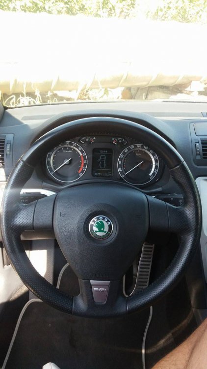

Hi their I own a Skoda laura l and k 2008 . I upgraded it streeing wheel to the facelift version of 2009 .
  I completely changed the streeing wheel with the control module now I have problem with mfd switch as in 2008 it comes on the wiper switch but in 2009 it is operated with streeing it self . So the mfd doest work now. I have tried the control module to be coded with the local authorised dealer . It's says control module falutly.
 So I thought of replacing the control module with the old one the stock streeing module the mfd work but the horn and the volume control doest work . Pls help me out with this . Thanks in advance
