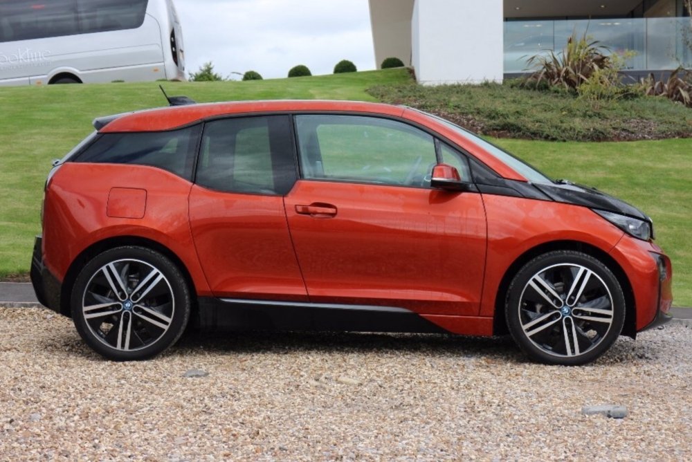

Swapped an R32 for the Yeti. Sometimes think of getting another but must move on. New BMW i3 is looking promising. Keep the Yeti as a long distance runner. The i3 is certainly very different which appeals.
