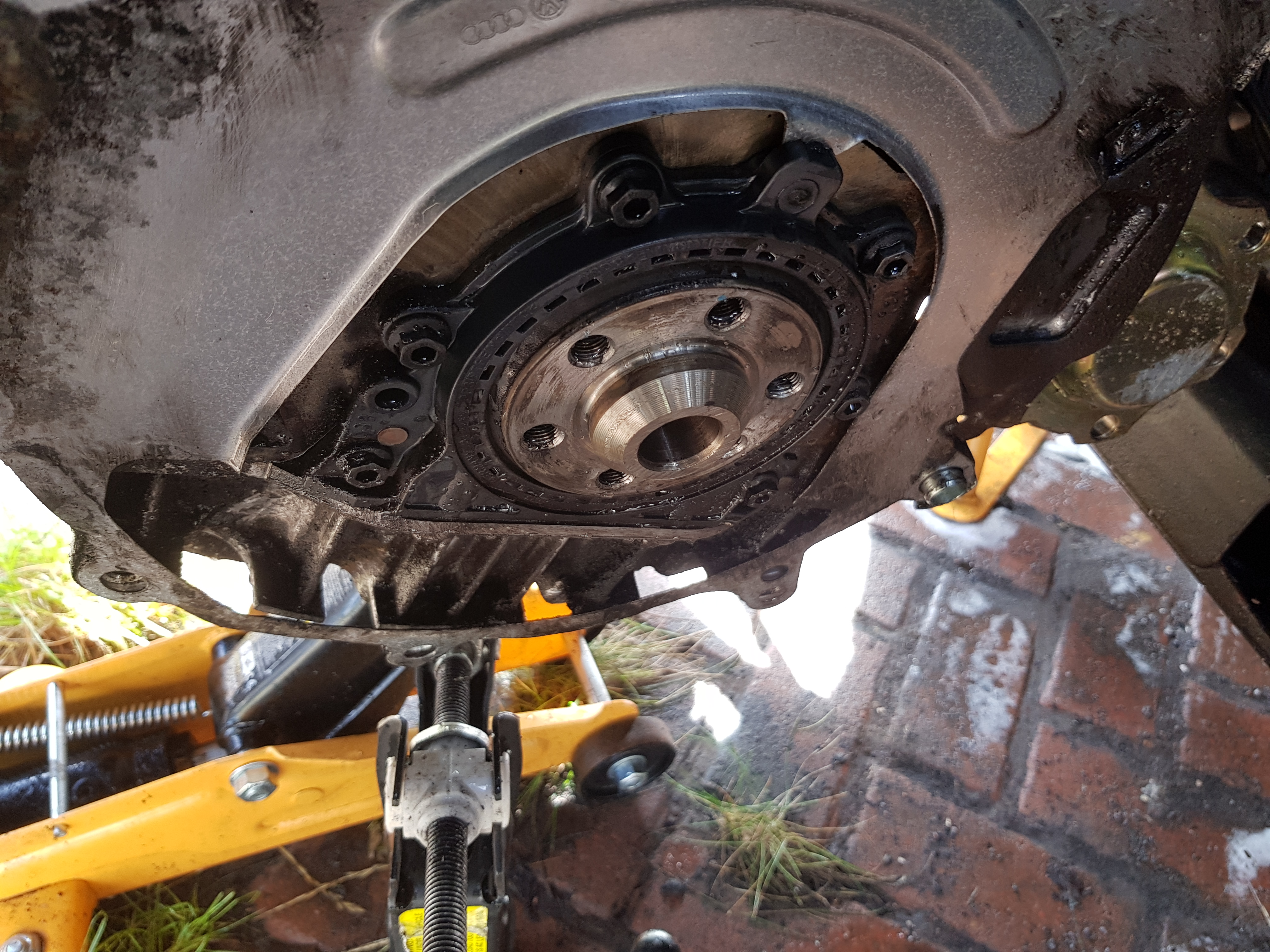

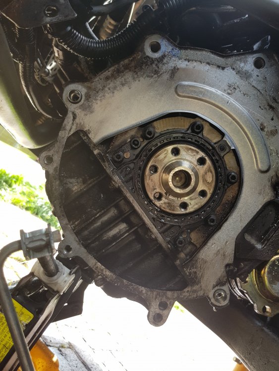

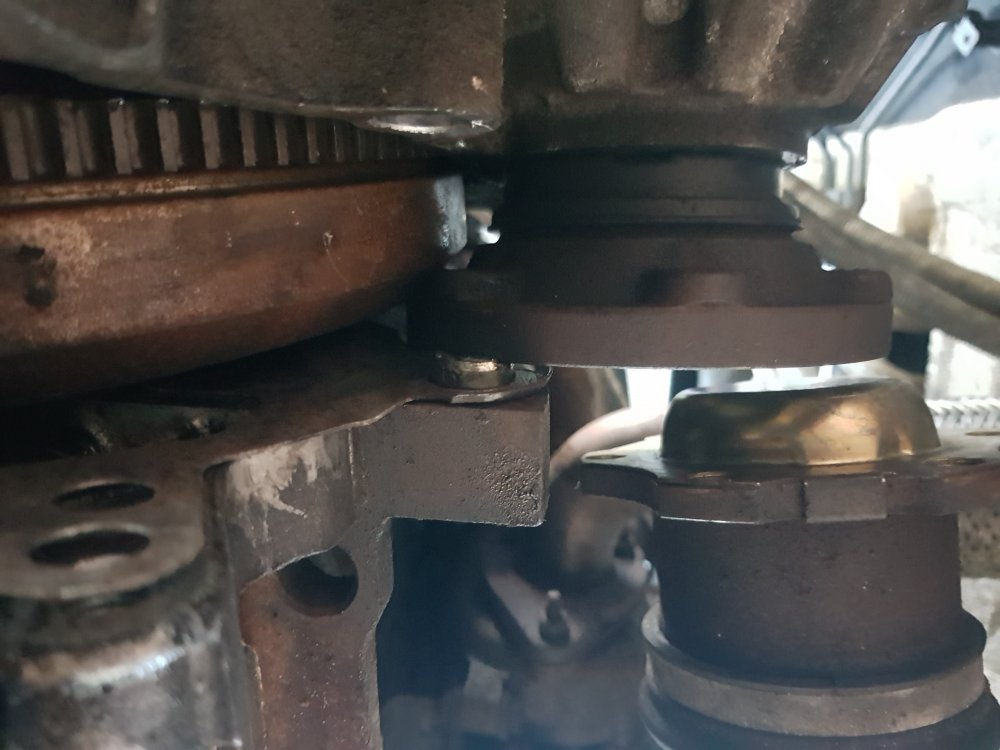

Managed to remove the flywheel, cant really tell if the oil is coming from the sump seal or the rear crankshaft seal (idk if thats the right part).
I would say the crank seal because it's under pressure rather than the sump where it isn't and would tend to just run down and not spray about, how bad is the friction plate, does it look varnished?
I agree, the sump leaking wouldn't get flung around like it has been doing and probably wouldn't have ruined the clutch.

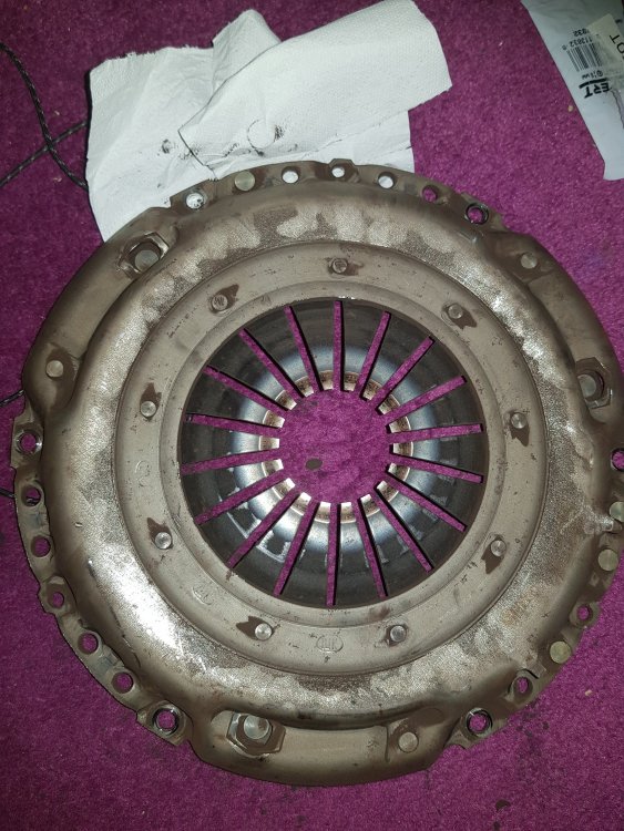

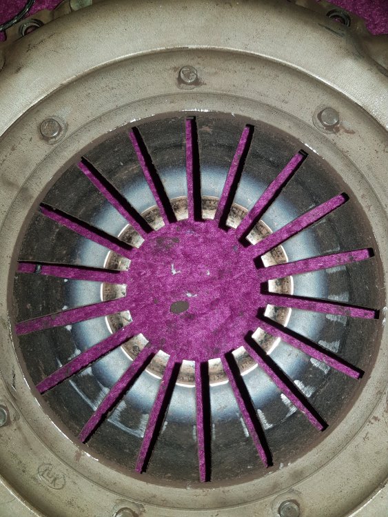

Friction plate looks okay too me, but this is the first time ive changed a clutch.
That's the pressure plate, I'd fit a complete new clutch if I were you.

Easy, gently pry the old one out, clean everything up, lube the new seal and gently tap it into place with a soft-faced mallet by tapping all the way round it until it's completely seated.

Thanks for that, I presume the flywheel bolts onto the flange thats in the pic of the engine ? Is it the same clutch on a 2007 VRS SE ?
Yeah thats where it goes and also it had a single mass flywheel, ive got an image of it somwhere ill post it when i can find it.

Looking at the parts catalogue, it seems the seal itself (item 14) isn't available, you buy the seal plus flange (item 15, 06A103171A), which might be even easier to replace.
What year's the car? Just change the date at the top of the linked page to check the part number is right for yours.
Oh my bad haha, yeah the plan is to change the clutch but im worried something else caused it too slip as it didnt look too worn down however it was slipping like mad before i took it off.
Just dont want to put it back together and find that the clutch starts slipping again.

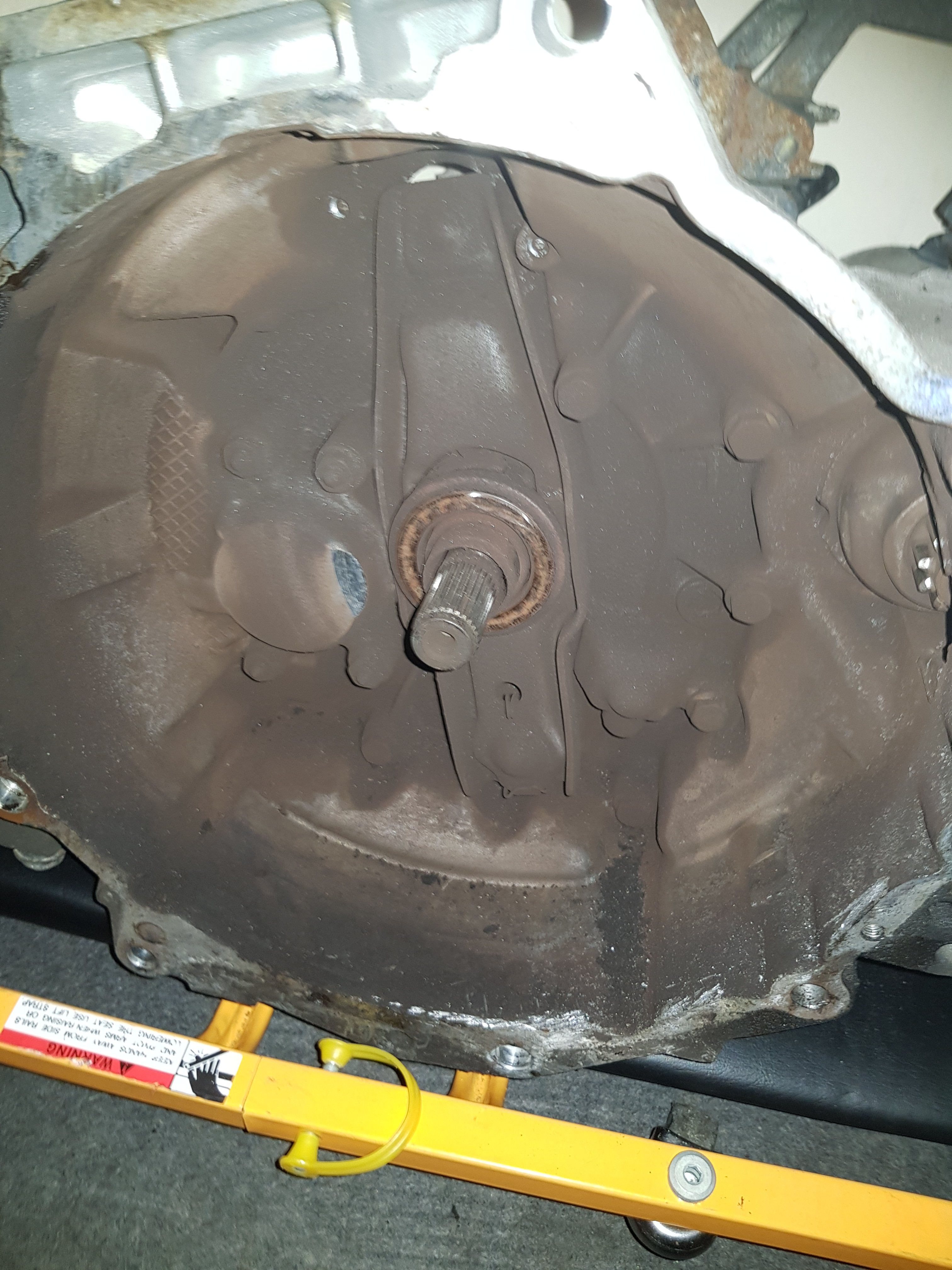

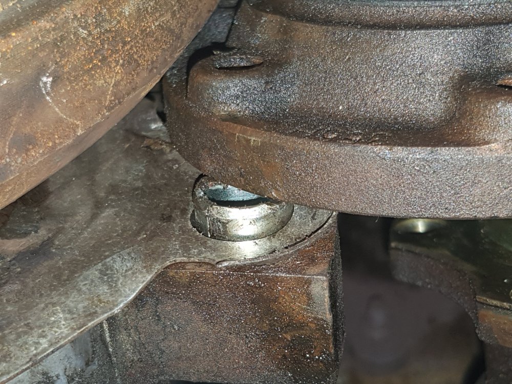

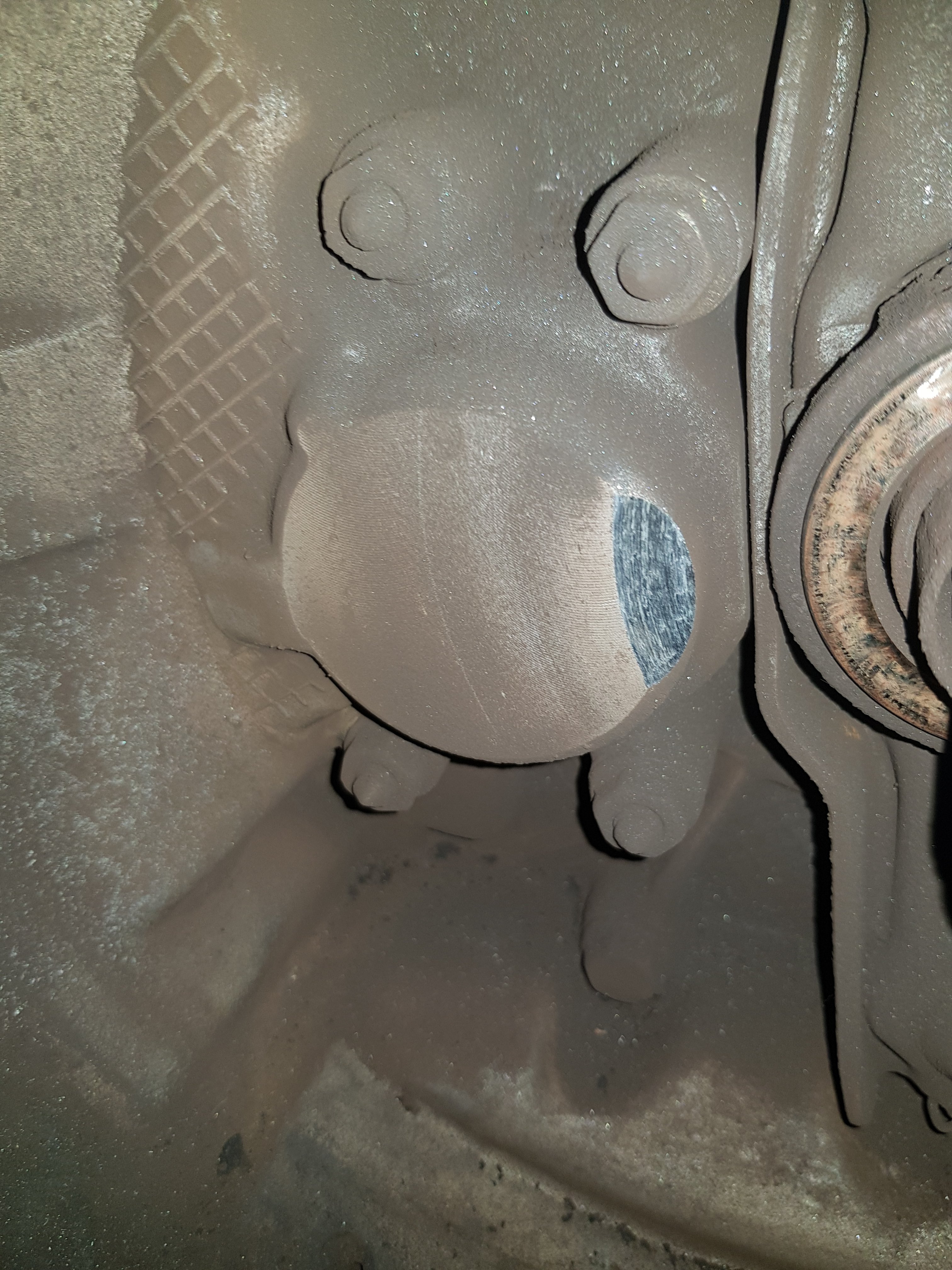

Also is this normal?
  • Sponsor
I'd go with no.
If its a case of unbolting the seal with the carrier and putting a new one on it shouldn't be hard to change.
Looks like you have had a rub in gearbox. Can you determine which part has been rubbing from the clutch parts you have?
Yes, easier by far, however the pressure plate rubbing the gearbox casing has to be caused by excessive crank endfloat which has probably also caused the crank seal failure. So we're dealing with a more complex issue here. I assume the thrust washers are built into one of the main bearings rather than separate which rather suggests the engine has been oil-starved at some point.
