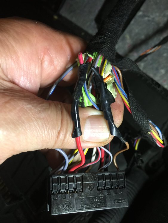

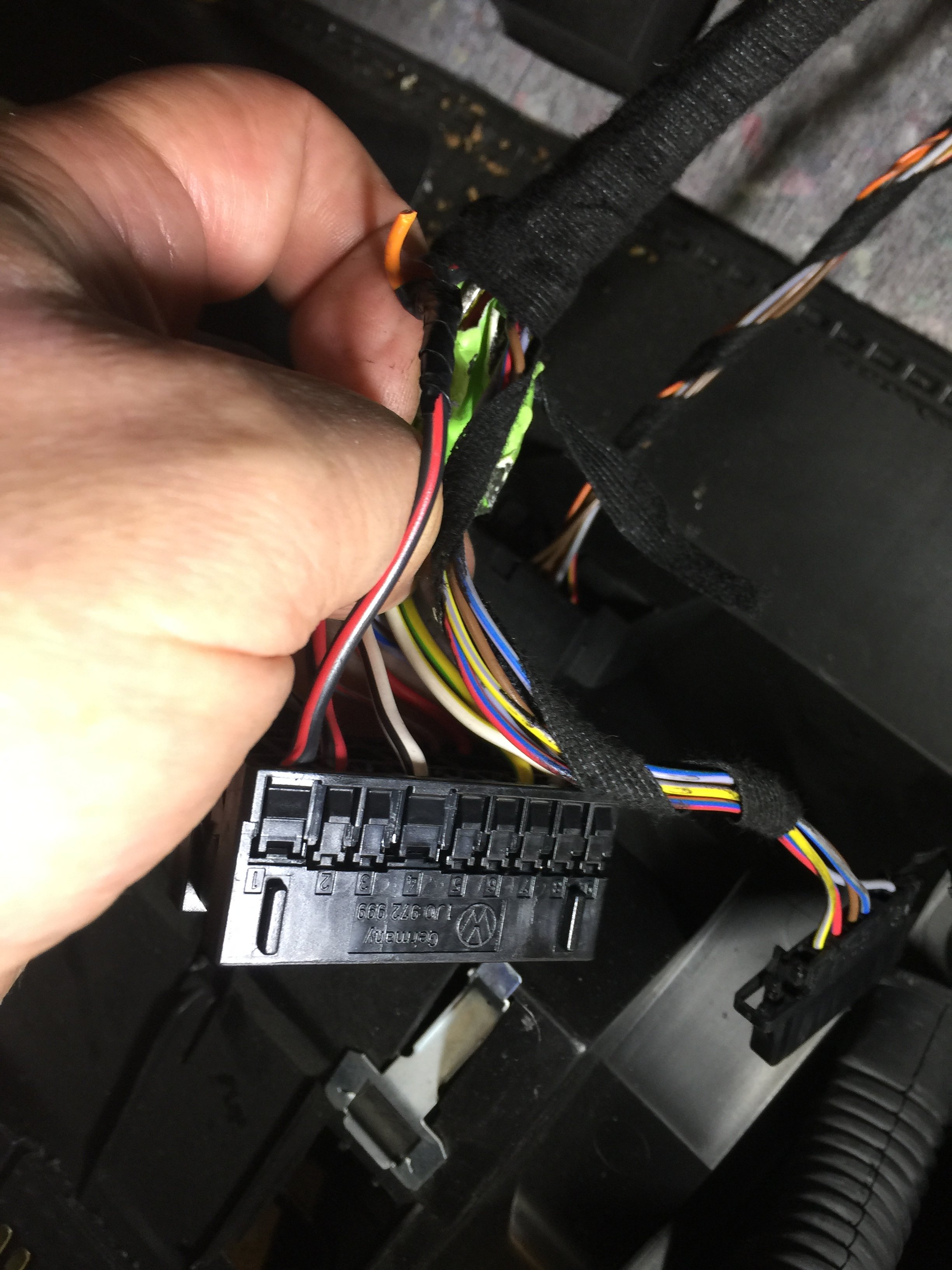

Got a quick question about the connector on the Headlight switch. Some wires have been added to pins 1(Black/Red),10(Brown) & 13(Red). Am guessing one is a live, one is an earth, but what does the other one do?
Any ideas?
Looks like what mine did when an insurance black box was fitted. Yes I think its live, switched live, and earth
Brilliant!. Thanks for that, just did a probe check & your bang on.
