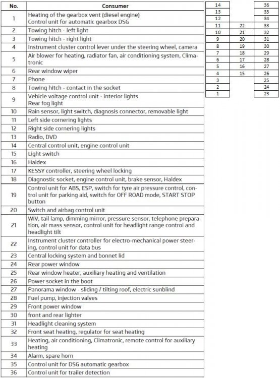

The one at end of dash shows "13 Radio & DVD", second down from top on left.

I spent a happy half hour a couple of weekends ago pulling fuses from the dash-end fuse box (trying to rule out confusion between a LHD fuse panel description in the manual and a RHD car) and none of them stopped the radio.
Does this help?
Amongst others, I've pulled out 13, 25, 2 and 24 in case the fuse box is upside down or mirrored or something but the radio carries on :-(
The only one that's stopped the radio is the under bonnet fuse :-(
You could check the wiring diagram on https://erwin.skoda-auto.cz, that'll confirm exactly which fuse should do it...

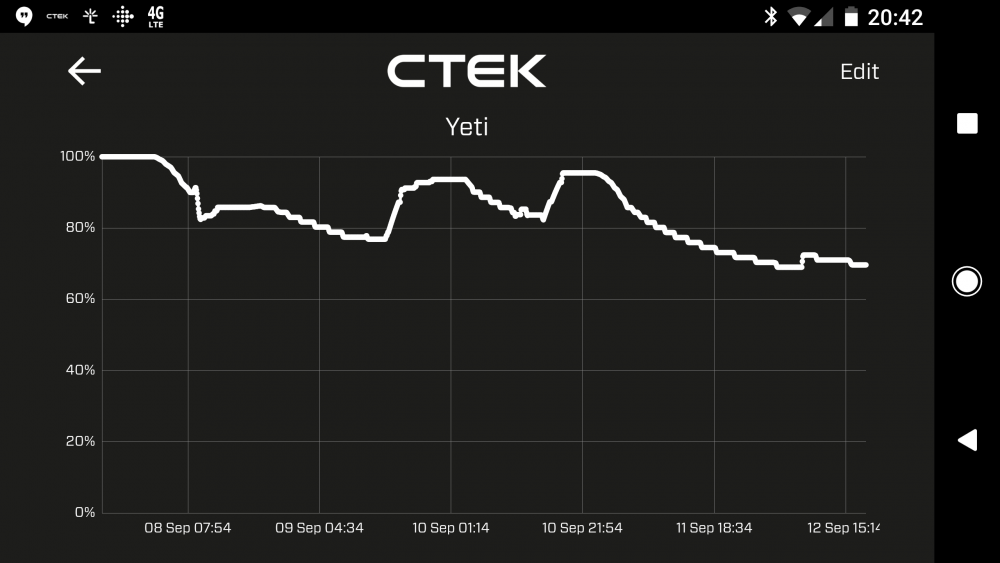

The don't necessarily suspect the radio (or may be i do), but as others have had current draw problems with the radio I'd at least like to rule it out.
At the moment the moment the main diagnostic tool is the CTEK battery sensor (which allows me to check the battery status without opening the bonnet or doors etc)
You're sure it is a current drain and not a bad battery or cell?
