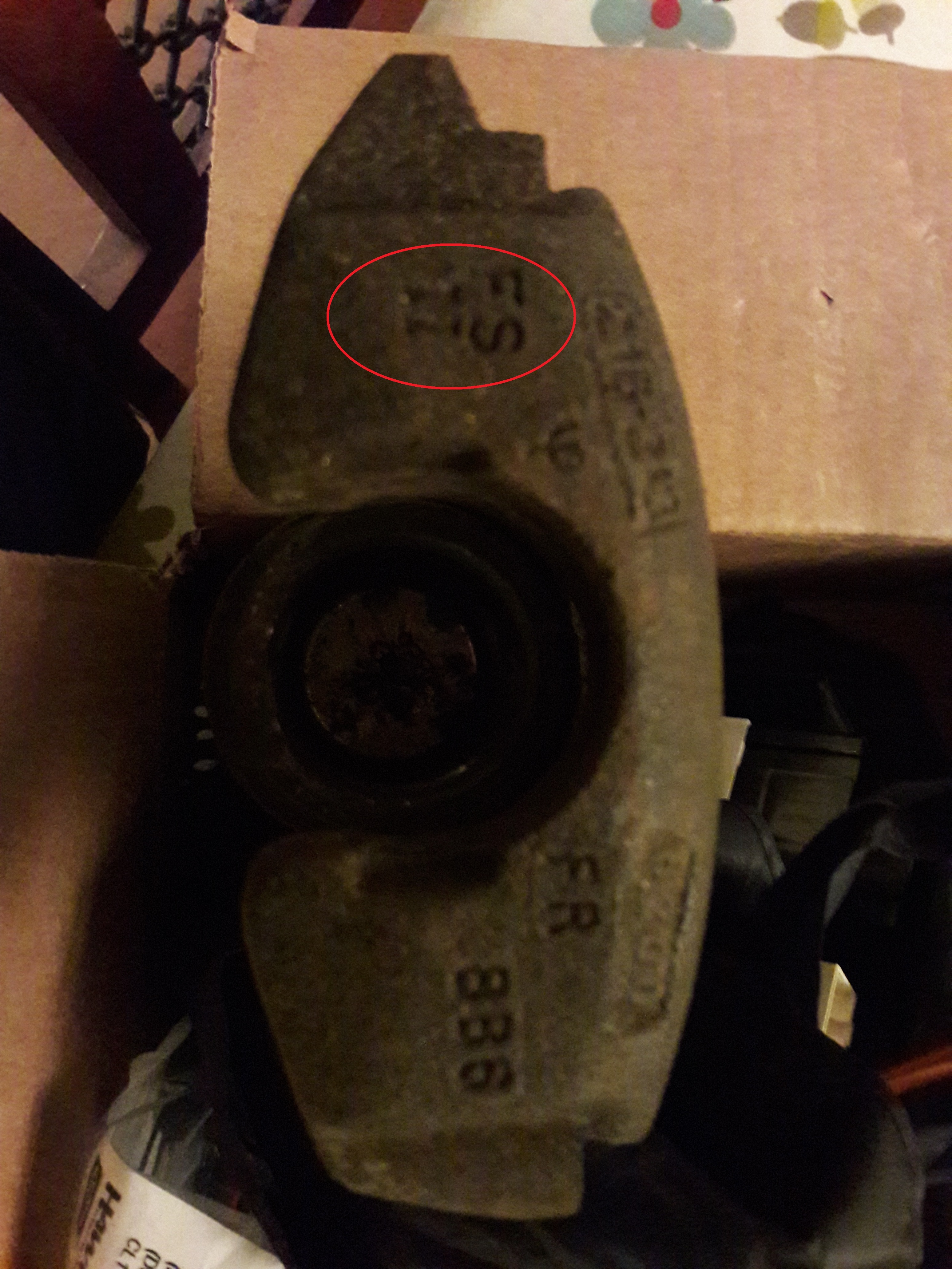

You need to establish whether the car has 239mm or 256mm discs first.  Easiest way to tell is to look at the outward facing surface of the calipers. If they say FS-II you have 239mm, if FS-III you have 256mm. Or you could measure them.

Right, I've checked. The brake calipers are incredibly difficult to read but all I saw was 'FR' and 'BB6'. I might've misread those but it's all I've got to go by since I couldn't even remove the tyre because wheel nuts are locked down tight.

Sounds like you'll be right with the 239/FSII;  I just photographed a spare that has that same FR and 8B6 on the other bit from where the FSII is marked.
FSIII calipers are much more clearly marked, see a nice photo in the last post of this thread: https://www.briskoda.net/forums/topic/193404-more-brake-owes/

Yep! Mine looks like that one.

Sorry for taking a while to report back but it's fixed. It is 239 mm after all.
