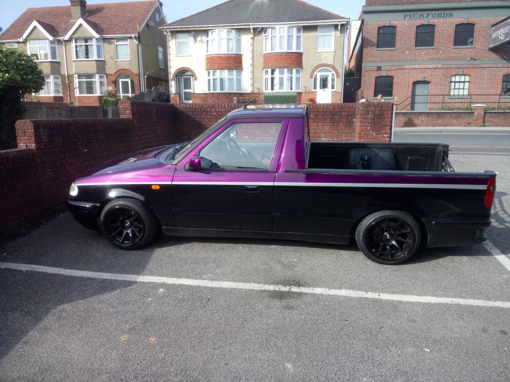

Recently bought a 2000 1.3 pickup with 66000 miles on it.  oil + filter changed, new battery fitted and new alternator put on 100 miles before i bought it.
