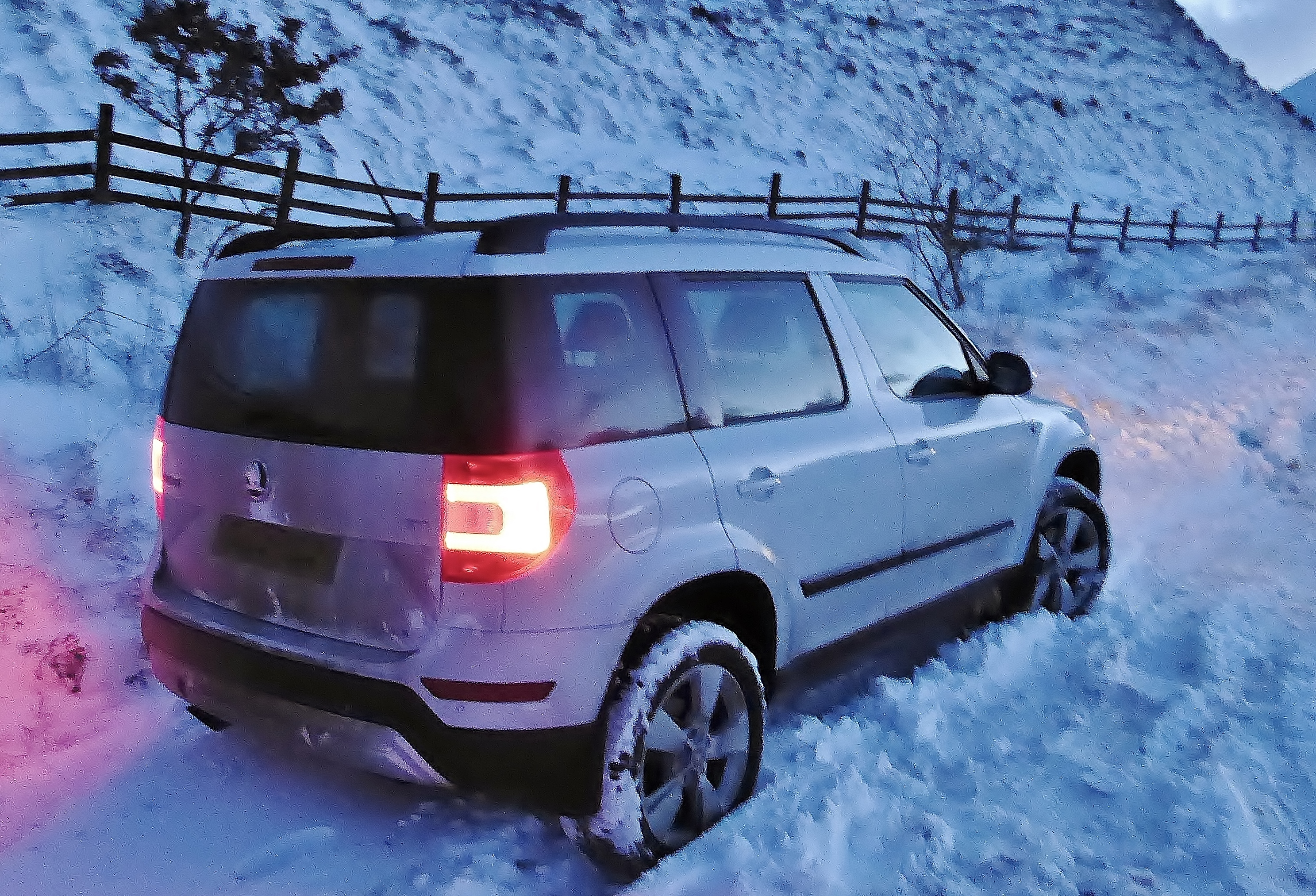

A family member has a 2WD Peugeot 2008, which has "grip control". This system is claimed to offer better grip in poor conditions, but I suspect this is more to do with the Goodyear 4Season tyres fitted as standard;)
My car in the snow (on Cross Climates):
