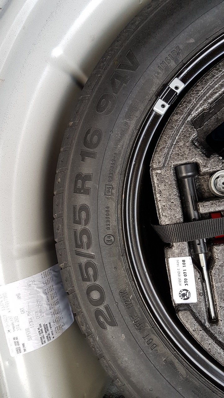

It will fit.
I have a 16" spare in the well , if yours is the same size and tyre diameter , then all is good

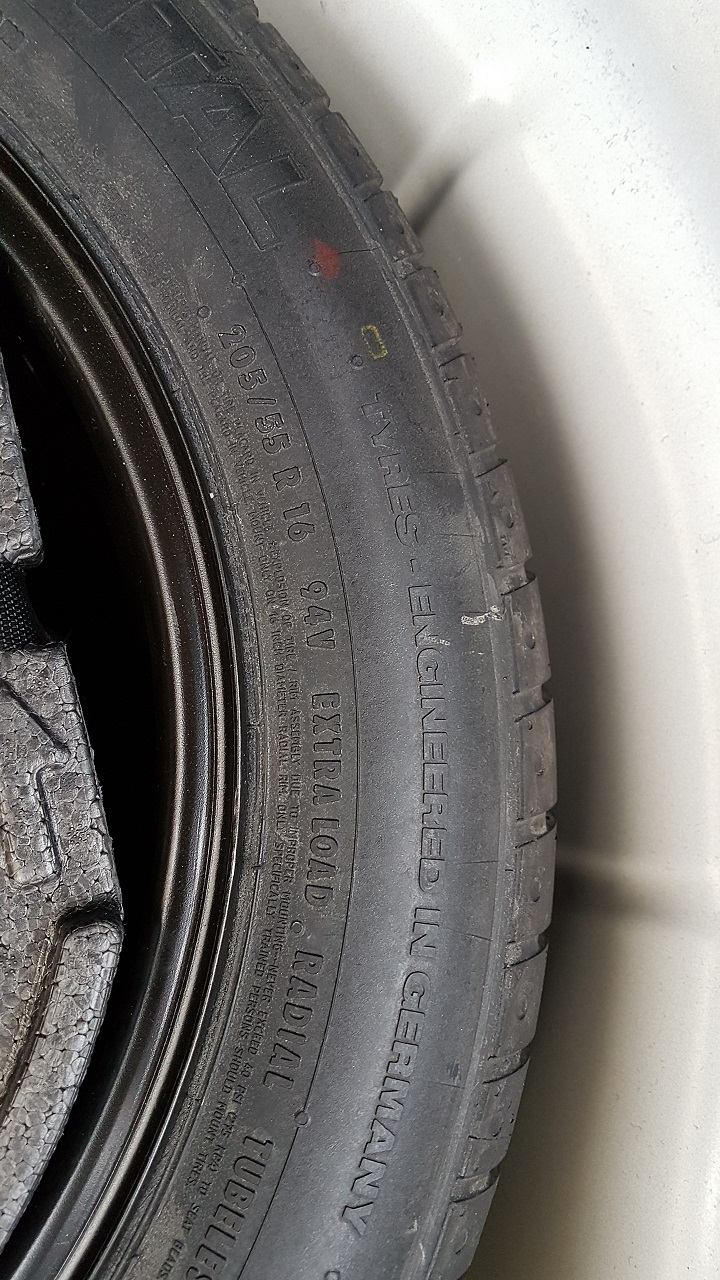

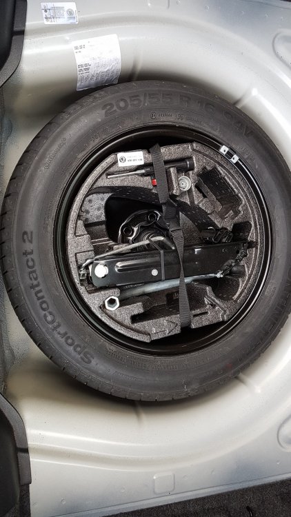

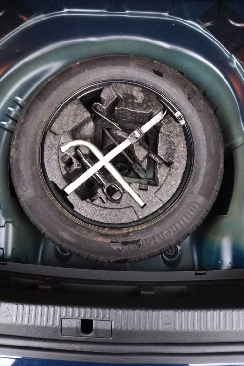

My spare wheel in my mk2 is ;-
 205/55 R15 94V
See images below
Thanks for your help.......
R 16 actually...

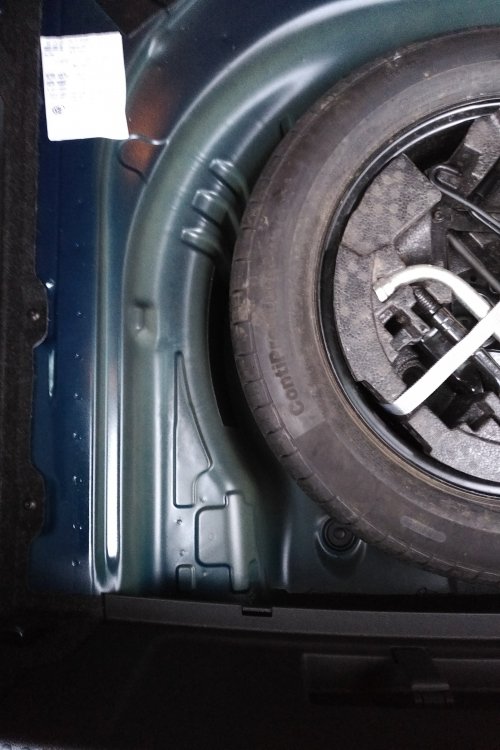

I have just bought a 66 plate TDI 2.0 Tech saloon that had no spare wheel, only an inflation kit.  Skoda dealer wanted £190 for a 205/55 R16 steel wheel which I thought was too much.  A few minutes on the interweb and I got a brand new wheel, tyre jack brace toe eye kit for £75 pound from a breaker.  It really is brand new and never been fitted.  I would never buy a part worn tyre but on this instance it isn't even part worn.  Anyway, fitted in a treat, plenty of space and the boot cover closes completely.

They come out the factory with 205/55/16” spare wheels and they fit under the carpet perfectly.

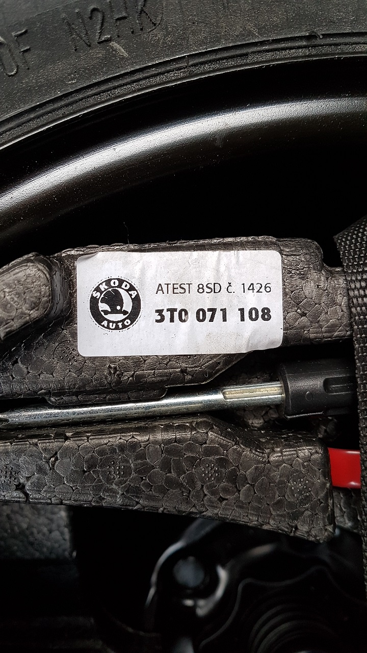

Of course. There’s talk of mk2, MK3, R15,R16...not to mention that the mk3 can come with various sized wheels as standard. I’m not sure if it’s a one size fits all thing or if you need a different spare depending on your alloy wheel size. I even went into TPS with part numbers from a different post and the guy in there wasn’t 100% convinced it was the right part for my car...and the wheel would have to go on back order with no delivery date. The full sized 16 threw me a bit as initially I thought I was looking for a space saver. Though I appreciate this is a space saver in a way as it is smaller than the 18” alloys. If the full sized 16” spare is the best and correct option for a mk3 with 18” alloys then that is the one I will buy. Obviously I want to be sure before parting with my cash. When I started looking I assumed it would be a simple question that had been asked 100 times before and there would be only one answer, hence my confusion when I started seeing different sized wheels all promising to be the correct one.

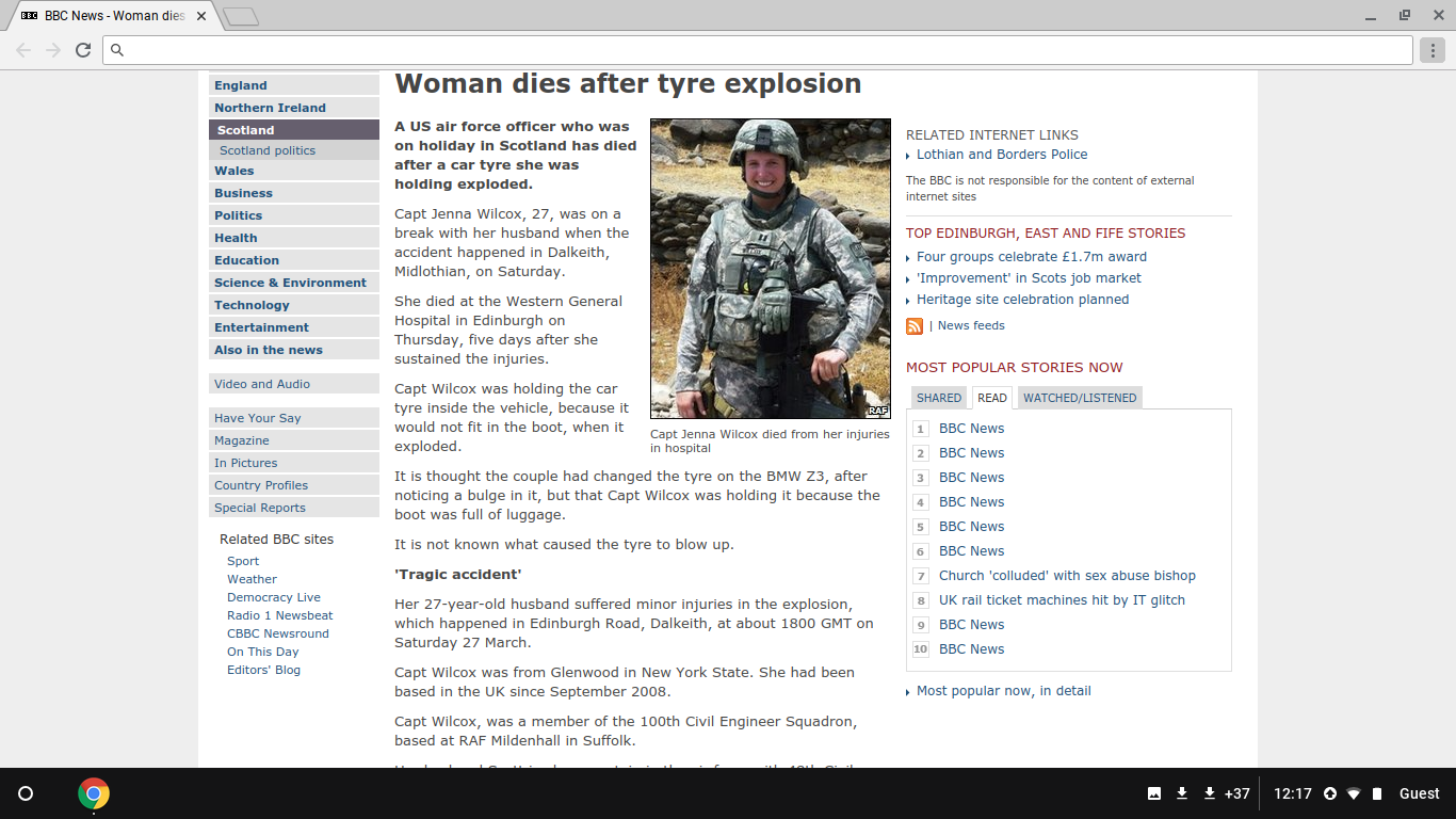

If you ever carry a wheel / tyre in a car remember to deflate it.
Not sure if only happened once, but not an Internet Myth.
A BMW 2 seater driver i seem to remember it was had a bulge on a tyre, fitted a Space Saver but had no room for the wheel / tyre off the car and put it in the car and
it exploded.
Not sure if a fatality or not with the passenger.   Maybe a google will show the news article.
EDIT.
Sadly she did die.
http://news.bbc.co.uk/1/hi/scotland/edinburgh_and_east/8600833.stm
