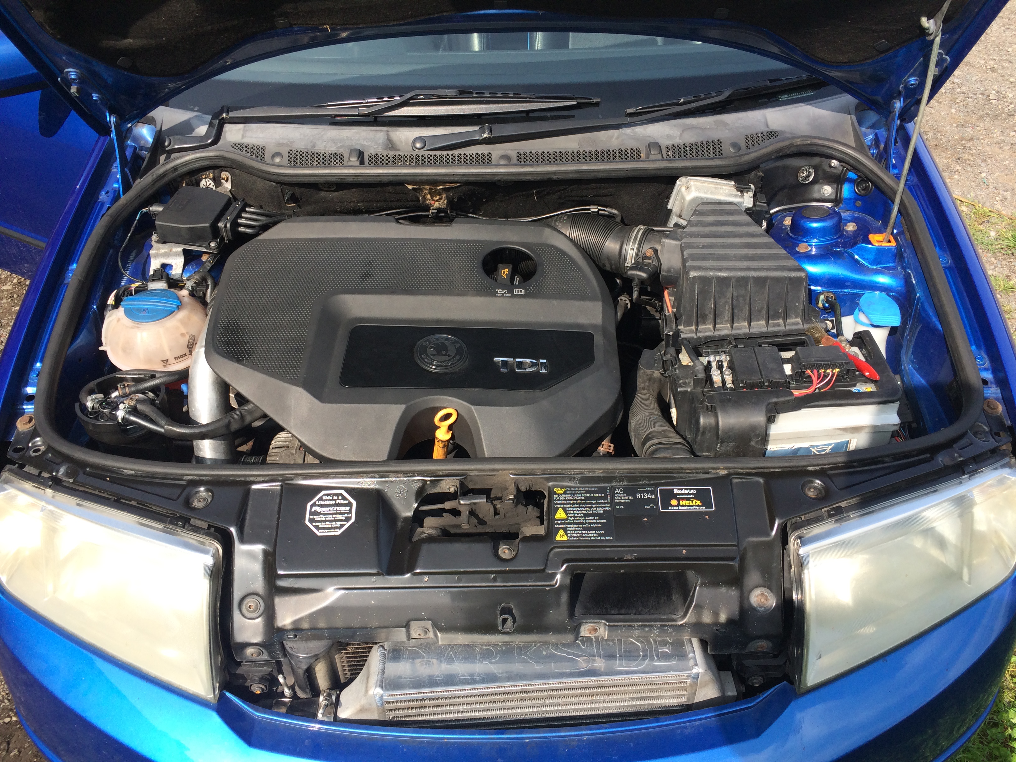

Hi, new to the diesel/pd130 world! I recently bought a mk1 SE Fabia vrs, I have been told it's around 200bhp. No printout to prove, I bought it from a friend though.
The modifications this has are; PD150 turbo, darkside fmic, darkside hard pipes, egr delete, straight through standard exhaust, 312mm brakes and 256mm rears, new clutch and flywheel (unsure on what brand) and a remap that is copied off his PD160 hybrid Ibiza cupra that he had.

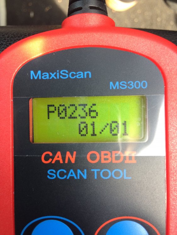

I need help
I have just plugged my OBD2 reader in and it's showing the code p0236. What is this please?
P0236 code definition
Turbocharger Boost Sensor A Circuit Range/Performance
What the P0236 code means
P0236 is an OBD-II generic code that is triggered when the Engine Control Module (ECM) detects the intake boost pressure sensor A input circuit range or performance is out of specifications when compared to the manifold pressure sensor (MAP) or the barometric pressure sensor (BARO) at idle and with the key on, engine off, before starting.

22 minutes ago, AaronLister said:
EDIT: the car has not got an EGR delete.
Could getting an EGR delete help the problem?
Also, where is the MAP sensor please?
No.
The map needs re-doing correctly to suit that engine rather than a different car, it's also likely that the MAP sensor is the original 4 bar sensor and doesn't quite have enough headroom for the bigger turbo.

I'd start with the MAP sensor wiring and the seating of the MAP sensor into it's fitting. It all gets changed around when fitting an FMIC.
Where will the map sensor be please? I honestly know very little about them. I'm more into my motorbikes so I don't know a lot about cars haha
Second picture down here shows the mounting flange welded to one of the IC pipes.
It's behind and below the OS headlight.
