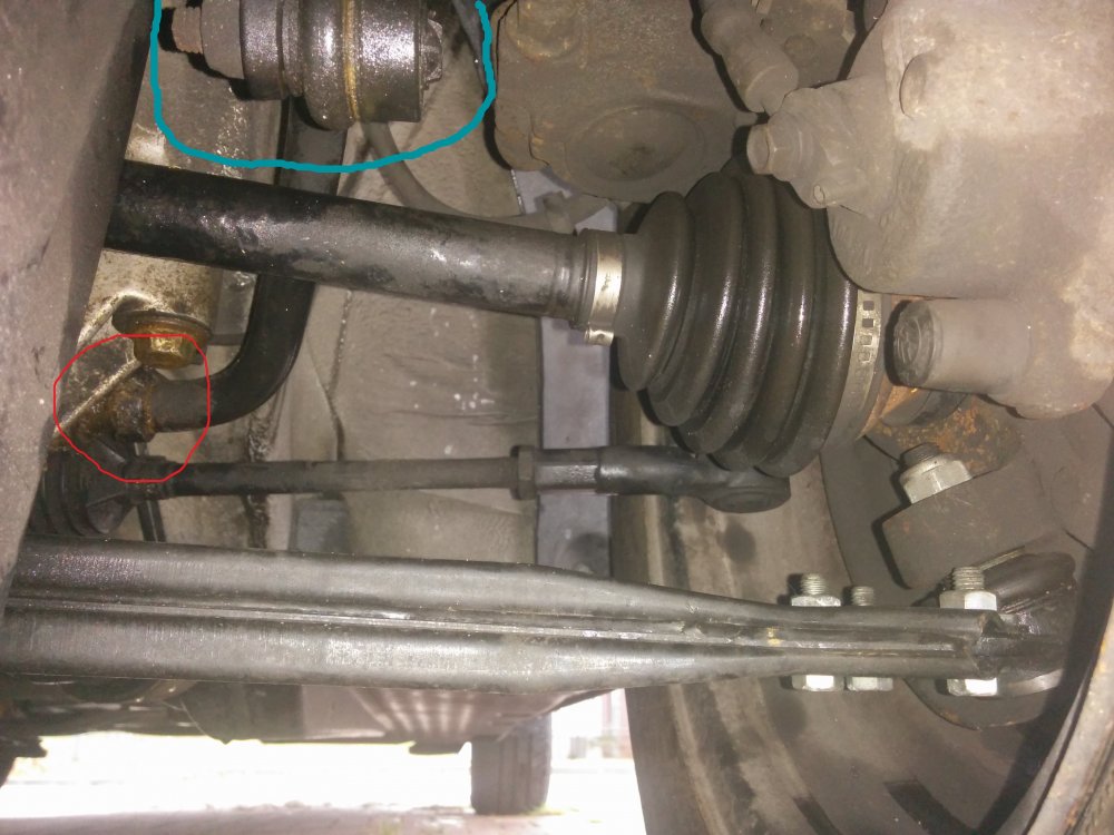

Hi everyone. My 'wonderful' Fabia has offered me another fascinating noise to try figure out over the last few days.

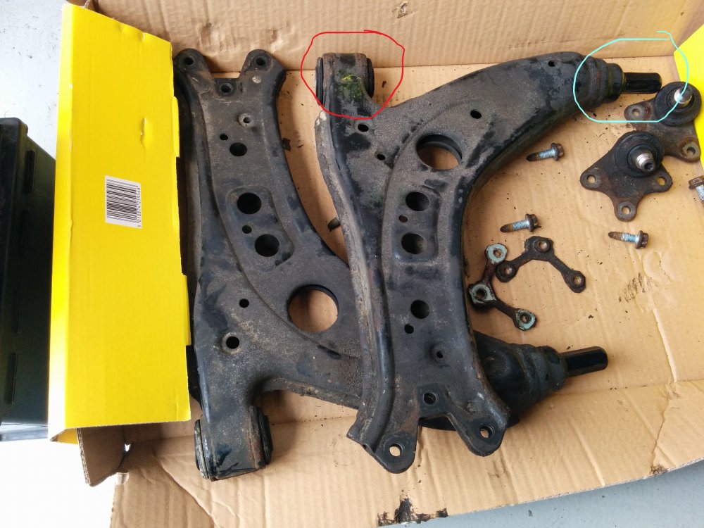

I'm now getting a clonking/knocking noise, whilst pulling away, or reversing, from standstill, from the ns front corner. I was hoping it would be something to do with wishbone (as I have now bought one) that side, but I'm not so sure...... Many thanks

Sounds console bush-ish to me.

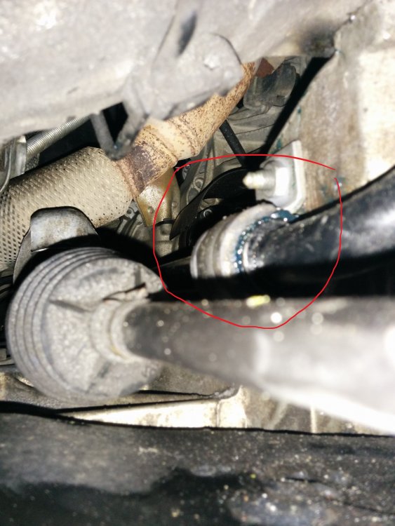

Hi Wino. The car has had new springs (elbach) dampers (Bilstein b4s) uprated console bushes and new mintex discs and pads. I'm at a loss as to what it is. I have seen some posts on here suggesting a gearbox, or engine mount. The gearbox had been out two times in the last two months. Could this have weaken something? Can any of the gearbox mounts be sourced easily and replaced easily, whilst the gearbox is being swapped again?
Could be the dogbone mount on the rear of the gearbox. Replace it with an oem spec one they are really easy to do shouldn't take more than 30 mins labour.
Cheers, C. Does the dog bone mount need to come off when the gearbox goes back in? Where do you get one from? PD 100 1.9)

Yes it will be removed when box is changed.
Call the dealers and try them for price.
Ive had ECP crap before and the mount fell apart whilst driving leaving only the exhaust to support the gearbox/engine from ripping itself out.
