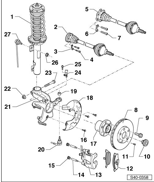

Sorry for the double post, but the handling of my car is getting a bit more 'wayward' and I gave  my Wife a lift earlier, and she looked scared for her life! (might just be my driving coupled with the 'hard' ride as she put it)
Does anyone have any ideas as to were I can get a new wheel bearing housing for a good price?

@GeneralDogsbody, I found the bearing carrier I was looking for the other day in my workshop this afternoon (While looking for something else, of course).
It appears to have the part number 6Q0407255R, which has been superceded by 6Q0407255AC according to this page.
So I think it could be what you're after. I took the bearing out a while back, for practice with my Gen2 toolset, and the casting is pretty rusty, but most of that will disappear easily with a wire brushing.
Let me know if you might be interested, and I can take some photos.
Hi Wino. I've only just seen your post - annoyingly, I have already bought a new bearing carrier to be fitted.......£132! Blast! The bloomin' car's squeaking like mad in the wet weather everytime I drive over a speed bump - it's doing my head in. I don't know what else I can grease on it!
