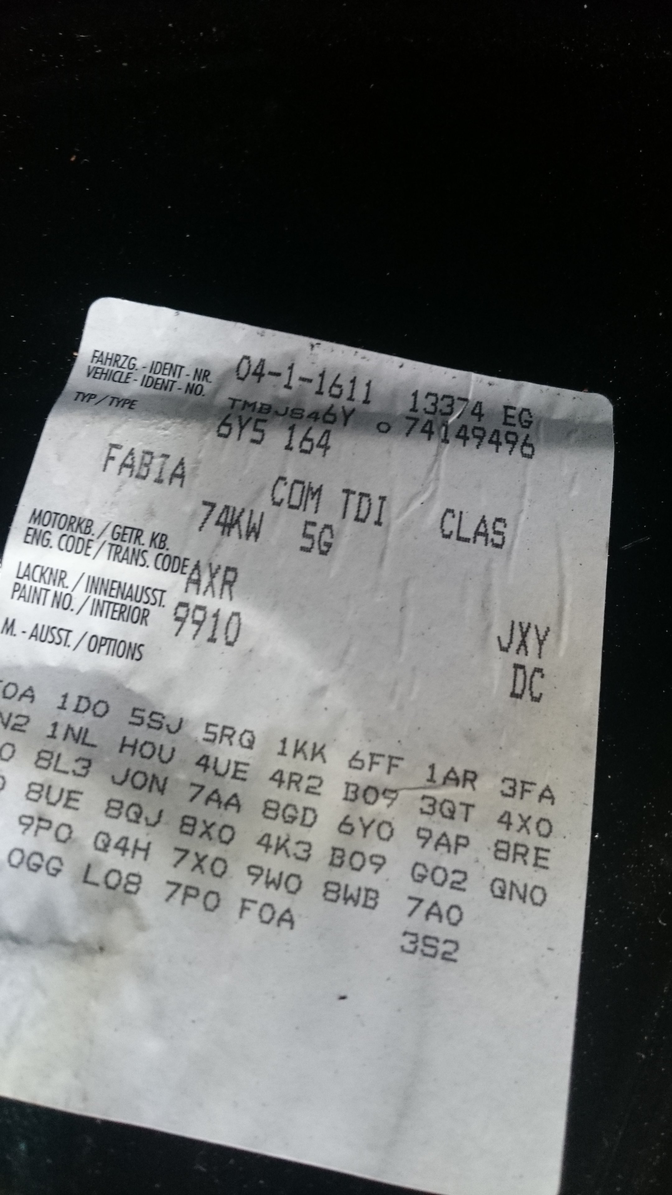

Whats your engine code and year of car?
2007 and AXR?
1 hour ago, GeneralDogsbody said:
2007 and AXR?
So it's one of these depending on production codes (on a sticker in your service book and under the boot carpet). Doubt there's any important difference between them tbh.

I think the first of those will be compatible with 256mm front disc  set-up, the second one with 239mm and the last one 288mm?
I'm not 100% sure though.
Oooh never thought of that. Could well be.
  • Sponsor
I'm confused about the third one TBH. Not for 288mm, that's listed separately as a 7A item by the looks of it. Possibly another 239mm variant. Probably not relevant anyway as the OP's engine code appears in the first item 7 listing, the -AC part.
Could it be for a car with no ABS? no sensor hole?

Thanks guys. Any help?
The bit we need to see on the left is cut off in the pic.
  • Sponsor
Front brake PR number often isn't on the sticker, bizarrely.
As my phone's camera has decided to now break, I have been unable to get a picture of the sticker. I have also been on a wild goose chase today, trying to find a supplier of the wheel bearing housing/hub. I've tried; Euro Car Parts, KMS and Exhausts Unlimited/Wilco.  Is there any other stockist that you could recommend that might have a new one, for a decent price? (I'd like to buy 2nd hand, but I know I'll get a duff one, and as I've just got a refund for one of my gearboxes. I'd like to do it right, as such.....)
