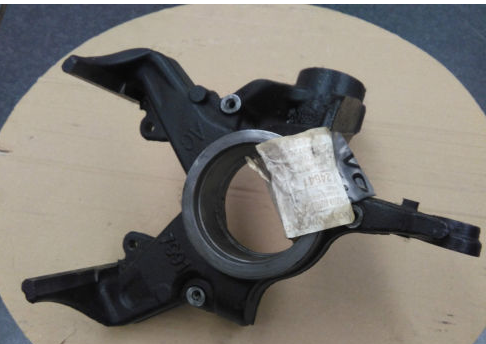

After another trip to the garage today, the mechanics that have had a look at my car have said, that it looks like the hub/wheel bearing carrier on the N/S looks like it FUBAR'd, hence the high negative camber (As everything else has been replaced) The only problem - they want £480 to fix it!
I was quoted £150 for a wheel bearing - just found the same part on ECP for £49.99 (thanks Black Friday sale!)
I just need a 'Hub bearing carrier' What's one of them when it's at home? (That was another £100+ on the quote) Could I get one 2nd hand? Would anyone on here have one?
Many thanks
Edited by GeneralDogsbody
This is a hub bearing carrier. The strut fits into the part at the top left...
Edited by TMB
  • Sponsor
Bearing carrier is the big cast part that brake calliper, suspension strut, wishbone balljoint and steering tierod attach to, as well as housing the wheel bearing.
Finding it a little difficult to imagine how it could be the cause of your trouble, but willing to learn.
Here's an example:
