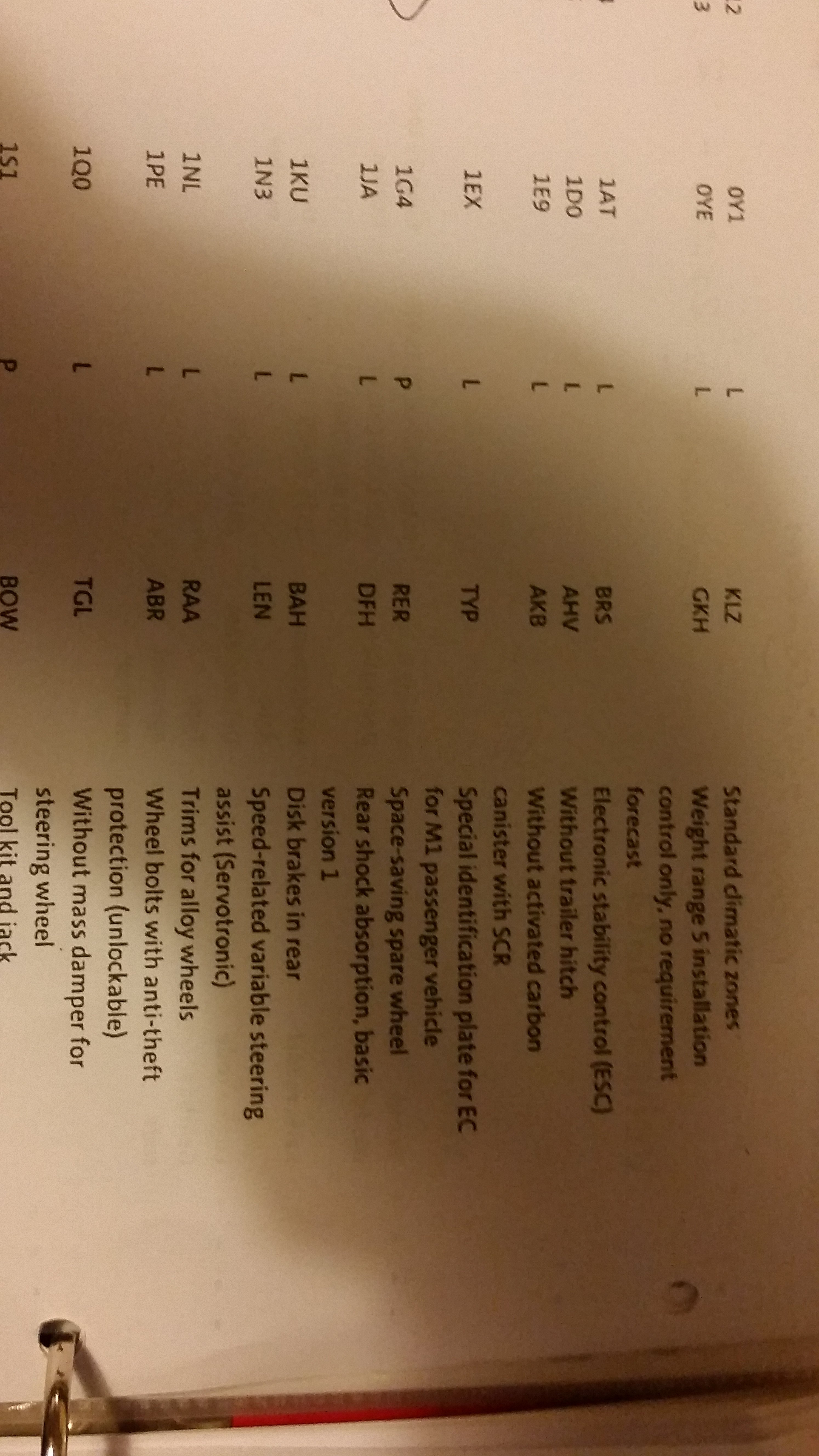

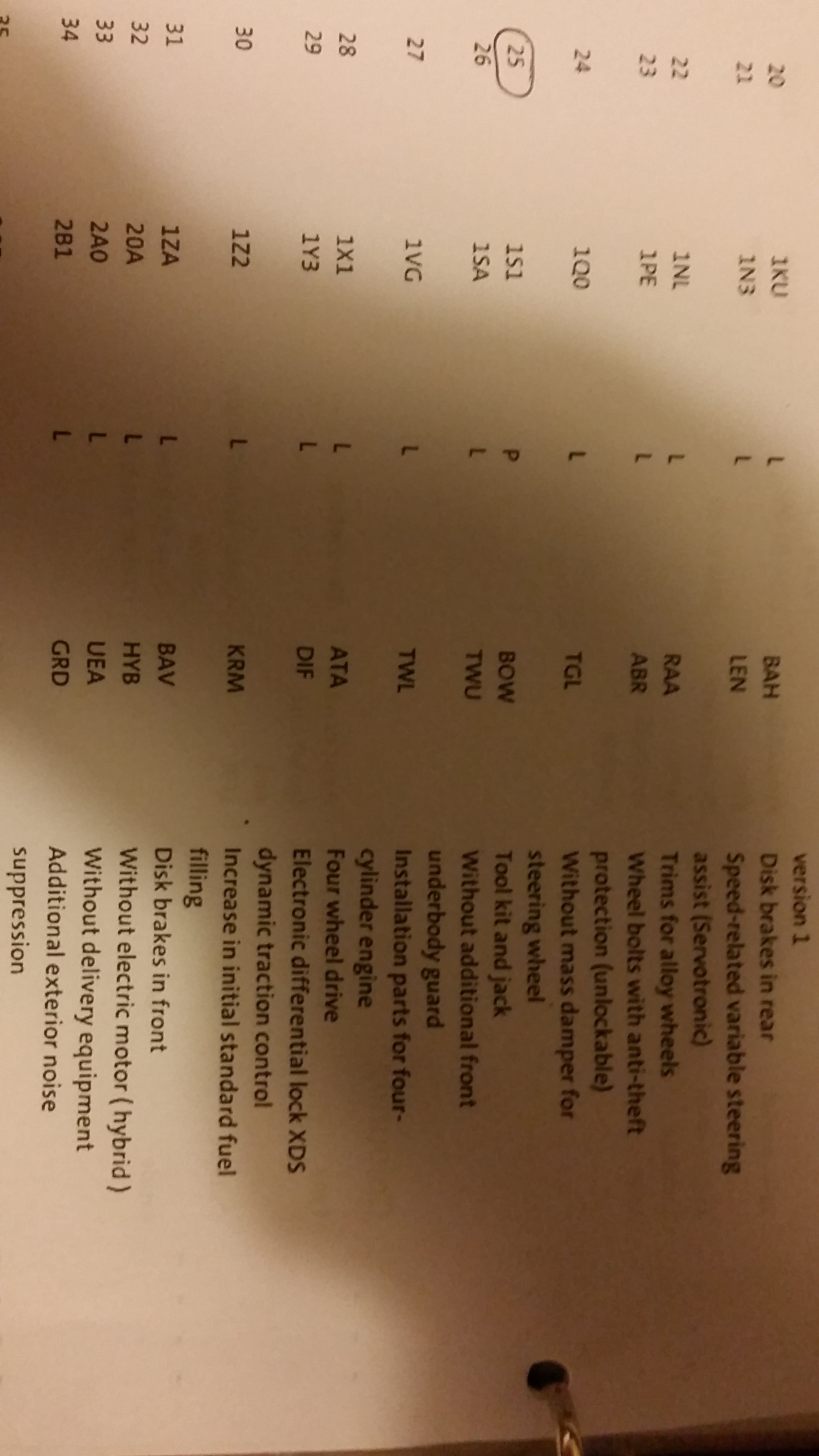

Fiki,
Yes in essence you're right about the 4X4 system, however the steering has nothing to do with the 4X4 system.
XDS is the code for the electronic diff's, these function with both the ESC (Electronic Stability Control) & XDS (Electronic Differential Locks), whilst they are not true diff locks, they act as diff locks, that is to say, that on a LSD (Limited Slip Diff) or diff locks, as fitted to the likes of Land Rovers etc where the diffs are locked by limiting the drive to the wheel that is ,or has, lost traction, electronic diff lock does this by applying the brake to the wheel(s) that have lost traction.
As you've said, the 4X4 system is constantly there, however, in "normal" driving conditions the power split is approx 96% to the front wheels & 2% to the rear wheels (2% is lost/used by mechanical means). As the road conditions change the system will selectively transfer power from the front to the rear, thus giving the car the 4 wheel drive system & maximum split is approx 50% front & 45% to the rear (the additional 3% loss is within the Haldex (Electronic & hydraulic rear "diff" that transmits the power to the rear wheels) system.
The ESC system also uses the XDS in conjunction with the steering (steering angle & Yaw sensors) & braking (ABS & the ABS wheel speed sensors) by correcting understeer (running wide when cornering) or oversteer turning too tightly when cornering. Understeer  by  selectively braking the left front wheel (for Right hand drive cars) & the right front wheel (for left hand drive cars). Oversteer selectively braking the right front wheel (for Right hand drive cars) & the left front wheel (for left hand drive cars). This system pre dates the MK7 Golf, by a number of years.
I think we have a missunderstanding. What you are refering to as XDS is what VW calls EDL(electronic diff lock) and that works similar to diff lock on Land Rovers(locks one wheel and sends power to the other one,dor exhample if one wheel is on ice and other is on tdry it will send power to one with traction). XDS+ is something else,it aplies a bit of braking to inside wheels in corner,so it helps with cornering. I think that sistem does in fact predate mk7 gti,but the plus version was unveiled with mk7. I suppose it has some benefits over standard xds. Sistem does in fact work with esp(but is totally different to classic esp intervention which you described). And this sistem is included on front axle only if car is not equiped with 4x4.
And what do you mean steering has nothing to do with 4x4? Arent there some sensors that monitor steering input that work in  conjunction with haldex 4x4?
And i would recomend him to get progressive steering,it does make a difference.
Hi Fiki,
No there are no steering sensors that input information to the Haldex unit, the haldex unit simply acts as the rear diff & transmits power, when appropriate, to the rear wheels.
In the UK Servotronic steering is speed sensitive (progressive steering as you call it), the sensors associated with steering:- Steering angle sensor, does what it says, senses how much the steering wheel is turned (left or right) from the straight ahead position, Lateral Acceleration sensor (commonly called the Yaw sensor) detects sideways travel, especially when cornering. ABS (Antilock Braking sensors) inputs wheel speed information. All these are connected to the ESC system, which as part of its function is to selectively brake either of the front wheels when understeer or oversteer is detected.
An electronic diff lock in a conventional diff does exactly that, it locks the diff so that the drive shafts turn at exactly the same speed, it does not & cannot lock individual drive shafts, this also applies to a LSD.
The VW group cars, Audi, VW, Seat & Skoda, use XDS as their electronic diff locks, it differs from the above, in so much as it does not lock the diffs but uses the braking system to lock the wheel(s) that have lost traction so that the power output of that diff (or haldex) goes to the wheel that has traction. It also acts in conjunction with the ESC when slip is detected by reducing the power output from the engine, otherwise known as Dynamic Traction Control
ESP, Electronic Suspension Programming was superseded by  ESC.
The same codes are used across the VW group cars for virtually all of the options/standard equipment, see the photo's of my car's attached Vehicle data sheet.
I was associated with VW group vehicles from 1971 to 2009, working for a company based in South London, that had, amongst other marques, 3 VW, 7 Audi, 1 Seat & 1 Skoda dealerships. I worked in all the VW group garages
Well,i read somewhere that from i think 3rd or 4th gen haldex sistem is "proactive",they say it monitors few things and can detect when slip will ocur,before it actually does. Is that true,i dont know.
Sistem that i refer to (xds+) is also integrated in octavia vrs,it should help with fast cornering as it applies braking to inside wheels to "slingshot" you around the corner,so it is not the sistem that helps you get out of slipery driveway :biggrin:.
When this sistem is working you don't get any signals like when esc cuts in (yellow thing on dash and obvious intervention). It just makes the car go better through the corners.
I said esp in last post (i am used to that expresion) but i meant ESC(i have 2 stage one in my sportline,don't know why).
All in all,after driving 150 with 2wd,my 4x4 190 sportline feels like different car,so in my book that 4x4 is more than welcome.
Progressive steering (it is called that in skoda catalog in my country) is really nice,can get heavy at speed,very light when manouvering,deffinetly worth that 150 euro price.
The progressive steering also adds variable ratio to the steering, not just more or less assistance from servo.
Instead of three turns of steering wheel for max left to max right you only have two turns with the progressive steering :) Don't know the numbers exactly but it feels like when you turn the wheel 45° either way you have normal ratio and when you turn more the ratio increases - less input more movement.
And I think @fiki is right about the XDS braking inside wheel when doing sharp cornering. Also the XDS+ system is a mechatronic add-on unit reminding somewhat of the haldex system but are only connected to front wheels.
