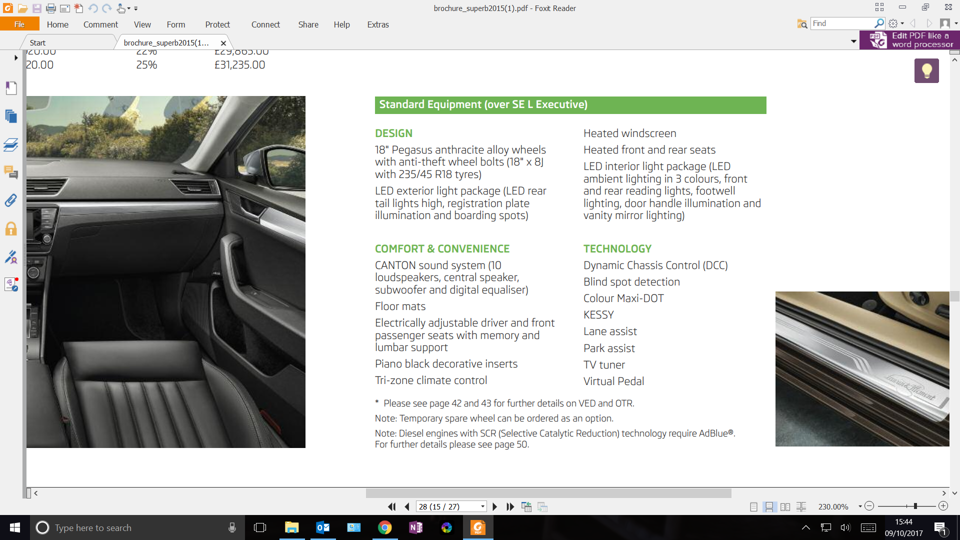

Traffic jam assist is part of Adaptive Cruise Control on a DSG fitted car. I had it on my MY15 car that did not have smart (dynamic) light assist. I have attached a copy of the page from the my15 brochure showing the difference between SEL and L&K.
The 'smart' or dynamic light assist is the one that keeps lights on full beam and blanks out oncoming cars etc. Light assist, which is simply automatic high/low beam, is standard on the L&K. All have adaptive light control which varies the shape and span of the light system.
The TV  tuner disappeared after the initial run.
hth
Edited by Sagalout
