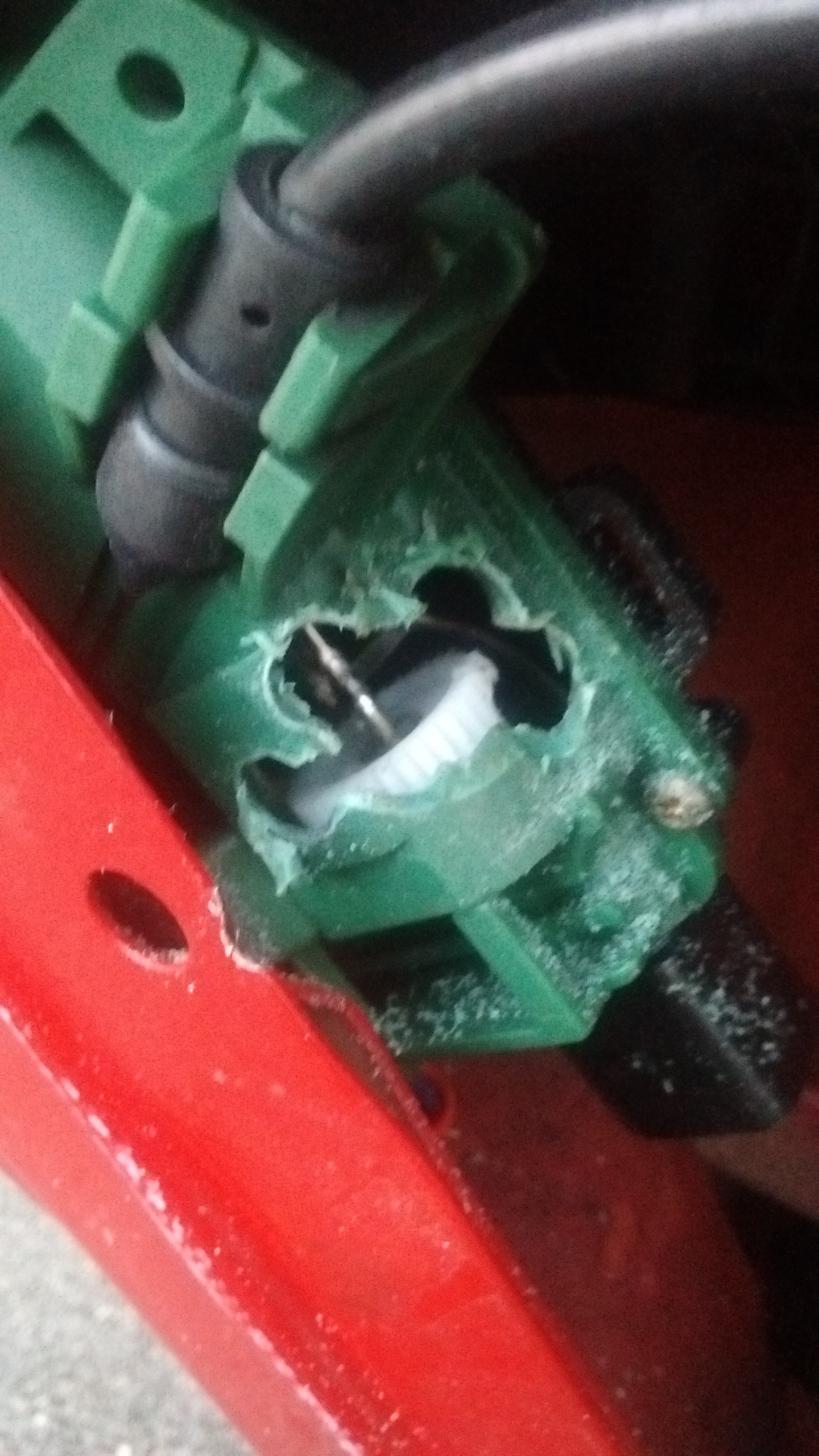

Top advice from mac11. This is where on the casing I drilled to expose the all important cog.
