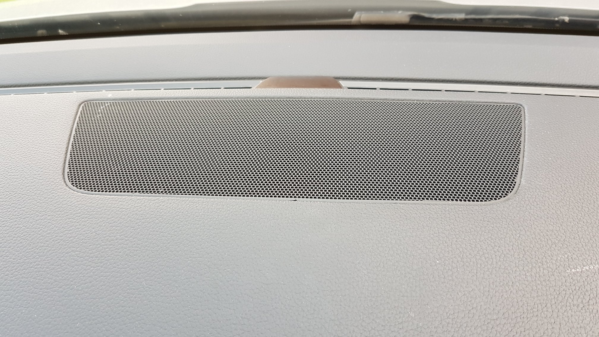

Does anyone know how to remove the grille in the top centre of the dashboard?
I've had a rattle from behind there since new, left it too long to tell dealer (over 6 months/6k miles apparently for rattles and squeaks to be done under warranty) as I wanted it done at same as first service due to dealer being an hour away...and now they want £90 just to look, even though they thought they had sorted it at 1st svc., having charged for it. Lost the will to live with asking the dealer now and would like to have a go myself.
I don't want to break anything, anyone removed this before? I don't have Canton sound, is it only Canton that has a speaker there? That's what the dealer claimed anyway...
I have checked under the scuttle panel to see if anything was loose there, checked the sound generator (disabled via VCDS anyway) but can't find anything obvious. It's only at certain revs too, most annoying.

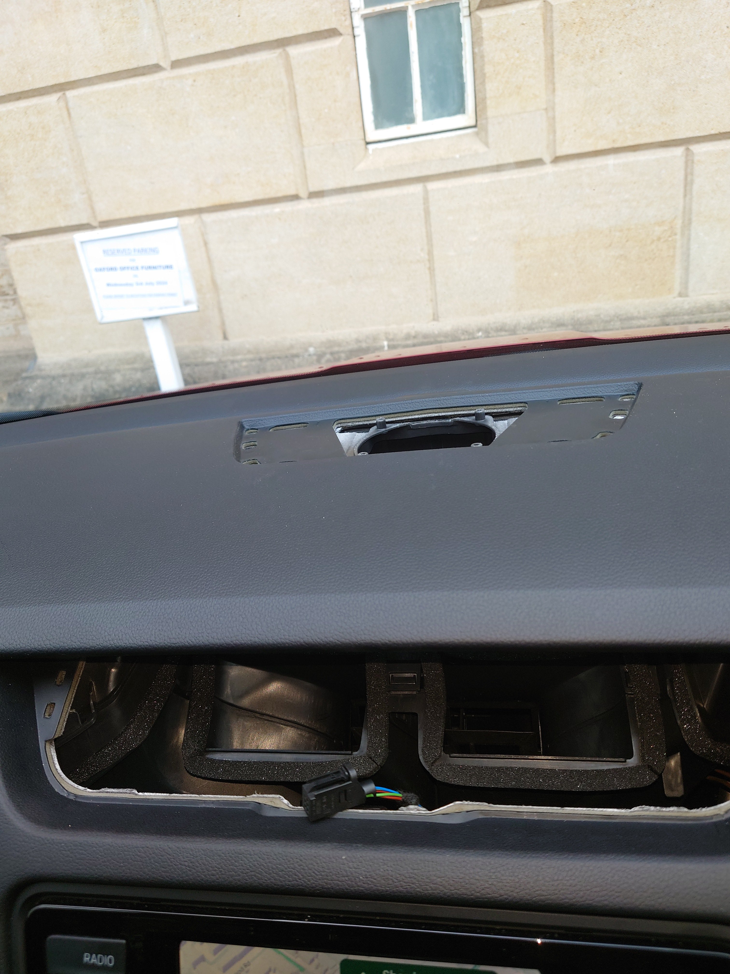

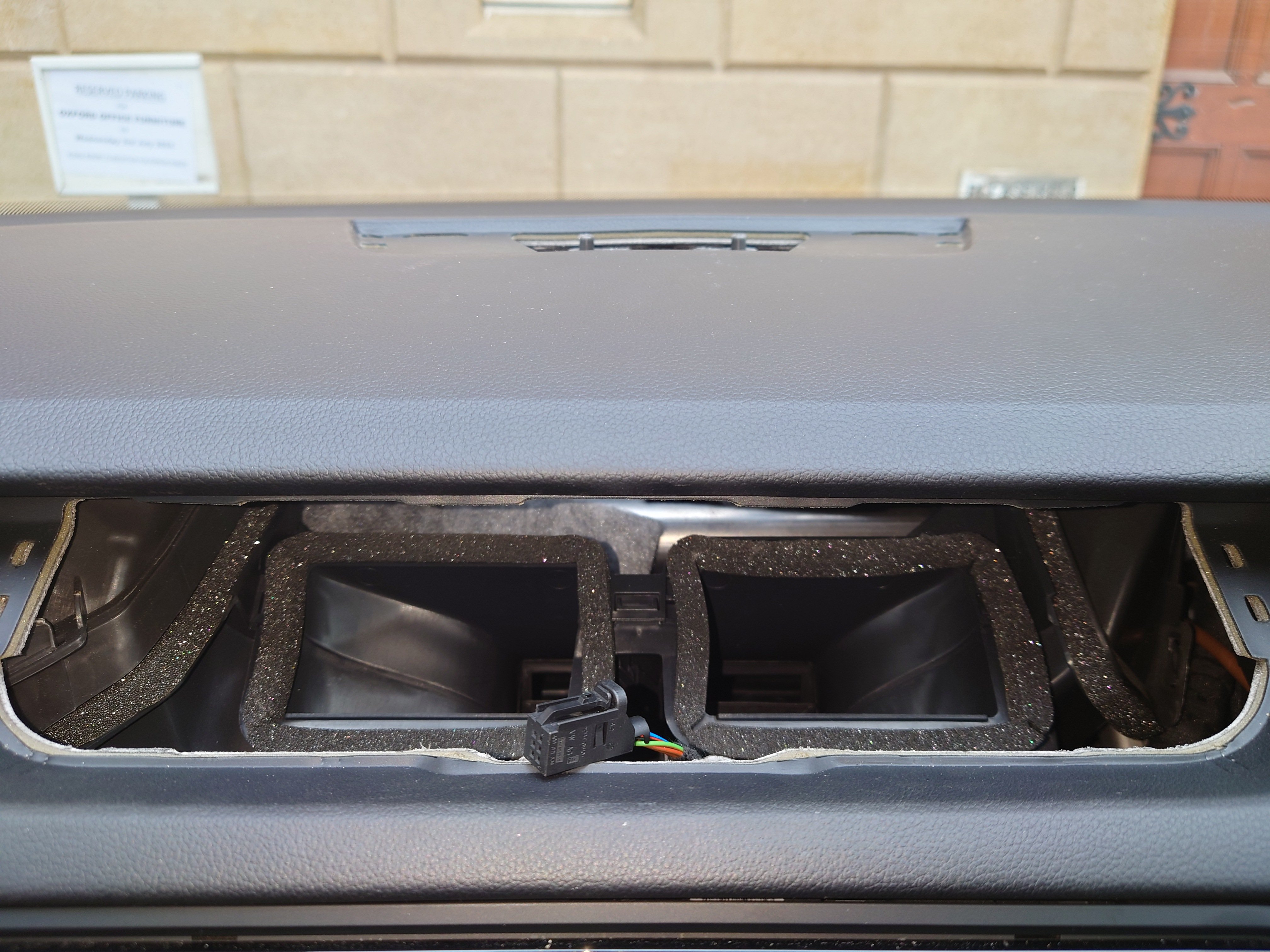

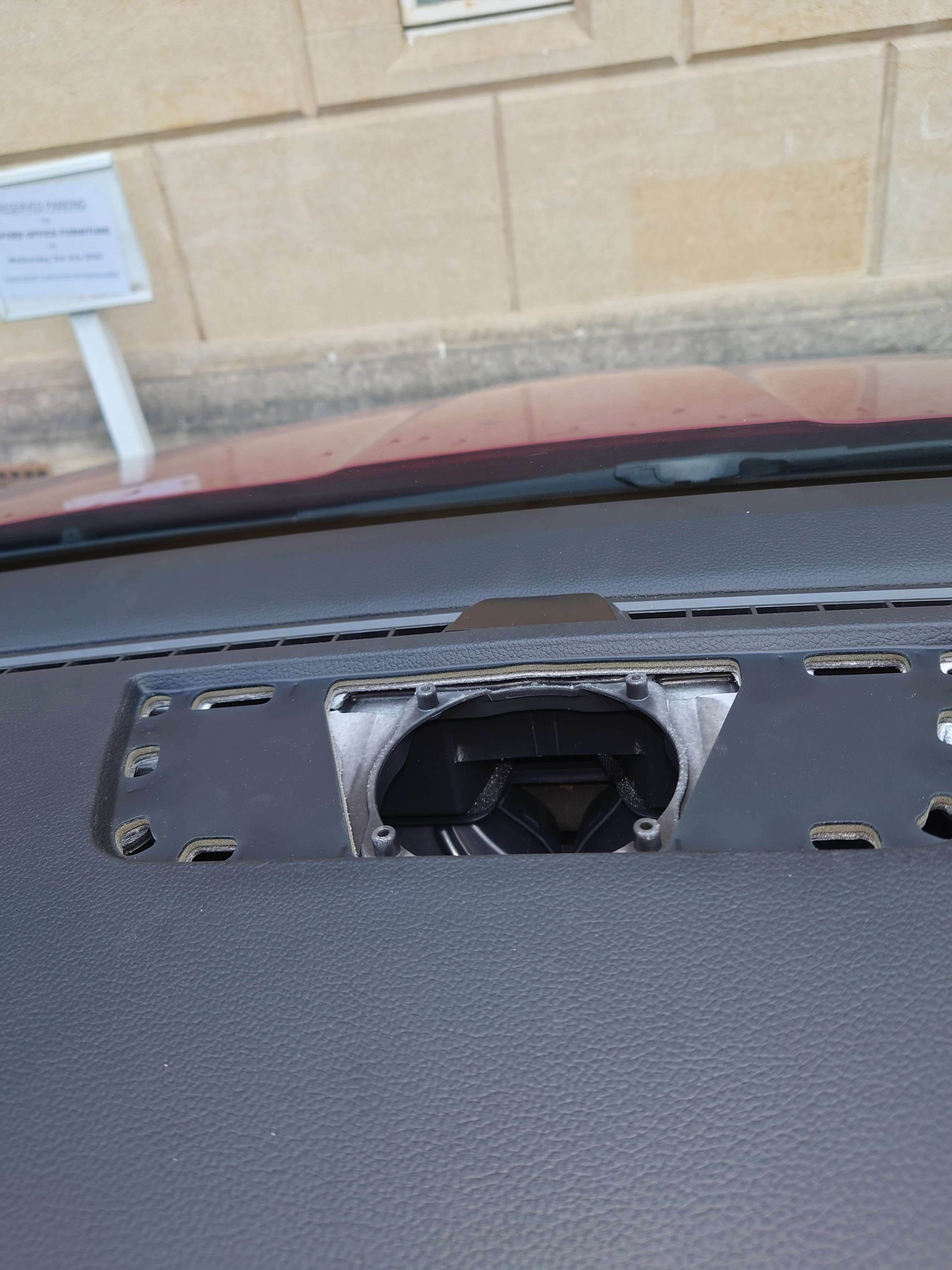

I have been having issues with rattling behind the dash and have still not got to the bottom of this problem. However, I found a great way to remove the grille without damaging or breaking any of the clips. Simply remove the center air vents (there are 2 two retaining clops for each side, you need to lift them up an gently pull out the air vent unit from the bottom and tilting it towards the top). Once the air vents are out, you can reach inside the hole and press the grille clips carefully and then pull the grille out.
On my car I had no loudspeaker there, it was a huge empty space...
And please find some images below that show what to expect once the air vents are out:
