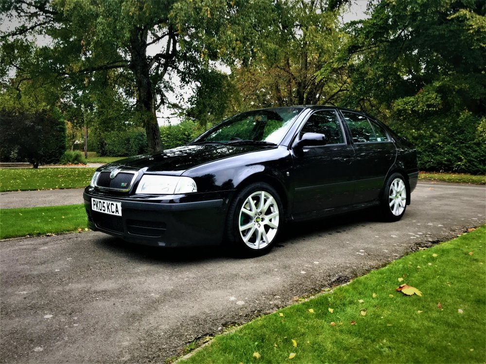

Be good to hear how you get on. And a picture or two of your car wouldn't go amiss either! Come on, show us yours haha!

Only got the one decent photo unfortunately. These forums are life savers although sometimes it can be a bit like when you google your cold and come to the conclusion you have a brain tumour! Thankfully you come across a mind easing post like this every so often... I've always been a Castrol edge man but perhaps it might be time to make the swap.
