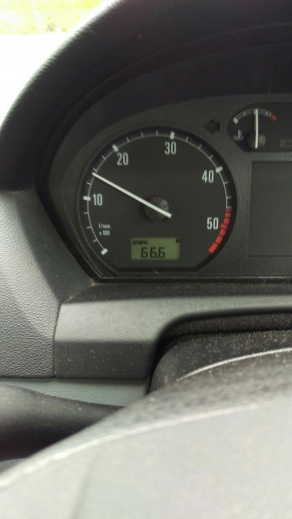

One for Halloween :D
^ Haha, no wonder it's losing power, your car is possessed :D
I will call a priest!
