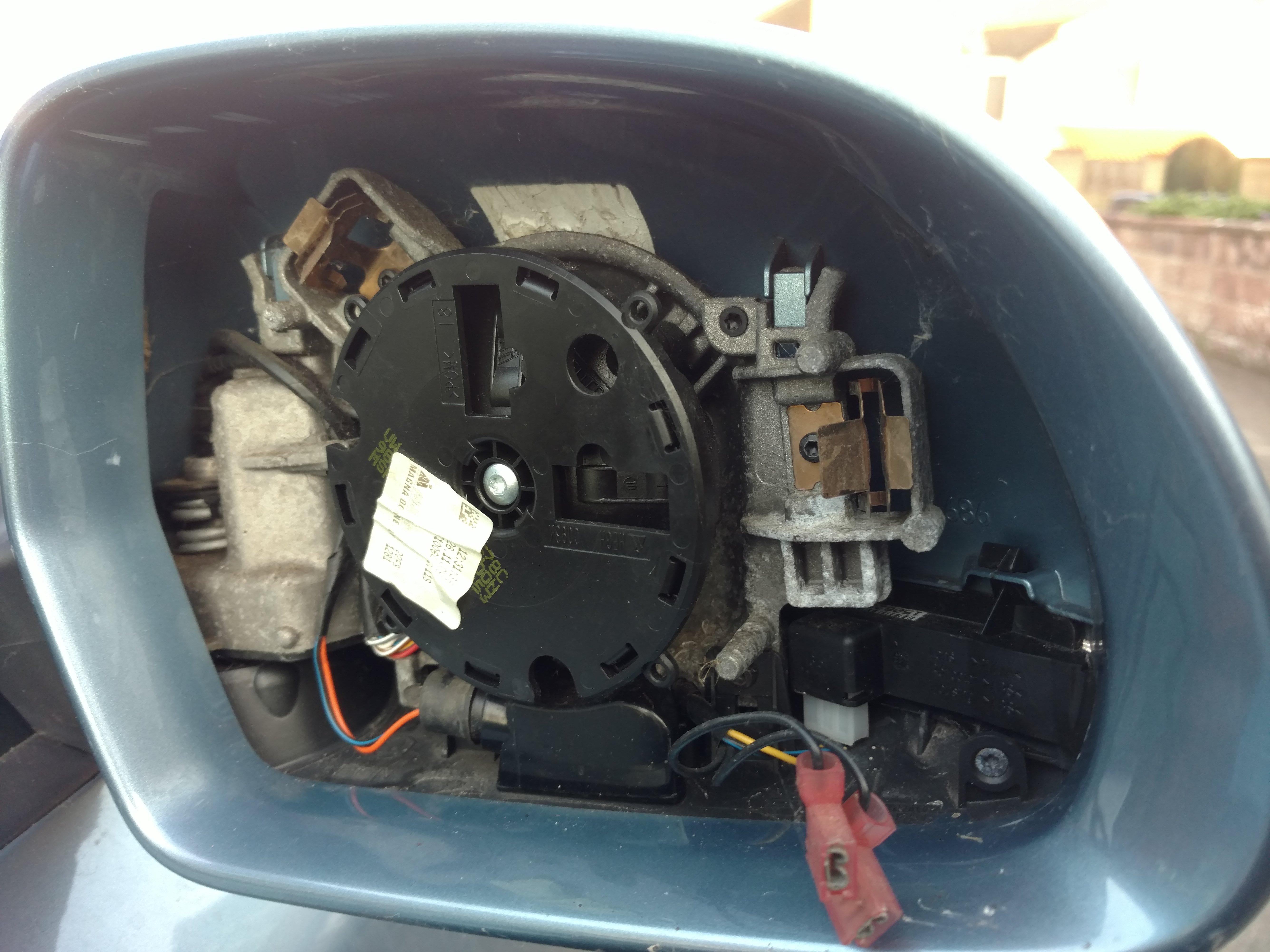

I took the glass off to be certain, no extra wires loafing about! Changed the puddle light for an LED while I was about it though so it wasn't wasted effort lol.
I'm guessing it must have been an optional extra after all, unless the mirror got smashed off and replaced with a non dimming OE unit at some point in the past maybe.

When I looked at this for my pre fl L&K auto dimming was an (expensive) option. It was dropped as standard around 2006 or 2007. Whether the fl re introduced it as standard I am not sure but I doubt it. They did bring in power folding for the fl - this was never possible on the pre fl without using a unit from a different car.
I have an FL L&K, the only mirror that is auto dimming is the interior rear view mirror, no mention of the other mirror's having this feature in my brochure or owners handbook.

Well it looks like the glass is shared with a few Audi's, so the scavenging options are looking a lot better. Hopefully it will just be a case of running some wire to the mirrors and swapping over the glass, if I ever get around to it!
Pretty sure you'll need to run a wire from each wing mirror to the rear view mirror so it may be harder than you imagine. Certainly possible though :)
