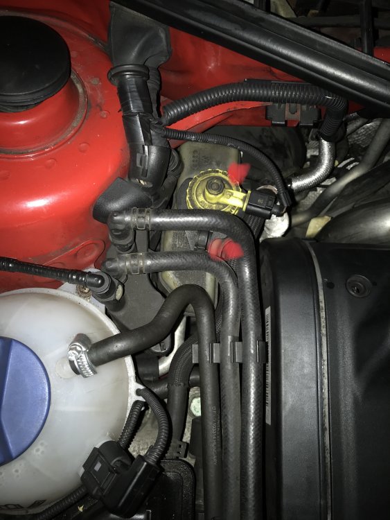

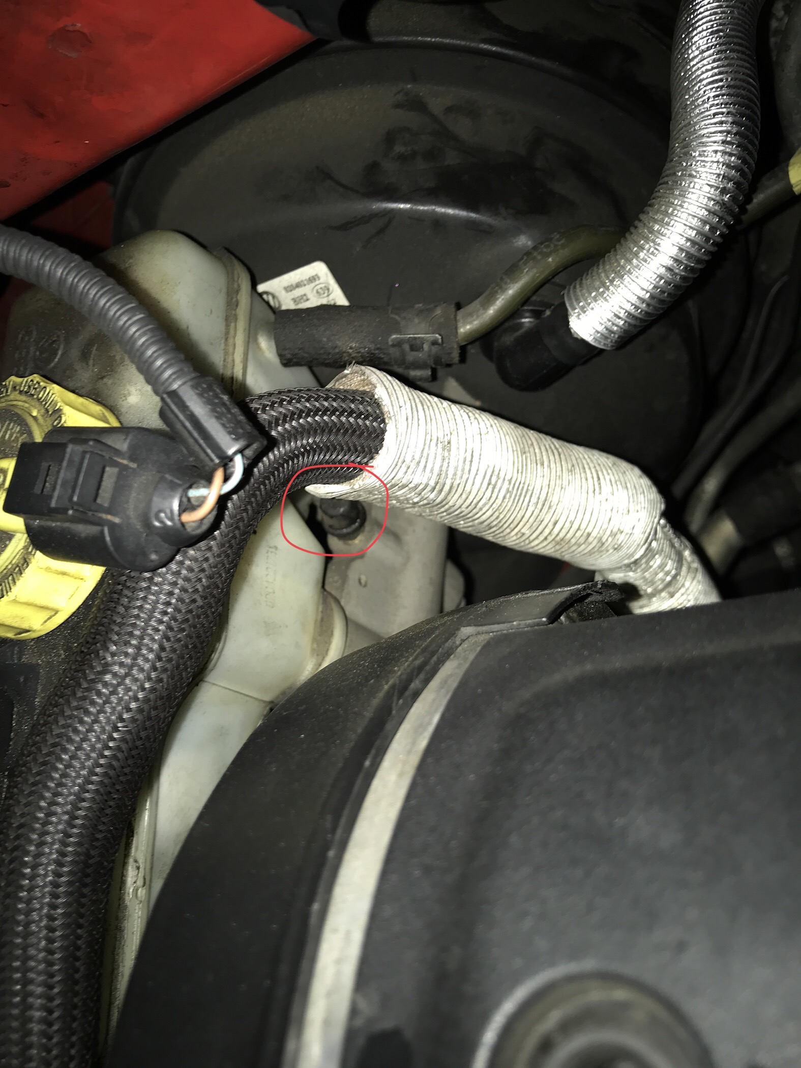

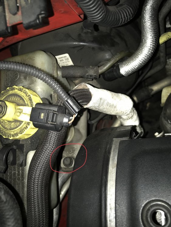

can you please post a picture with circled the bleed valves on the brake master cylinder?  Some of us are daft...

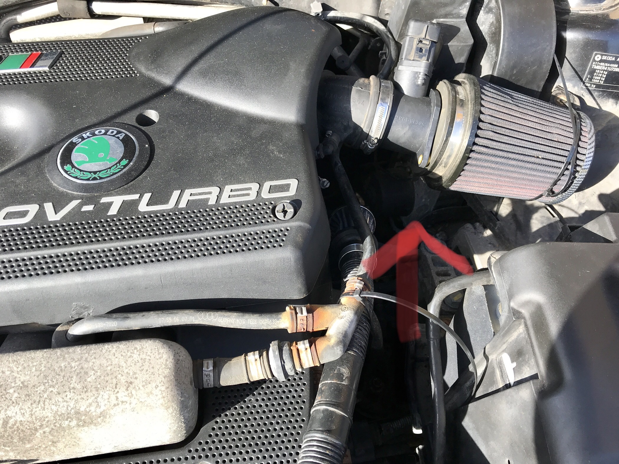

The top and bottom are the black rubber caps over he two bleed valves. The middle picture shows where they are located from a top view of the engine (if the plastic housing wasn’t there).
Both valves are are accessible without removing any engine components. Any problems just message me.
