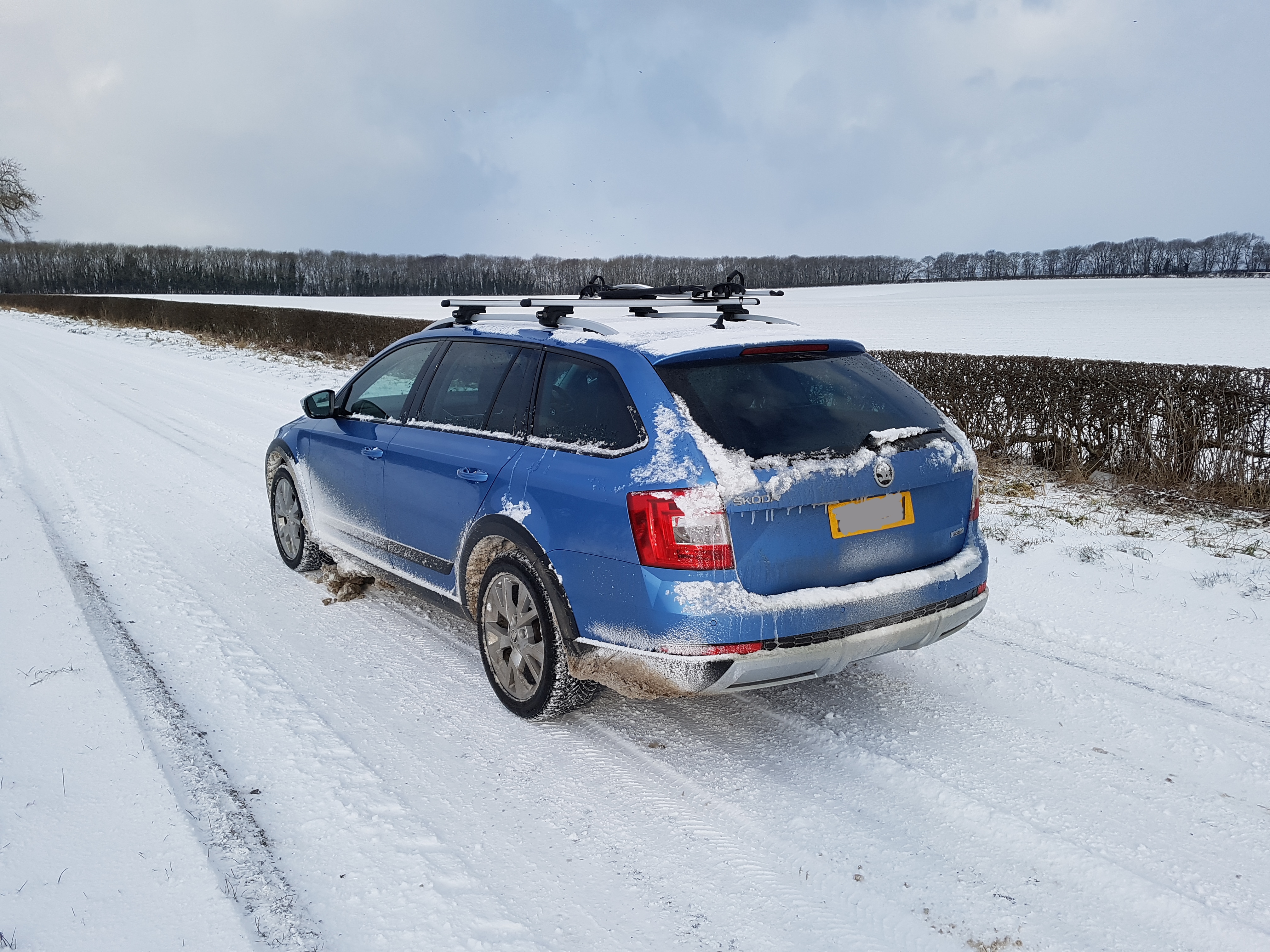

I fitted Continental TS 850’s (225/50/17)  to my 2015 Scout and they are easily the best I’ve ever had.  Way better than the Michelin  Alpins I had on my Passat. The grip is incredible. In the Alps last year in thick and falling snow the car stayed rock solid even round the hairpins.

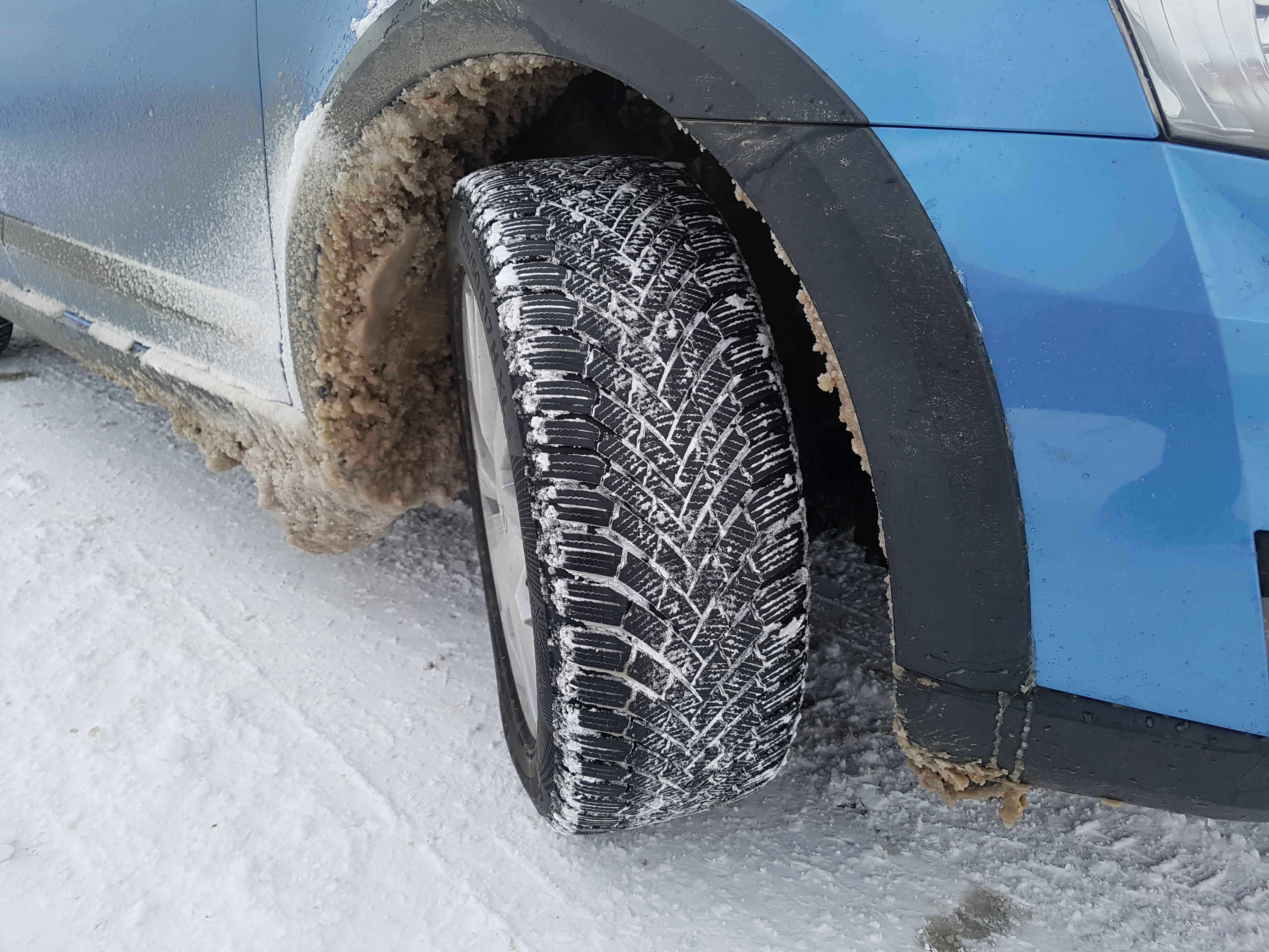

I'm running Continental TS 860 all round (obligatory pics of mine below :)).  They are the 2nd set I have run on a car and they are very good in my opinion.  In testing the Contis scored very well all round where as you sometimes find that some tyres excel in one area and do poorly in others.
Having driven the Contis in snow and ice they grip very well and braking is vastly better on the cold white stuff compared to normal tyres.  They also do very well in the wet and the car feels really shore footed.  The Nokian tyres you quote do get good reviews and were a consideration but opted for Contis as I had them previously.

My 2015 Scout fitted with Conti 850’s proved to be virtually unstoppable - we had some badly drifted up roads.  It just went through 18” drifts.  Basically if a Landrover could get through so could the Scout.  However I did discover how the AWD really works when I had to stop in a drift at the top of a hill due to a Mini in the ditch.  First attempt to get going again, car not keen to move as the Haldex was slow to react without prior wheel rotation.  Pressed the button to deactivate traction control as per book and the car came straight out as all 4 wheels had equal power- you could definitely feel the difference.
