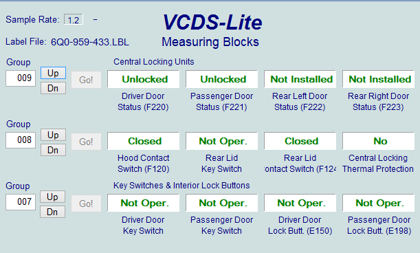

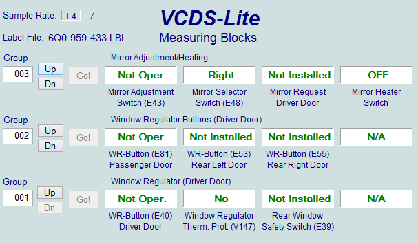

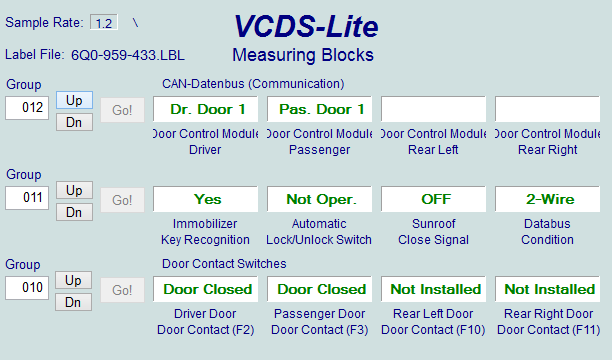

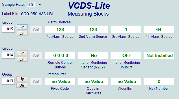

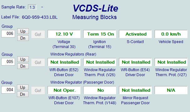

For what it's worth, here are the measuring blocks I can see on my (2-door) Polo:

So within the above are the various states of the door contacts, user door controls and other inputs.
So @RonBingley, it would be a good guide to log those measuring blocks or have a passenger monitor them to see what changes unexpectedly when the issue occurs.
