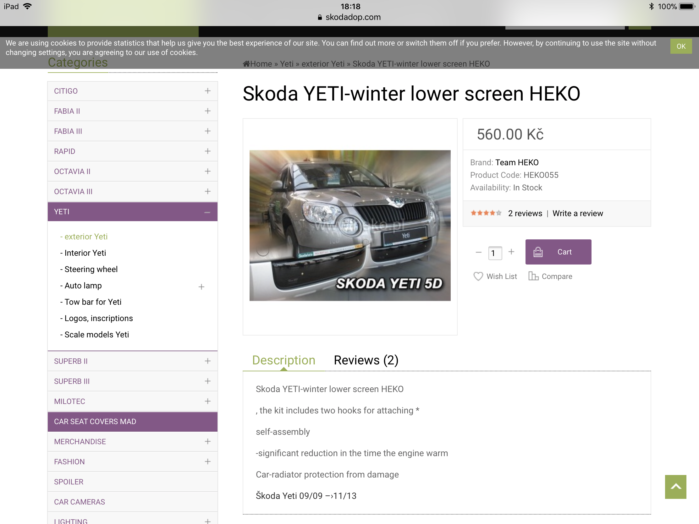

Out of interest, does anyone make a radiator blind for the Yeti?
There was one on the Eastern European market, but to be honest I cannot see what difference it would make over here. All they do is stop air blowing onto the radiator, and since the thermostat will stop water circulating to that until it is hot it can't make much difference.
