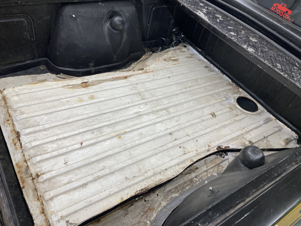

Any thoughts of a wooden floor ended abruptly when I spotted this on eBay.
I made the seller an offer, which was accepted sufficiently quickly to indicate it was too generous, and drove the Caddy up to Cambridge to collect it the following weekend. The seller had acquired this for his own Caddy project, but had decided he was unlikely ever to get around to it.

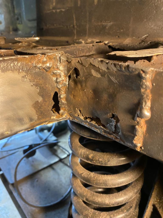

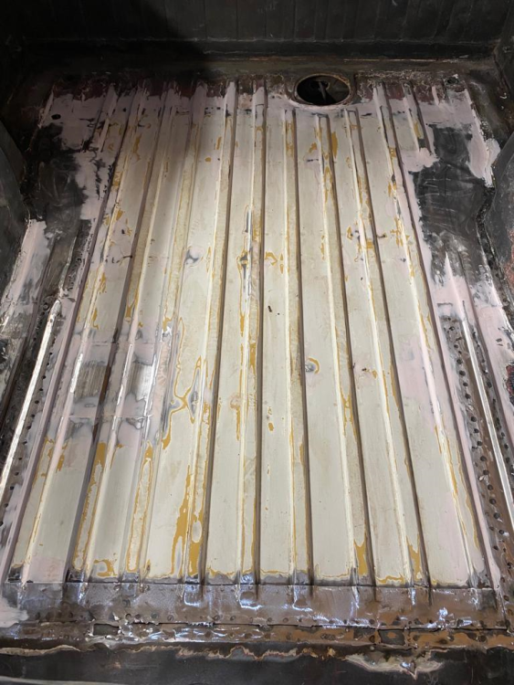

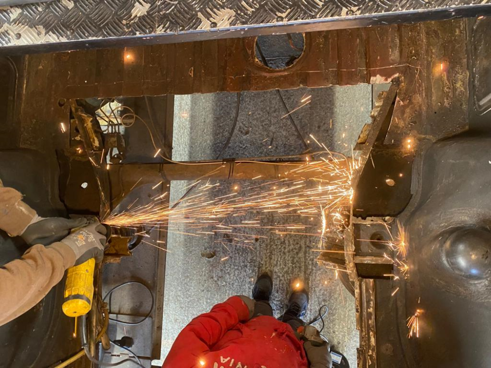

The fuel tank came out, and the serious surgery got underway.

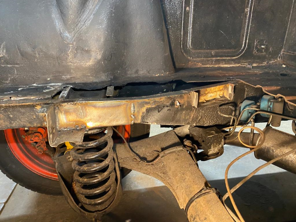

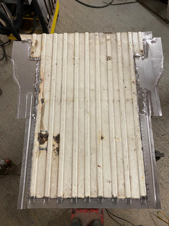

Unsurprisingly, cutting away the previous dodgy repairs revealed some nasties which warranted remedial action.
The replacement bed floor itself needed plenty of work before it was ready to be welded into place.

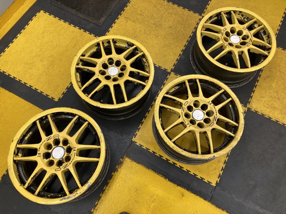

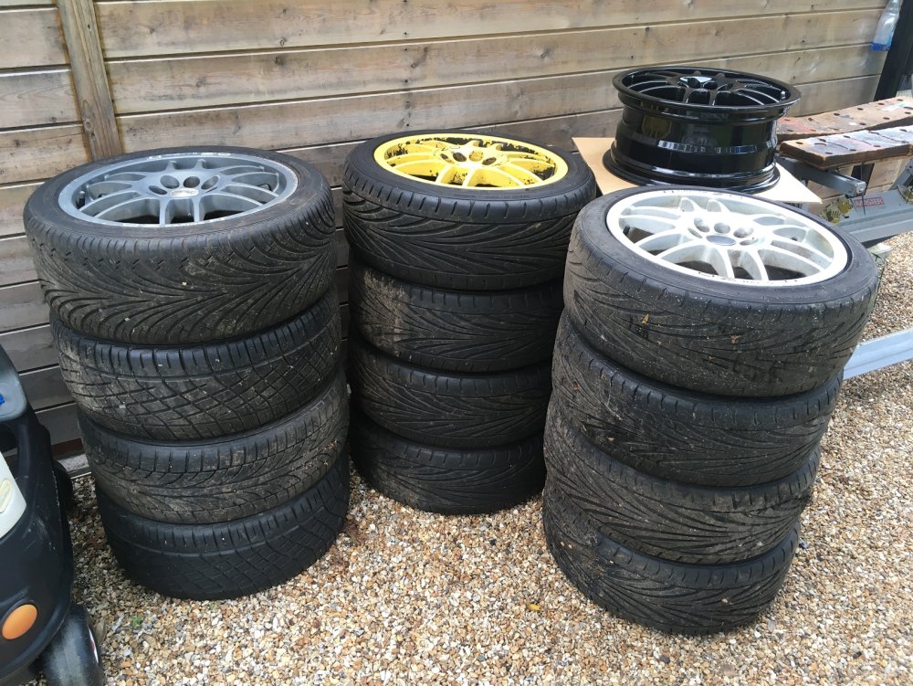

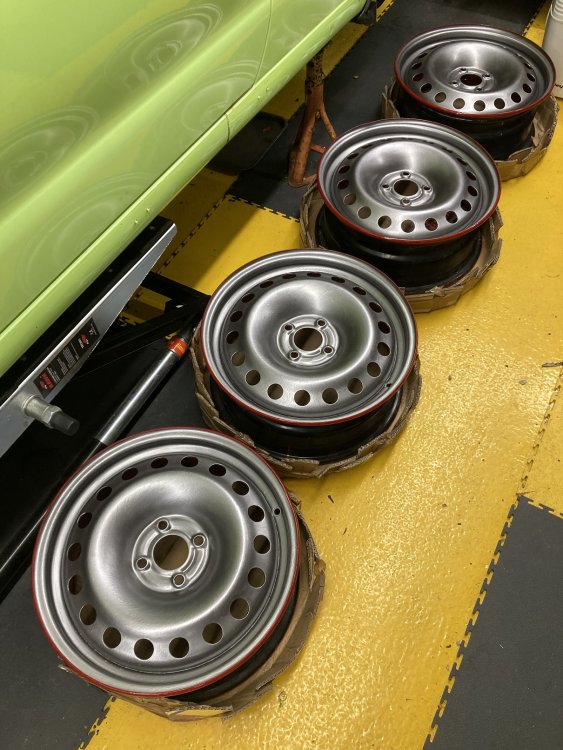

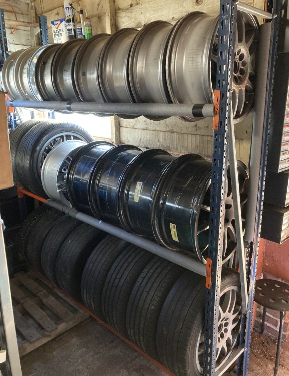

I own a lot of wheels. Even considering that I have three viable cars and the same number of projects, I have sufficient wheels that I have avoided keeping them all in the same place for fear that my partner might notice how many there are. Once I finally accepted I had thirteen Oz F-1s in 16” that I was unlikely ever to have a use for I reluctantly advertised them for sale.
Two sets (the grey and the silver ones in the picture) had tyres which were worn or perished or both, and I sold those quickly and cheaply to people who needed a different size of tyres anyway. The yellow ones had a decent set of Toyo T1-Rs on them so I wanted to see a better price, which was not forthcoming at the time. My solution to this would not be the obvious one to most people, because my plan was to buy another set of wheels.
I reasoned that if I found a set of 16” steel wheels for the Caddy, I could fit the Toyos to those, then sell the yellow Oz wheels without tyres, and also sell the black 15” steel wheels which are on the Caddy in earlier posts on this thread.
It took a while, but eventually I found a set of Renault Megane Scenic 16” steel wheels which are 4x100 PCD to suit the Caddy. I had been debating whether to paint them in the same grey as the bodywork, but instead I decided on VW LA7Y which is my favoured gunmetal shade for alloy wheels. I wanted to put a red pinstripe on them but I could not work out how to do this neatly until I noticed the lip on the rim. The backs and lips were painted in the same Hammerite ruby red I used on the fronts of the other 15” wheels, and finally after three coats the coverage of the gunmetal looked passable too.
Once the T1-Rs (in 205/45 R16) came off the Oz F-1s and onto these Renault wheels, the F-1s went back on eBay. Ironically, they sold for a price that I would happily have accepted for them previously complete with tyres. Happy days indeed.
The Renault wheels sat in a stack in the corner of the workshop for a while, but eventually I got them onto the Caddy. They look a bit more ‘scene’ than I was hoping, but I am pretty pleased with them nonetheless. This does now mean I have more Winter-oriented tyres on my 16” wheels and more Summer rubber on the 15” wheels, which is probably the wrong way round, but as part of the object of the exercise was to find a use for the good Toyo tyres this was unavoidable.
Meanwhile the black 15” steel wheels were also sold. Having rationalised my wheel collection by selling thirteen Oz F-1s and four steel wheels, I am still not exactly suffering from a wheel shortage!

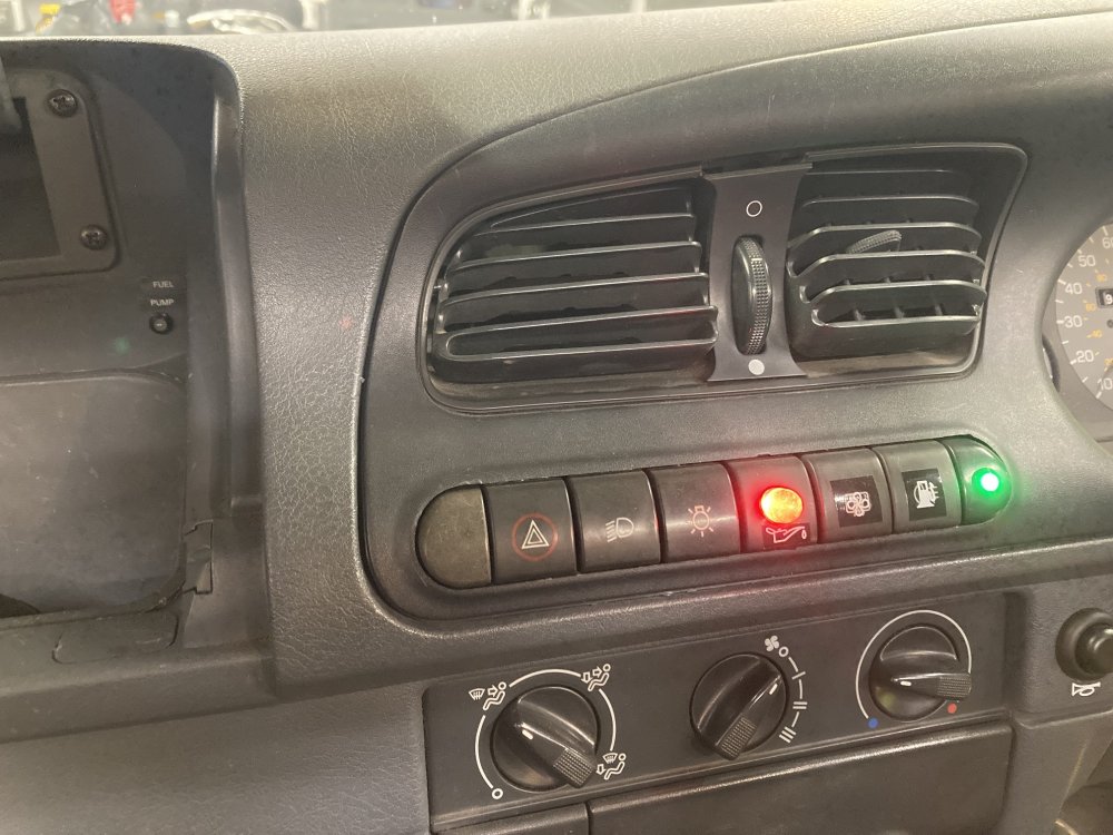

I had been chasing an intermittent fault on the Caddy for months. It would run perfectly, sometimes for ages, then it would lose power, often leading to the engine cutting-out altogether. Whether or not it would restart immediately was unpredictable too. My suspicion fell onto the fuel pump control circuit, and bypassing the fuel pump relay seemed to do the trick as a temporary fix for a while, but this also proved to be less than 100% effective. By this point I had decided there had to be two separate faults, unlikely though that seemed.
I made-up a couple of test leads with LEDs so I could observe the function of the fuel pump relay control circuit from the driver’s seat, and this convinced me that the ECU control output was intermittent. The ECU now fitted to the Caddy is itself a replacement which I bought relatively cheaply off eBay a few years ago, so I thought I could easily get another. When I looked I found that the going rate has more than doubled since I bought the last one, and I was not keen to pay £300, so another solution was required.
The ECU fuel pump control output is active for a short time when the ignition is switched on, then is deactivated until the ECU detects that the engine is running. Whilst the engine is running the fuel pump is energised constantly, then it is stopped once the engine stops, so that in the event of an accident which causes the engine to stop, the pump will not keep pumping petrol. This seems to me like a pretty desirable safety feature, so I wanted to retain this rather than simply install an override switch to keep the pump running whenever the ignition is on.
The obvious solution (to me, at least) was to use an oil pressure switch output to provide the signal to indicate when the engine has stopped running, combined with a simple override to give the initial burst prior to starting. The Caddy has two oil pressure switches fitted, with the additional one feeding an LED located in the row of switches below the central heater vents, so it was straightforward to connect this additionally to a relay circuit to control the fuel pump. The photo shows the revised layout of switches in the dash centre, with the fuel pump override tell-tale LED (green) at the far right, next to the associated switch. The big red LED is from the extra oil pressure switch which I also use to feed the fuel pump control circuit. Inside the glovebox you can see another (green) LED which indicates when the fuel pump relay is energised. I had wired this when I was fault-finding the circuit, and I decided to keep it. It is not illuminated in this picture because I also have a security cut-out switch which was activated when the photo was taken.
Having got a solution in place for the pump control circuit, attention now turned to the pump’s power supply. I identified a couple of connections I did not much like the look of, and rectified those, but still the problem persisted. Eventually I tested it with the fuel pump powered direct from the battery, but it still cut out. The pump itself looked like being the culprit, and as this was only a few months old it meant a trip to JKM who had supplied and fitted the Deatschwerks pump which had now failed. Apparently there have been a few recent instances of quality issues with these pumps, which is worrying as I have also installed one in my Ibiza. Jim swapped the failed pump for an APS unit, and after he had also found and repaired a dodgy connection it appears we have got this resolved.
After I got the Caddy home I tried running it without my tertiary pump control circuit connected, and it duly misbehaved again, which confirmed that the issue had not just been the fuel pump itself, and the ECU output was (and is) also intermittent.

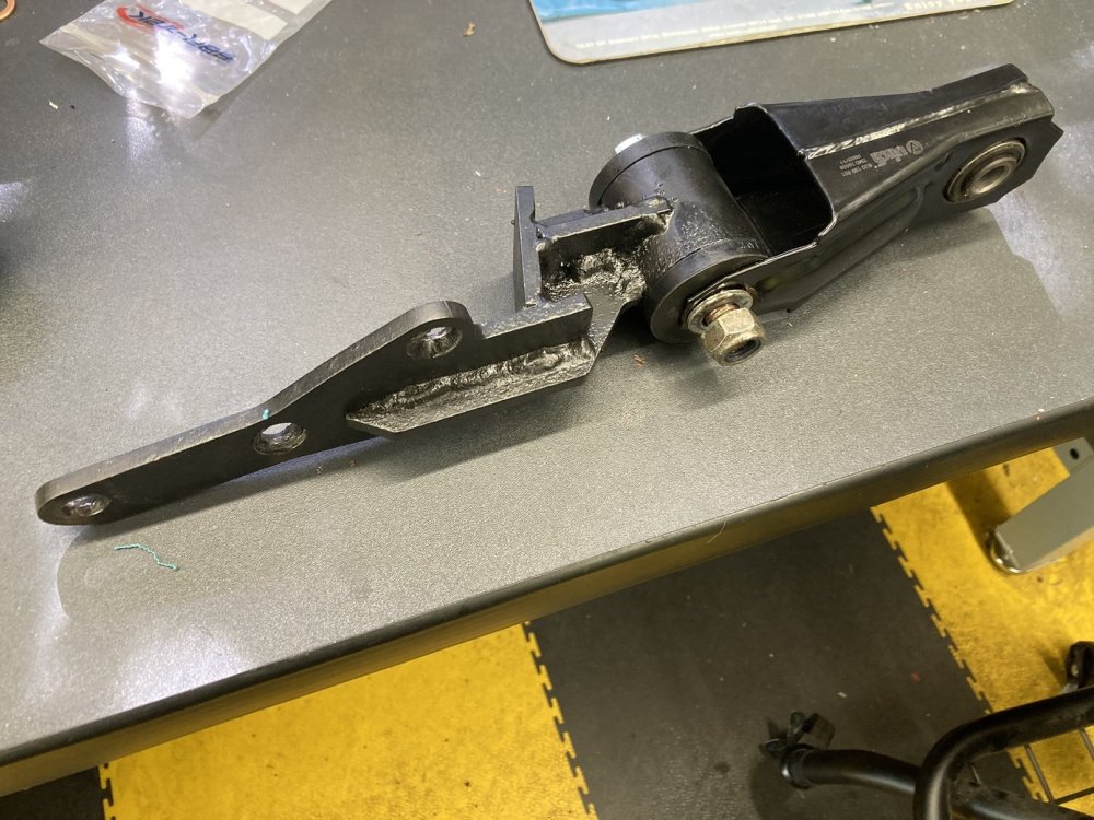

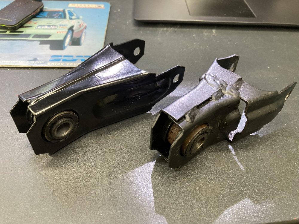

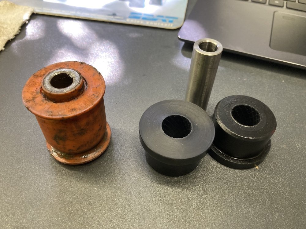

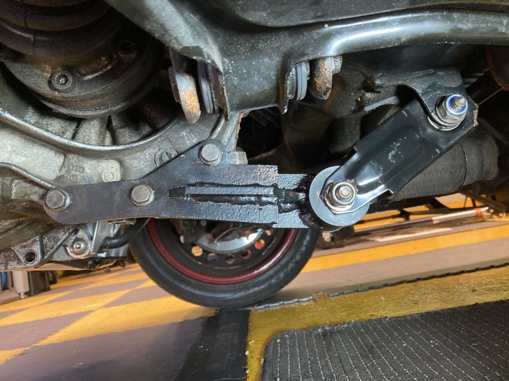

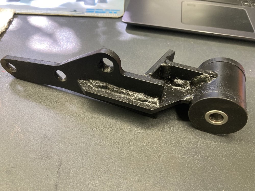

The engine mountings for the Caddy have never been brilliant. Either side it has Vibra-Technics mounts which I believe to be mk4 Golf parts, and they are fine, but the third mounting has always been a bit ineffective, and it had apparently been deteriorating. When the transplant was originally done, into the Felicia, a custom rear mounting was fabricated. This bolts onto the bottom edge of the bellhousing and to a modified Felicia subframe mounting through what was described as a Mazda MX-5 track control arm bush. This bush is the orange one in the picture, and was under suspicion as it was looking tired and there was a definite clunking noise from the rear of the engine under torque. I ordered a replacement Powerflex bush, but then when I had the mounting off the Caddy it was clear that the new bush was not the right part. Nonetheless I pressed the worn bush out of the mounting, and once I had cleaned it up I could see markings saying Polybush and 27C. This confirmed it as an MX-5 front lower wishbone rear bush, so the corresponding Powerflex replacement was ordered.
After the bracket had been given a lick of paint and the new bush was pressed into place, the front half of the mounting was looking in much better shape.
The rear half of the mounting was a modified Felicia part, which had been cut and re-welded to leave it shorter than standard. I assume this was done to make the two halves of the mounting line-up straighter when fitted. I tried and failed to source a replacement bush to fit the modified bracket, so instead I bought the whole thing. I reasoned that I would fit the standard length part to see how it looked, and I would shorten it only if I could see for myself that it needed doing.
All assembled and ready to bolt into place.
It was much easier to line-up all the bolts to fit the re-bushed mounting than it ever had been to do so for the shorter version, but whether that is a good thing I am not sure. One issue I spotted when I fitted it was that that rearmost bolt, through the mounting on the subframe, was not metric. This meant that it was not as snug a fit as it should be. I found a metric bolt to replace it and it felt much more solid than it had.
The road test convinced me that the engine mounting is now in a much better state than it was before.

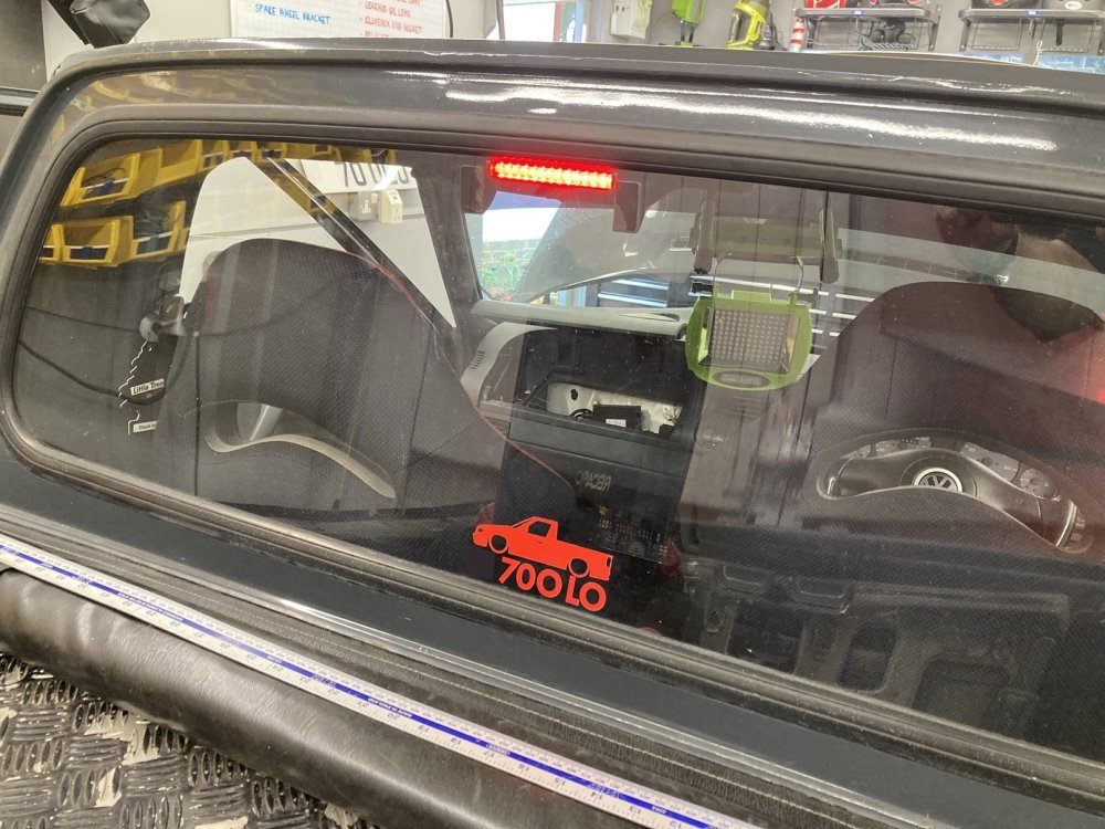

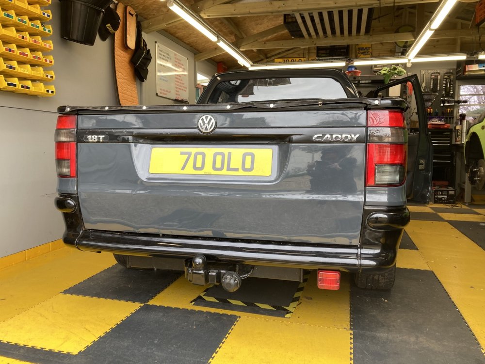

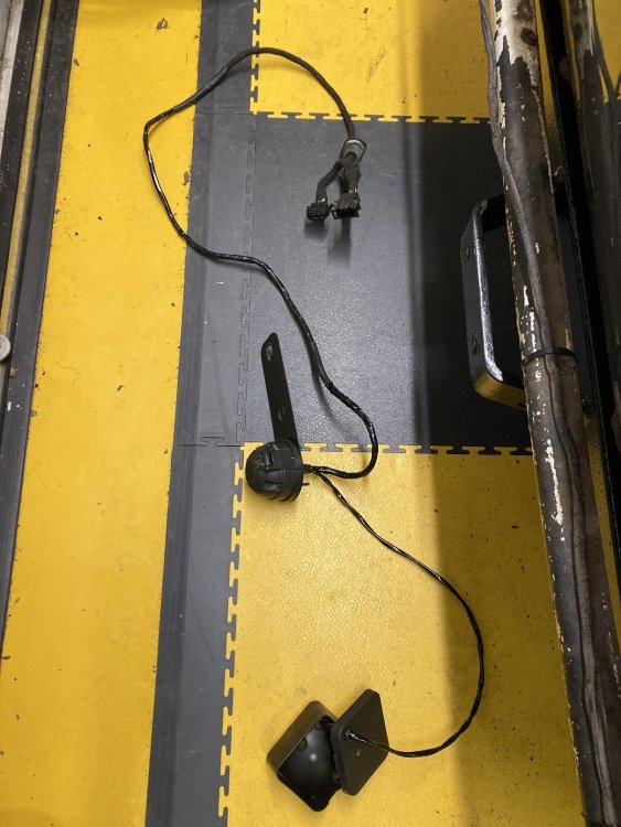

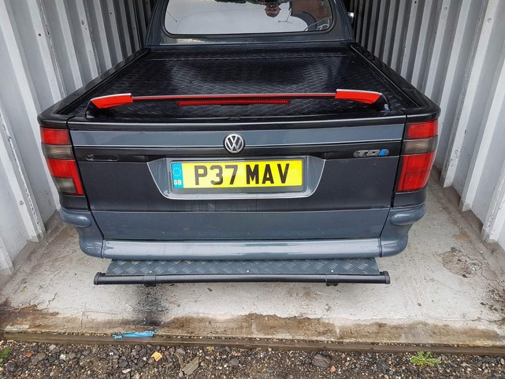

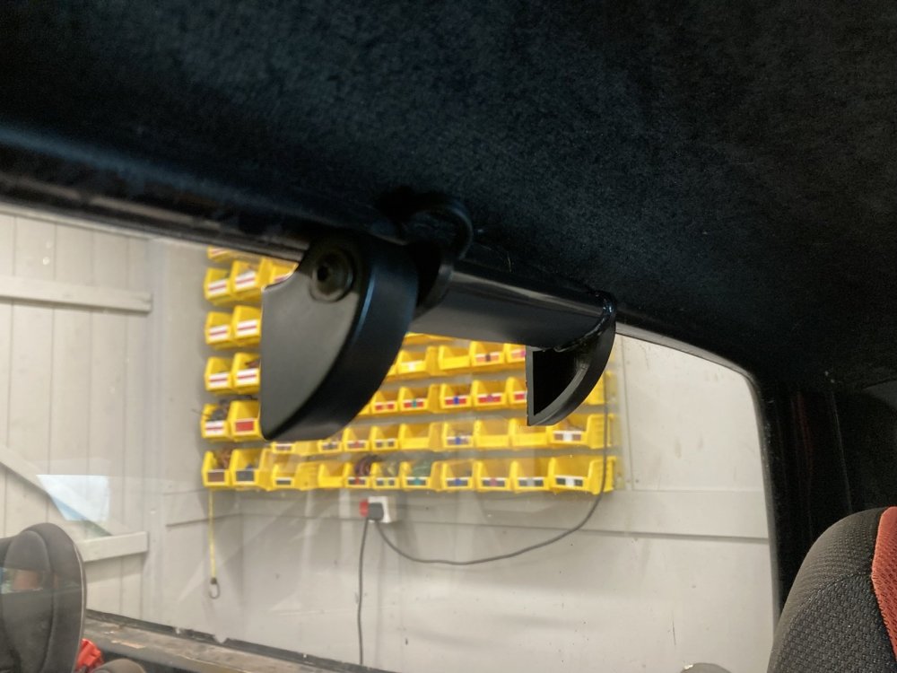

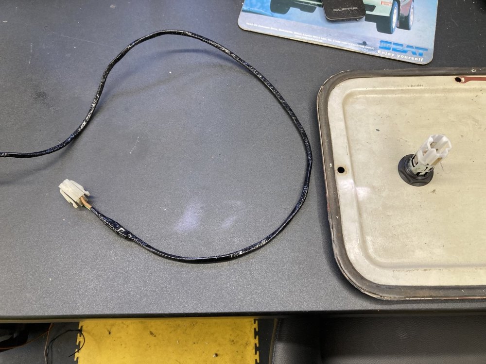

I have obviously made modifications to the Caddy to enhance its performance, and others to change the aesthetics, but I am struggling to think of one previously that has specifically been made with road safety in mind, although I have an example now. I think it is also the first instance of my reinstating a modification that had been in place when I bought the Caddy and which I had subsequently removed. My son had been driving behind the Caddy and told me afterwards that the brake lights were not as noticeable as they ought to be, in the absence of a high level centre brake light. Given that he knows that the Caddy has no centre brake light and was therefore conscious to keep an eye out, this made me think that less switched-on drivers could miss my braking altogether, with disastrous consequences.

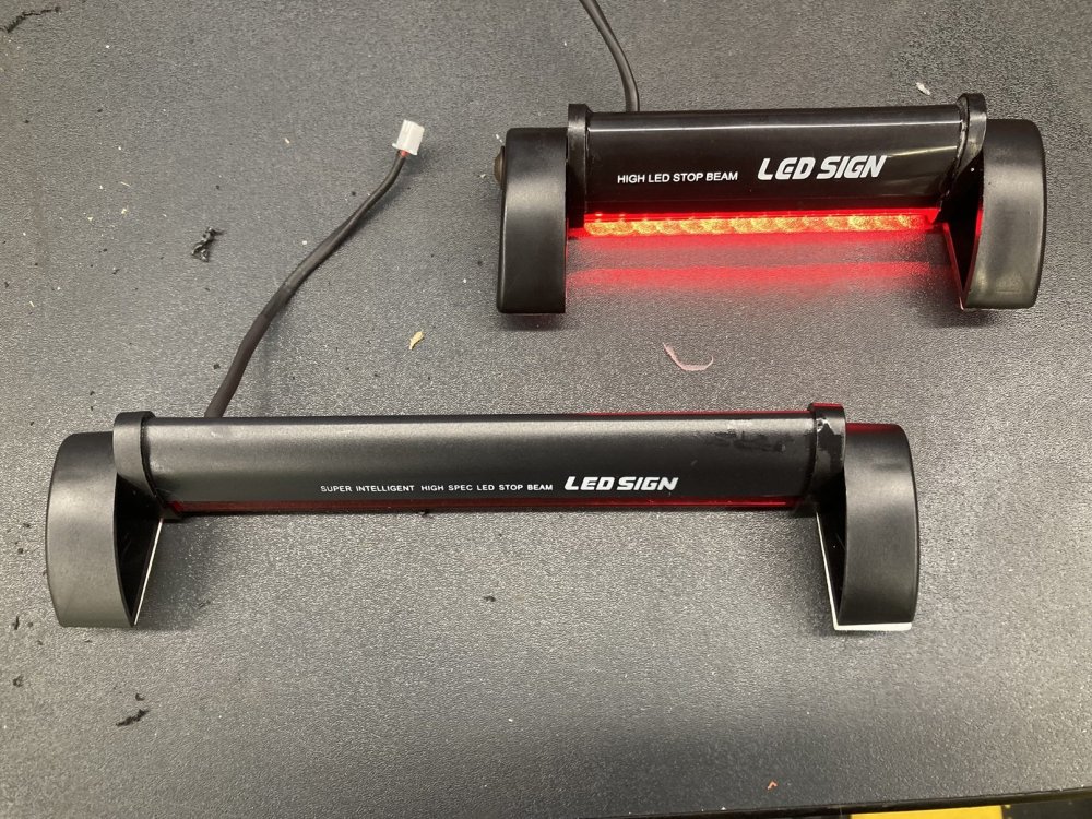

I liked the idea of mounting a brake light externally above the rear window, except that would mean drilling holes in the cab back, which I did not fancy much. I thought it would be much easier to find a universal brake light to stick inside the rear window, but actually it took me a while to find one, and I was not happy with the quality of the best one I could find. After deciding I did not want to use it, I spent a few more weeks scouring kit car parts sites and the like to try to find a better part. The problem was that so-called ‘universal’ internal brake lights are designed to fit to the sloping rear windows of cars rather than the practically vertical rear window on a pick-up. Eventually I found another brake light capable of swivelling on its mountings to accommodate mounting on windows of different inclinations, and which appeared online to be higher quality than the first light I bought. When the second one arrived it proved to be just a shorter version of the first, so that was a set-back.
At this point I resigned myself to not being able to find a better part to use, and decided to try to adapt the ones I had already bought. There were three features of the brake lights which I was unhappy with: the cable was routed through the rotating mounting, so the mounting could not be moved to the required position without pinching it; the case and swivel mechanism were horribly flimsy; and the open design meant that light could leak out all over the place, which I thought could be distracting when driving. As well as this, the longer light had three LEDs which lit only intermittently, and whichever one I chose would need a 2-pin connector fitted to it.
Taking the two lights apart was easily accomplished, which is an obvious advantage of the flimsy construction. The fault with the LEDs was due to the lead on a resistor not having been trimmed after it was soldered, so that it was shorting across the PCB. With the lights disassembled it was straightforward to pull the cable back through the hole in the mounting and feed it through a new hole drilled in the body of the light. After that I made the lights a bit more robust by drilling the ends for bigger flanged screws to replace the tiny countersunk ones they had originally. When I took the picture below I thought I had them finished, but subsequently I took the smaller light apart again and added some black tape along the sides of the light lens, and some similar tape over the ridiculous lettering on the side.
Adding the wiring for the brake light was simply a case of taking the passenger interior sill trim off and splicing into the loom between the B-pillar and the grommet it passes through towards the rear. The new wires were run up behind the B-pillar trim panels and then fed between the headlining and the roof using a straightened wire coathanger.
By this point I still had not decided which of the brake lights I should use. From an aesthetic perspective I preferred the smaller one, so I tried that one first to judge if it was big enough to be sufficiently visible. For the purpose of this check I attached the light to the rear window with masking tape. My initial impression was that it was fine, but before I committed I left it overnight to see if I felt the same way the following day, which I did, so the light was fixed properly with double-sided sticky pads.
I would like to think that my new brake light installation is a tad more tasteful than what it had when I bought it.
Edited by Bete Noir
More than just "a tad" IMO. It's also way less likely to get broken when loading or unloading the bed.
Thanks. To be fair, the spoiler was attached to a rigid load cover which was hinged at the front, so it was out of the way when loading. It was actually like a really big handle to lift the load cover 🙂

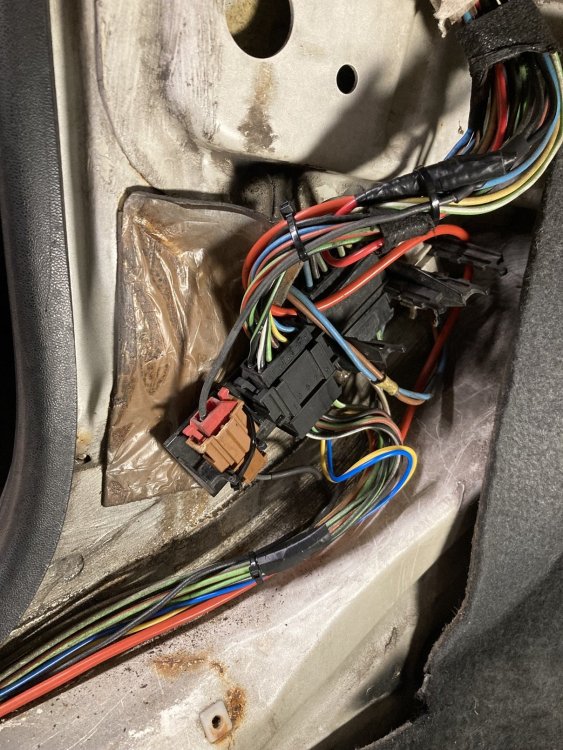

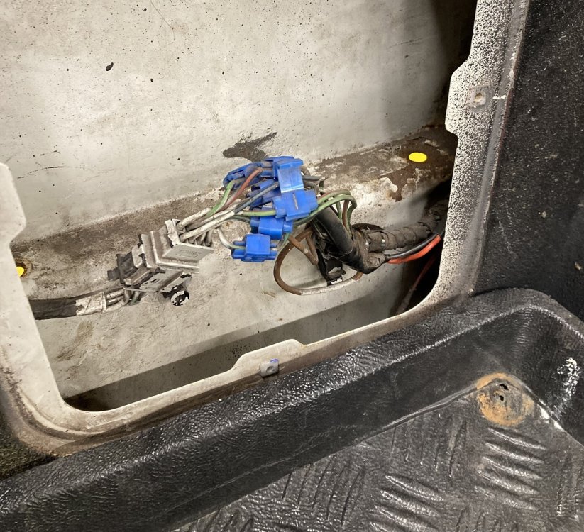

Having the sill trim off to do the wiring for the centre brake light presented a perfect opportunity to tick another job off the to do list which had been on there a long while, which was fitting a 12v socket in the load area. I removed the nearside front side access panel and cut a hole in it for the socket to fit into, then made up a new section of loom to connect to it.
My Caddy has a non-standard earth connection at the base of the passenger side B-pillar, so I bolted the socket’s earth lead to that. The socket has a connection for illumination, so I connected that into the sidelight circuit, even though I cannot see why I would ever need it to be illuminated. The wire from the positive terminal was run along the top of the sill towards the fusebox, but when I got the kick panel off I spotted a 2-pin socket (the red one in the photo below) with a black wire in it, and no plug attached. I decided to investigate where this black wire is connected in the fusebox. It turns-out this is connected to fuse S15 which makes it perfect as a supply for my new load area 12v socket, so the wire from the socket was quickly fitted into a plug (the brown one) and the two were mated together. That was much easier than I thought it might be!

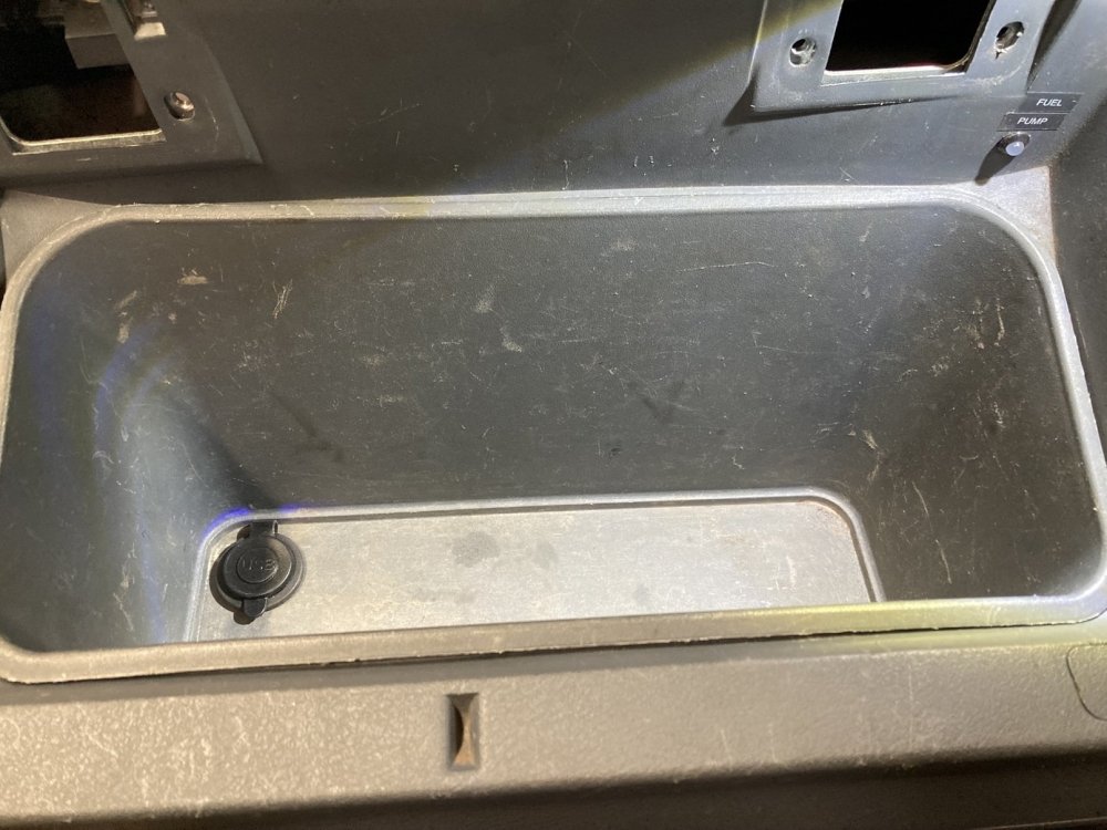

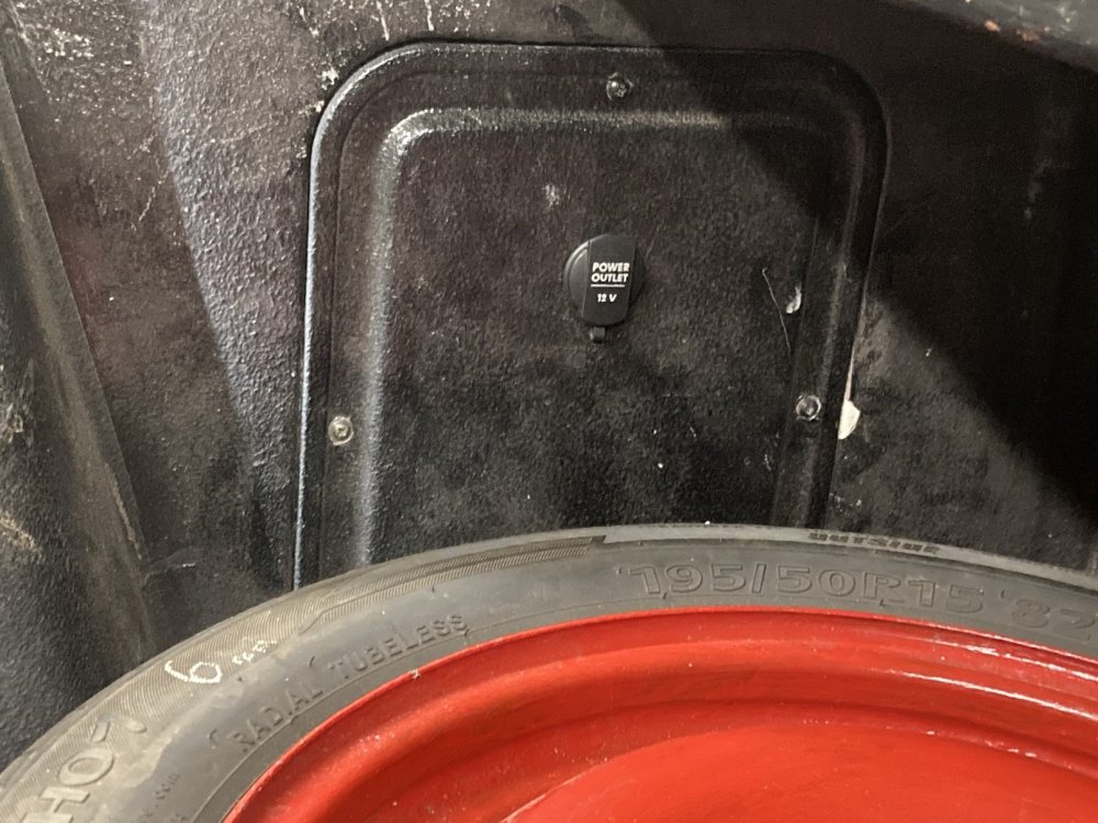

Hardly worthy of a picture, but the socket in the load area looks to me like it belongs there.
Whilst I was playing around with the 12v supply for the load area socket, I also added a USB socket in the bottom of the glovebox. This will be ideal for plugging-in the satnav, rather than using the cigarette lighter socket which puts the satnav cable sufficiently close to the gearstick that I have pulled the satnav off the dashtop more than once when changing gear.

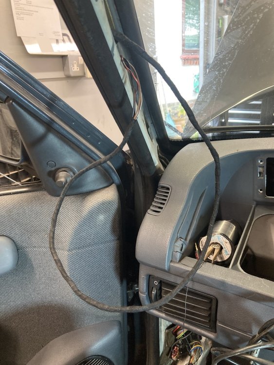

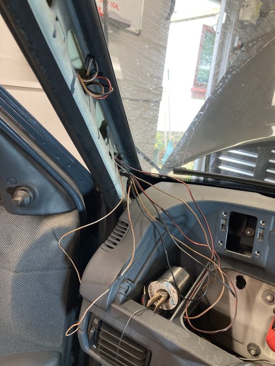

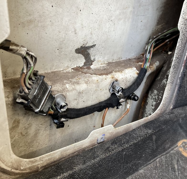

In the midst of tidying the load area top ‘hockey stick’ trims, I sat in the Caddy and noticed that the interior light was not working. Anyone who has read this thread all the way through will be aware that I like nothing better than sorting an electrical fault, and it had to be a simple fix, maybe even just a bulb, so I decided to sort it out. Little did I know what I was getting into.
First I tried the easiest and most obvious fix, and replaced the bulb. There was already an LED bulb fitted, but I tried a different one. It made no difference.
The next step was to take the interior light out and test it on the bench. It still refused to illuminate, so I dismantled it and cleaned all of the copper contact surfaces. After that it burst obediently into life (well light, at least) on the bench. When I then re-connected the light in the Caddy, it worked fine on the ‘manual’ setting, but remained defiantly dark when switched to operation via the door contact switches. I removed the light again and replaced it with a test LED, which was illuminating only dimly when the passenger door was open. This suggested that there was a high impedance connection between the door switches and the interior light, which was not great news. I had only just replaced the passenger side sill trim and kick panel, but I had to take them off again to access the wiring at the base of the A-pillar. A quick test at the connector there confirmed that the connection to the door switch was good, and the issue was between there and the light. I got into the loom behind the glovebox, located the wire from the door contact switches towards the interior light, and cut it at a junction where the blue wire from the A-pillar connector was crimped to a brown/white wire. The core of the brown/white wire was in a terrible state, and was a likely culprit for causing the fault. As this wire is run inside the windscreen pillar, and is wrapped within the loom of four wires going to the light this was further bad news, and I spent a while working-out how to remedy it.
My solution was to take all of the slack out of this loom in the roof and behind the glovebox, so that I had enough slack within the windscreen pillar to pull a loop out through one of the holes in the pillar. Once I had removed the wrapping tape from this section of loom, which was very easy as it had deteriorated due to its age, I cut all four wires and soldered a new length of about 500mm between each of the cut sections. I staggered the cuts so that the solder joins would not make the loom significantly thicker in one place. At this point it did not look great.
I was able to wrap the new section of loom and the unwrapped sections of the existing loom with coroplast tape to tidy and protect it.
With this done, I could pull the loom through from behind the glovebox, so that the new section was inside the windscreen pillar, and the original section, including the damaged brown / white wire, was now accessible behind the glovebox. I could now cut out the damaged section and cut the other cables to length before re-soldering them to reinstate the circuit, but if I am repairing something I always like to upgrade it if I can, and I had already decided that this was an opportunity to do that.

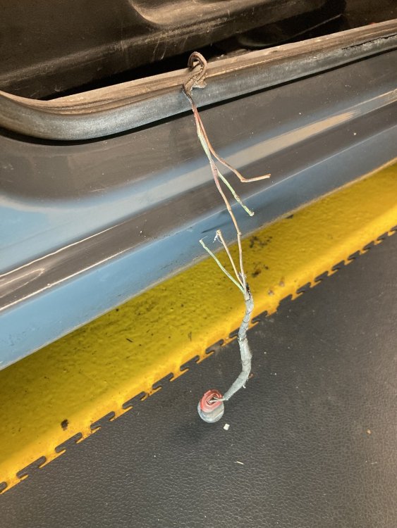

This was the state of the wiring from the driver’s door switch. The loom had not been routed correctly, and had most likely found its way into the seat runner and been sliced by the movement of the seat. Whether or not it had happened like that, two of the three wires were completely severed. This was not particularly disheartening, as all that was needed was to cut the damaged sections of wire out and solder new ones in. The core of the brown/white wire at the cut did not look good, so I cut it back a few inches to find some good copper, and I kept doing so as each cut failed to reveal anything I could solder to. Eventually I got to this point.
I had to cut the wire back all the way to the passenger side sill before I found good copper, so the new wires I soldered in were somewhat longer than I had expected. Once these new sections were in place the circuit tested successfully, so I re-wrapped the loom across beneath the seats, and clipped it into its proper place.

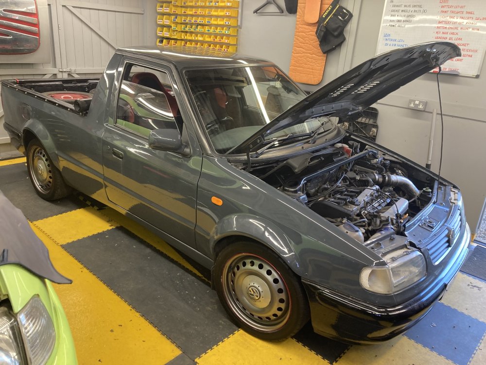

It has been a long time since I have updated this thread. My Caddy has not been forgotten, but it has largely been abandoned in favour of my Ibiza project (the SEAT variety, not a Balearic housing development). The Ibiza is now finally MOTed and in use, so I can turn some attention back to the Caddy.
The pick-up has been enjoying the comforts of my garage workshop for a while because it is far from watertight. If it is parked out in the rain, both the passenger side footwell and the rear load bed fill with water. The windscreen seal is the obvious suspect for the wet carpet in the cab, on which more later, but the route for the water to get into the back was less obvious, given that it is rarely left without the tonneau cover in place. Suspicion fell on the front corners of the load area, where the ‘hockey stick’ top trims had been cut to finish more or less level with the cab back rather than extending across the B-pillar as standard. This appeared to have left a route for the water to get past the end of the trims and into the back, which warranted further investigation.

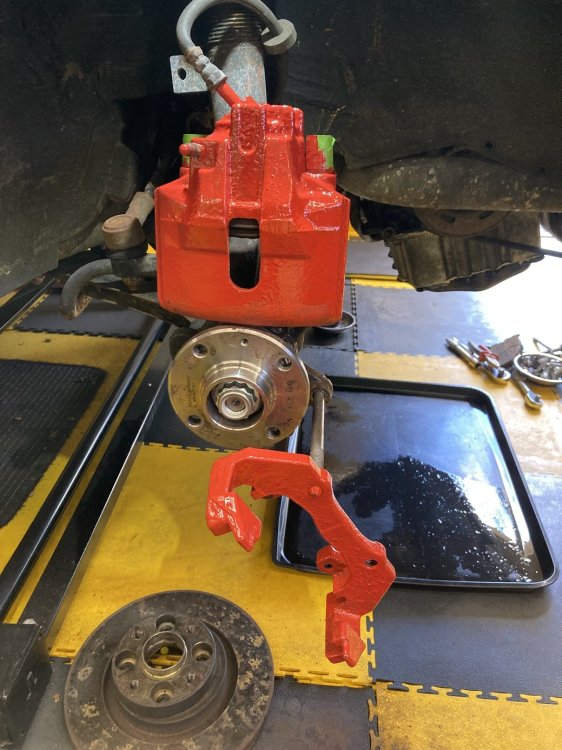

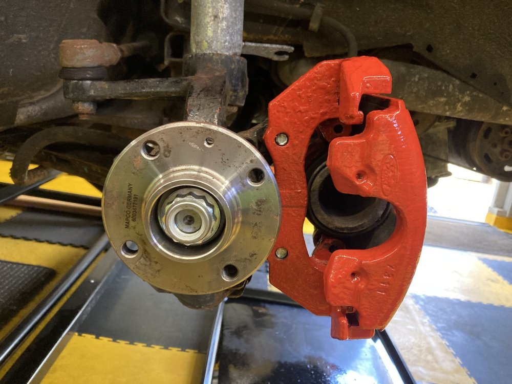

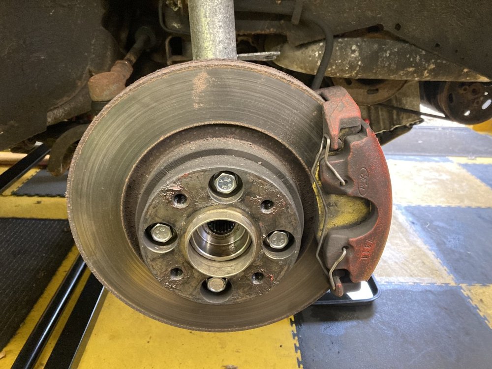

The brakes were looking shabby, and the discs had been mentioned in the advisories at the Caddy’s last MOT. Obviously this did not compel me to do anything to them before it goes for its next test, but I do not believe in taking chances with brakes. When I swapped the uprated brakes from the Felicia onto which they were fitted previously, the only new parts I had bought were the pads, which meant that I was not even 100% sure what the front discs were from. I have read of people fitting Hyundai Lantra discs, so I was pleased to read that my Caddy has ‘Golf G60’ discs. This means they are the same as would have originally been fitted to my mk2 Ibizas. The front callipers are Ford Mondeo parts, but pretty specific Mondeo parts so I had to remind myself of those details too.
I ordered the bits then set-to removing the old discs and pads, and giving the callipers a clean then a couple of coats of red paint. The pads I took out were EBC Yellowstuff, which were fine in terms of all aspects of their performance, except that they seemed to generate a lot of dust.

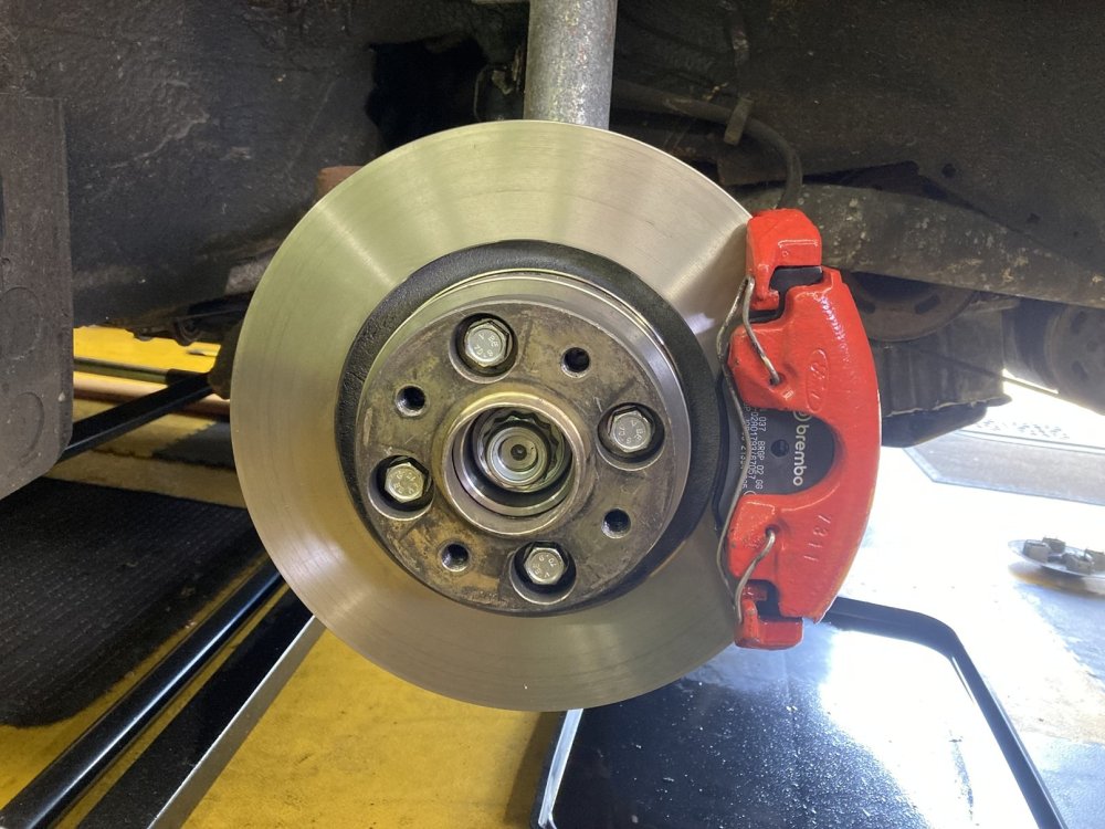

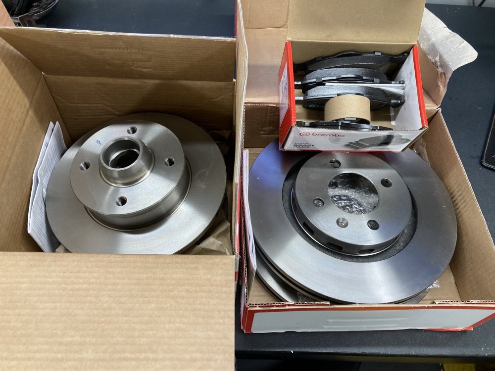

The new parts I chose were all Brembo. The Caddy does not go on track or even get driven particularly hard on the road, so there is no need for more expensive discs or pads, especially as the Ibiza GTi discs all round are a significant upgrade on the standard Caddy brakes.
New brakes always look so nice. What a pity they do not stay looking like this for very long.
The brake hoses have not been touched yet, because when I looked at the unions with the brake pipes they did not look good. I do not trust myself to do a good job making replacement brake pipes, so I will entrust that job to JKM when it goes there for its MOT.
