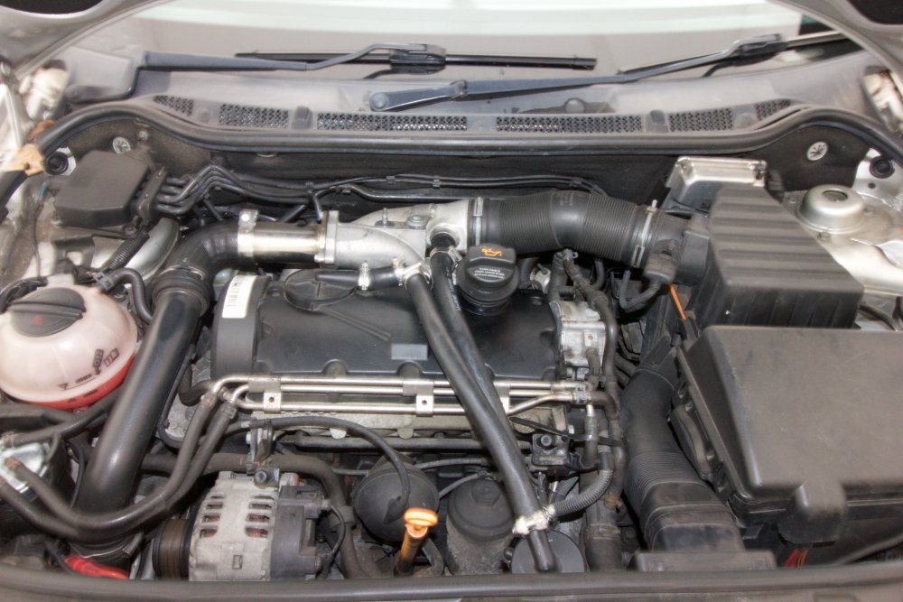

Jars's picture suggests otherwise to my eyes. Camcover to catch can, catch can to air intake post-MAF, pre-turbo?
Yes the breather does go into the intake pre turbo
Jesus, what a retarded design, most diesels go into the plenum which is why that gets so gunked up. I can't believe it, as soon as the oil mist hits the intercooler it condenses and fills the base like a sump. That's so dumb.

For optimal crankcase pressure - a tad below atmospheric -  I think the place it feeds in makes functional good sense on a turbocharged car. Just need to drain the oil from the intercooler from time to time on an older car, or fit a catch can; or kill the odd motorcyclist by routing it onto the road...
